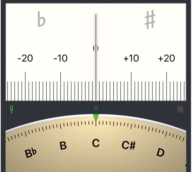

I have have a folder of apps I've downloaded over the years and spent a bit of time comparing them to a bunch of tuners I have. Of the tuners hanging around, I looked a polytune pedal, an over priced peterson clip-on that claimed 0.1 cent accuracy, a korg with 1/4" aux or wired clip-on and a d'addario soundhole one. By far the polytune and korg aux'd were the most accurate and consistent with each other, followed by the d'addario soundhole tuner. The korg clip-on got better if I clipped the sound hole rather than the headstock, which may explain the d'addaro.
The best of the app was Cleartune which was consistent with the aux'd tuners and is easy to read the cents especially in landscape. Although AP Tuner was close. I also dislike the strobe a bit as I find it harder to ignore/truncate the attack and decay when Im watch it (but that may be a me problem rather than the app's).
Screenshot 2024-05-24 at 3.10.28 AM.png (196.26 KiB) Viewed 29340 times
https://apps.apple.com/au/app/cleartune/id286799607
