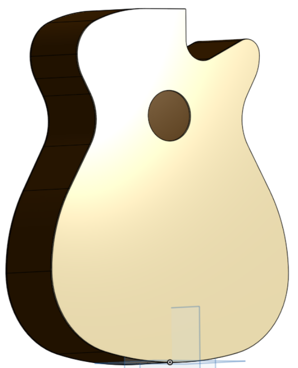

So here's a fun experiment. I modeled a Gore Medium steel-string in CAD. Well, just the body so far.

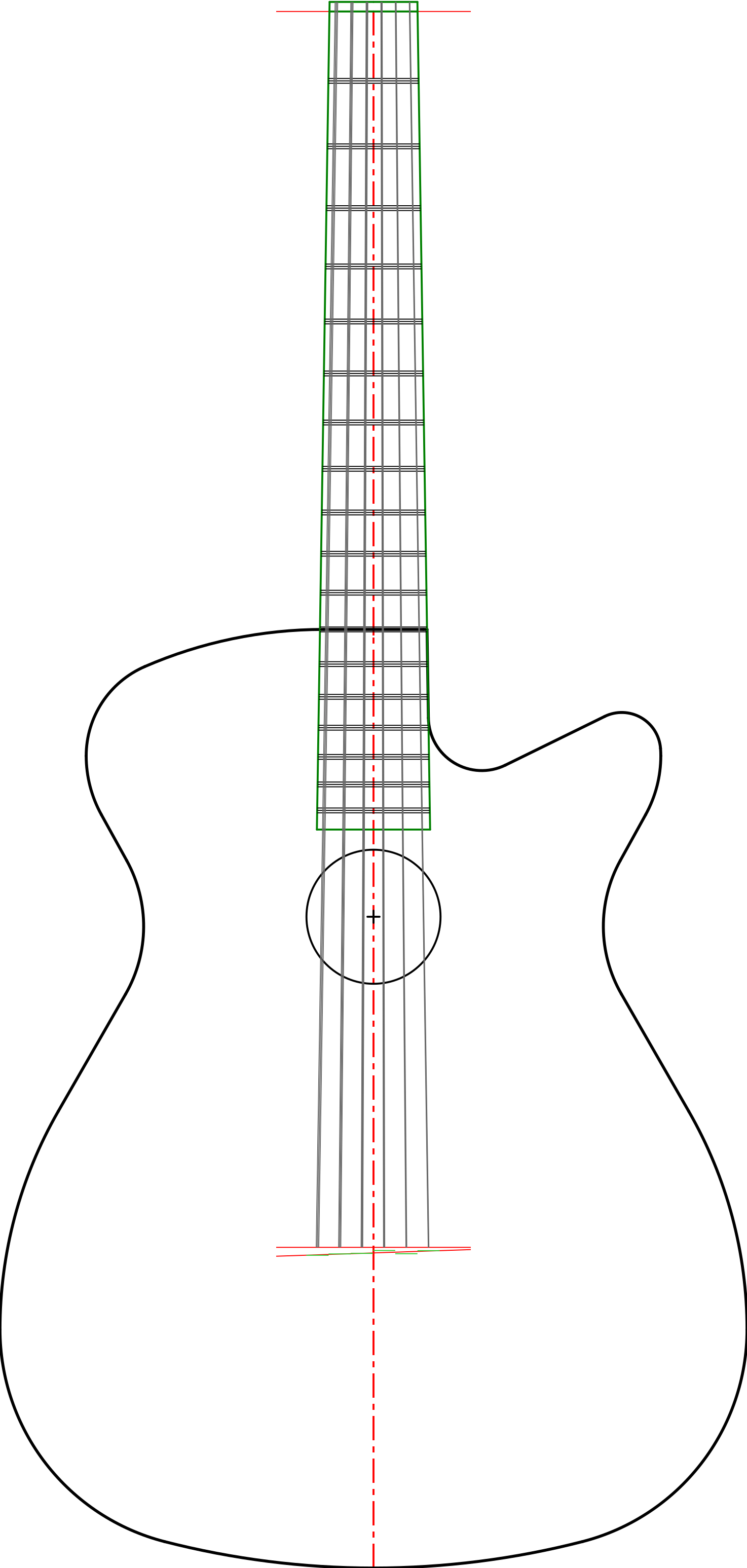

Here's how I did it. First, I used R.M. Mottola's very useful "G" Thang tool to draw the outline. I used the printed Drawing No. 4 from the book, and visually tried to find the radii and centers of the curves in the drawing. I think I came pretty close.
Here's the gthang file if you want to load it into G Thang and edit it.
I then used the OnShape.com CAD tool. This is free to use, but your documents will be public. Much like Google docs, this runs in your web browser and documents get automatically saved on their machines.
I exported a DXF file from G Thang and imported it into OnShape. This is just a flat 2D outline of the guitar. After some fix-up of the outline, I was able to build some 3D objects: an arched top, and arched back, and sides connecting them. I made the top and back parallel, since I'm new to CAD and don't know how to do anything else! I spaced them to give 110 mm outside dimension. I also created a 3D object that fills the cavity inside the box. I did not include the linings, head block, or tail block.
Screenshot from 2024-04-25 20-33-13.png (101.08 KiB) Viewed 34671 times
Here's a link to the CAD project. You can copy the project and edit it for yourself.
