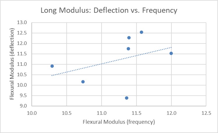

I’ve been testing all my top and bracewood to find the best combination of stiffness and density, optimize plate thickness, etc. I started using the frequency-based method from the Gore books, but since I was also testing deflection, I decided to compare the flexural modulus using that method (also with the formula from the Gore books) on the same top plates and bracewood.
Unfortunately, I’m having trouble getting a satisfactory correlation between the two methods. Here’s a plot comparing the longitudinal stiffness calculations using the 2 methods on 8 sonically tested tops from PRT. Since they don’t agree very well, I’m left with the dilemma of deciding which calculation to use to determine top thickness. Am I overlooking something? Has anyone else done a similar comparison with better results?

Re: Frequency vs. Deflection for Measuring Flexural Modulus
Without looking into it in detail I'd hazard a guess that with the flexure test the testing procedure itself introduces some variability in results....more so than for frequency tap tests.
Not Trevor, he'll have a better answer for sure.
I used to statically test my tops/braces before Trevor's book came out. So its been quite a while since I've done it, but I do recall comparing the test to one another when I built my spreadsheet. As I recall the dynamic test (Ala Gore) came out slightly higher than the static test which was expected as dynamic test typically give a higher modulus value. But, the test were consistent and not radically different, so I was happy. I've continued with the dynamic testing as it's faster and his books are set up for it.
Also, you can definitely preload the top lightly which helps and don't go crazy on the amount of weight used to deflect the top.
It is possible to get comparative results, but you have to be very careful about how you do it.
The problem with the static test is that the longer you leave the load on, the greater the deflection you get, due to the visco-elastic behaviour of wood, leaving you with a decision as to when to take the reading. As others have said, if the panel is not exactly flat or exactly rectangular, you also introduce some errors. Really, the only reason to use the deflection method is if there is no other way of estimating the elastic moduli, e.g. on irregular shaped panels when only a small section can be made rectangular (panels with corners missing , etc..)
Without doubt the best way is to use dynamic testing, which automatically tests deflection in both directions as it vibrates, and most closely represents the way a guitar works to produce sound (i.e. it vibrates and the frequency of modes is what we are interested in, in high performance guitars). It also takes less time to do and uses very little workshop real estate. The dynamic result is usually slightly higher than the static result, due to the visco-elastic effects which make wood appear stiffer. The extreme of this is when ultrasonic testing is utilised, which gives significantly higher results.
I have tested PRT sonically "certified" wood and on the whole my results have matched PRT's pretty closely.

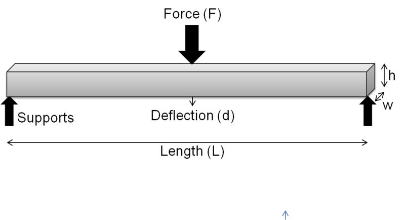

I was unclear on what the difference is between elastic modulus and flexural modulus, so I looked it up on wikipedia.
Elastic Modulus
Flexural Modulus
According to the above, elastic modulus is a more general term, defined as stress/strain, which in an anisotropic material such as wood, has multiple values in the various directions (radial, tangential, longitudinal).
There are several ways to measure elastic modulus: Young's, shear, bulk, flexural.
Young's is about tension and compression vs. change in length.
Shear is about opposing offset forces and change perpendicular.
Bulk is about volume change from forces in all directions (opposite of compressibility).

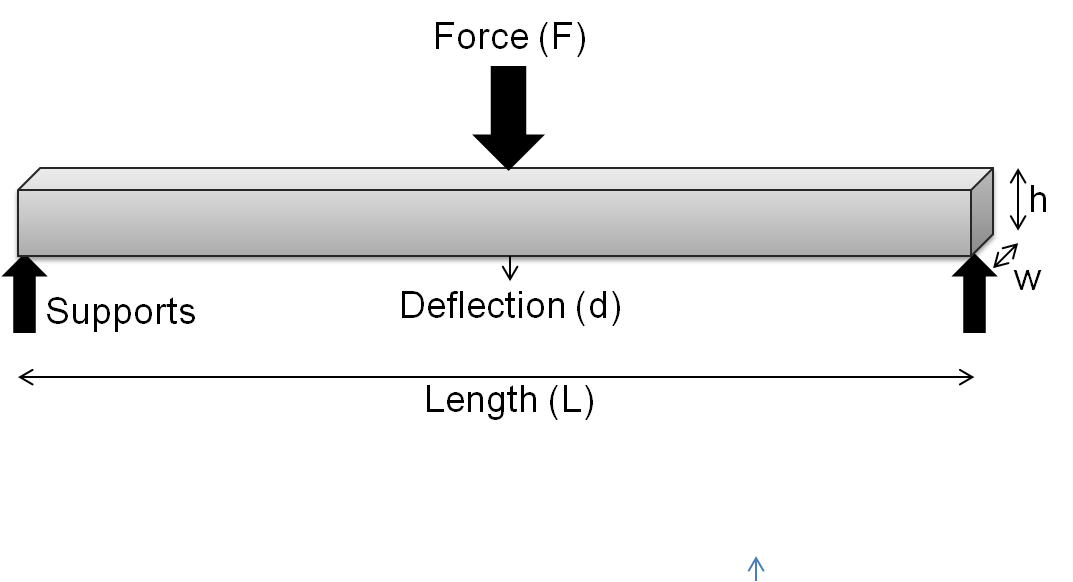

Flexural is about flex due to a moment, typically measured by a three-point bending test of a beam (as shown below).
And then we can say that for small strains in isotropic materials, the flexural modulus is equivalent to the Young's modulus. But for wood, these would be different.
Is my understanding correct?
For a guitar soundboard, I guess we would care more about bending than tension/compression? This is what the wood-database reports (MOE).
Greg
