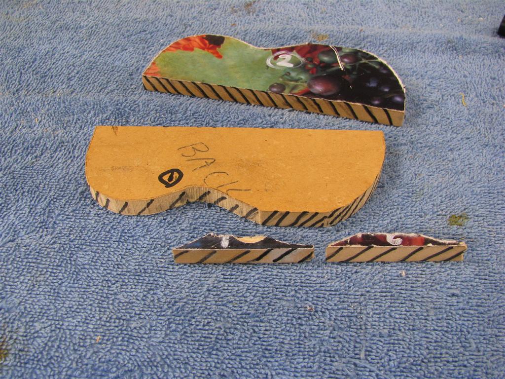

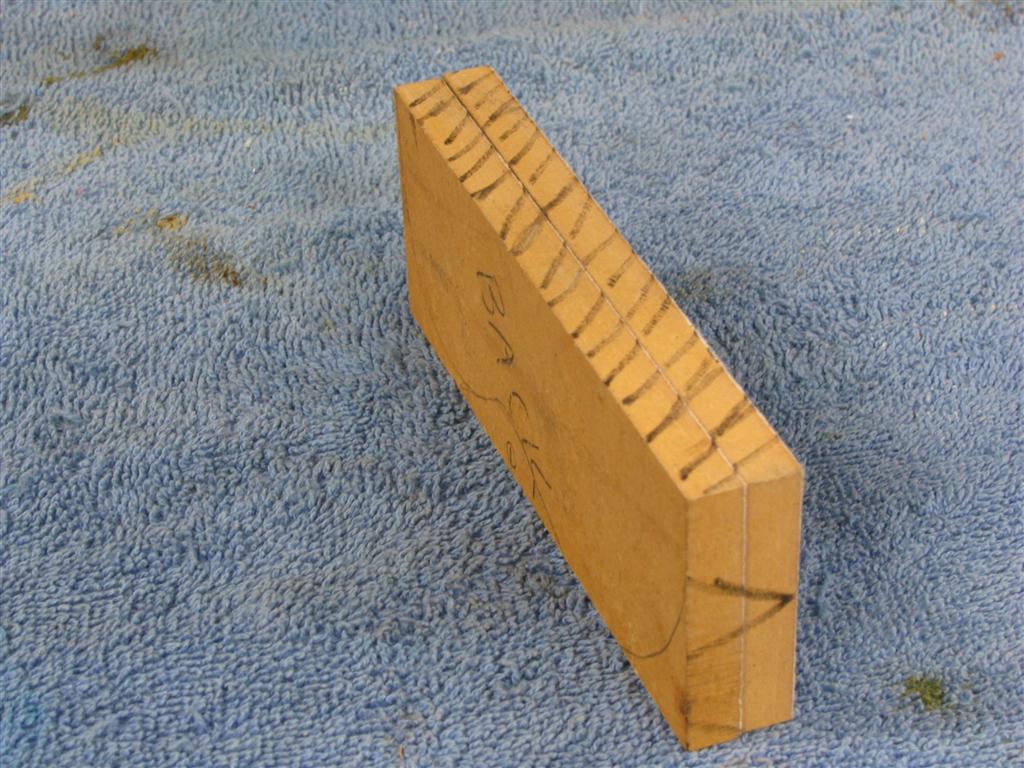

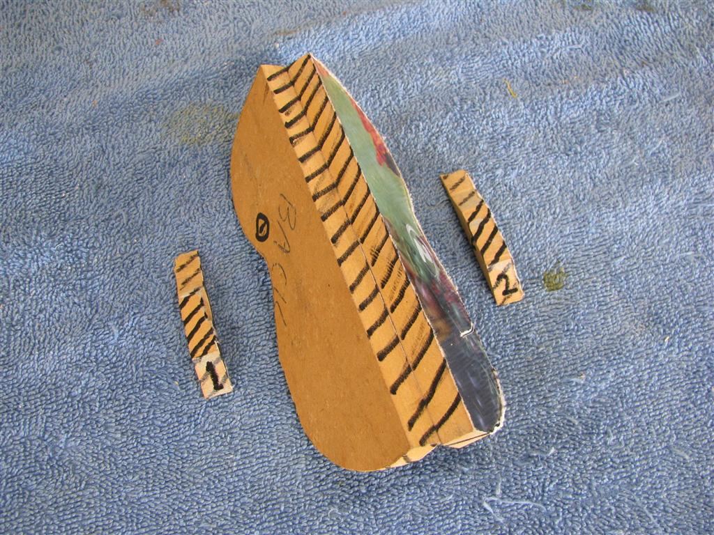

Here we have our mock up billet of spruce all ready for resaw into a bookmatched top set. Those angled lines on the side represent the grain runout present in our super select, triple, quadrupedaled, special reserve, double master grade billet of fruity bear mackerel bridge spiky leopard striped fury goldfish spruce :D ....(Sorry Marty, could not help meself) .....The mdf scraps have the left overs of a block mount still attached to one side, this will help identify the orientation of the plates in the bookmatched set as they are moved around in the following images.

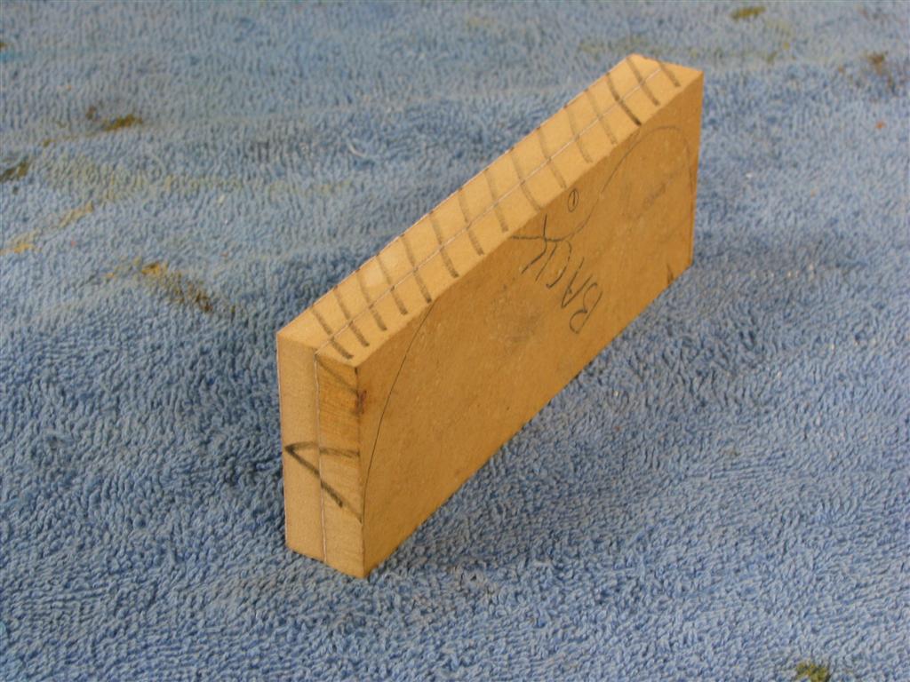

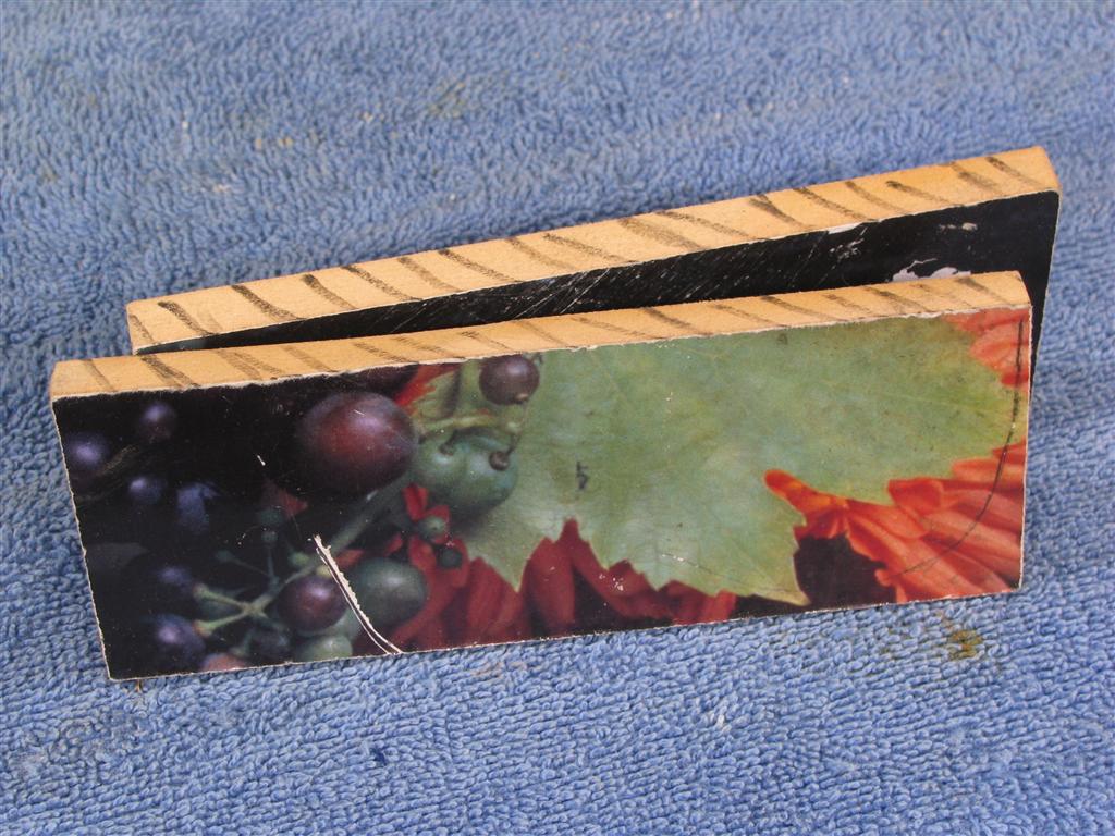

Here you can tell by the reversal of the "V" mark on the end of our billet that we are now seeing the other side of our spruce billet prior to resaw. This image has been included to allow you to see that the marked runout has been carried correctly through the billet.

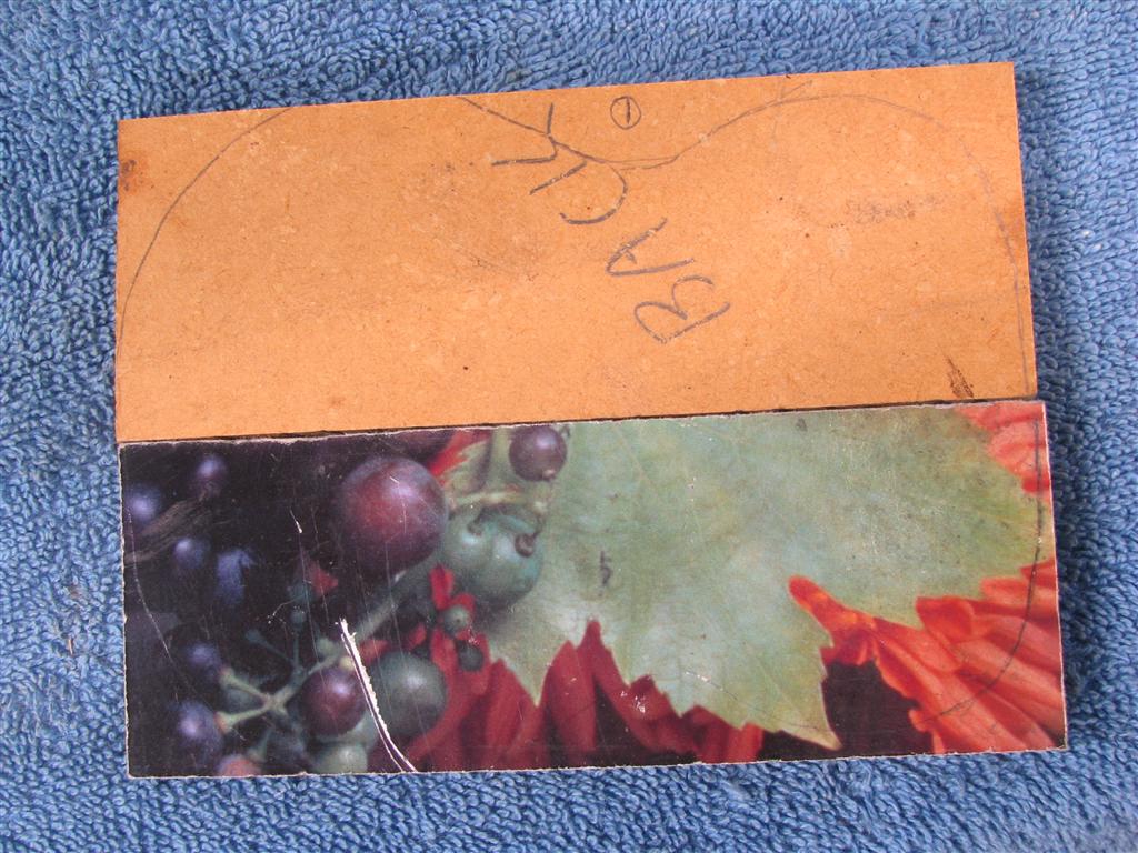

Next the billet has been resawn into a bookmatched pair and is ready for marking out with a template.
An 'oversized' template has now been traced onto the two plates so the plates will require extension wings.

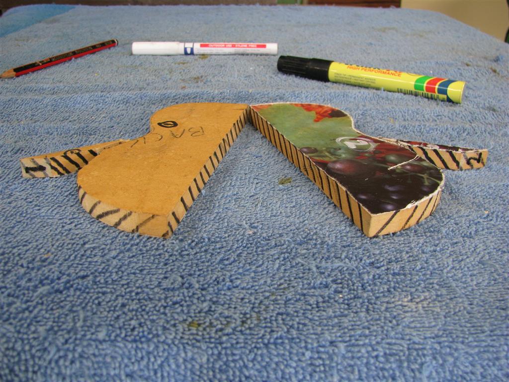

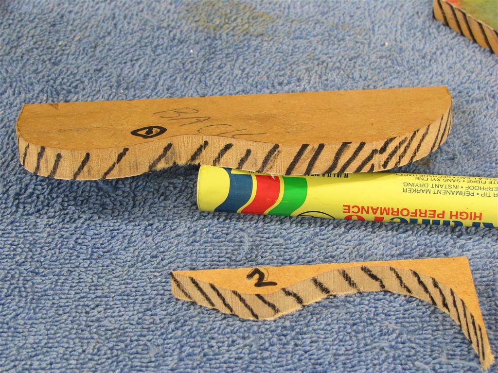

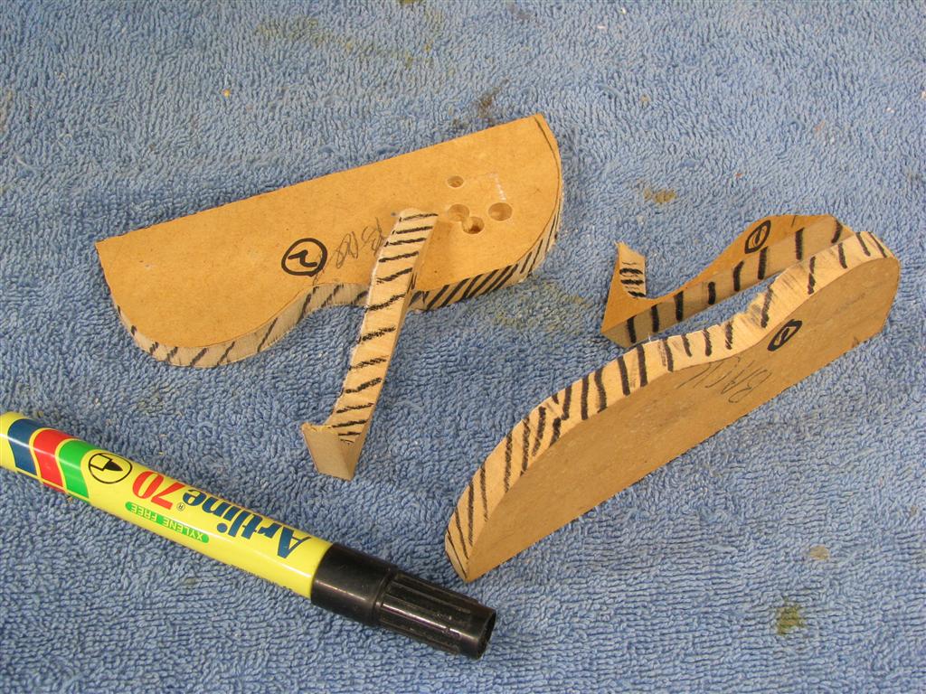

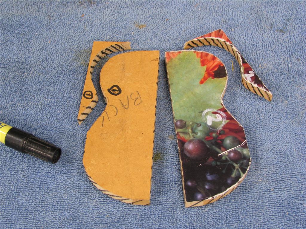

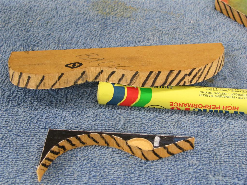

The guitar shape is cut from the plates on the bandsaw and each plate and its waist, waste, has been numbered on top and bottom surfaces for future ID. The runout markings have also been carried through onto the freshly cut surfaces.

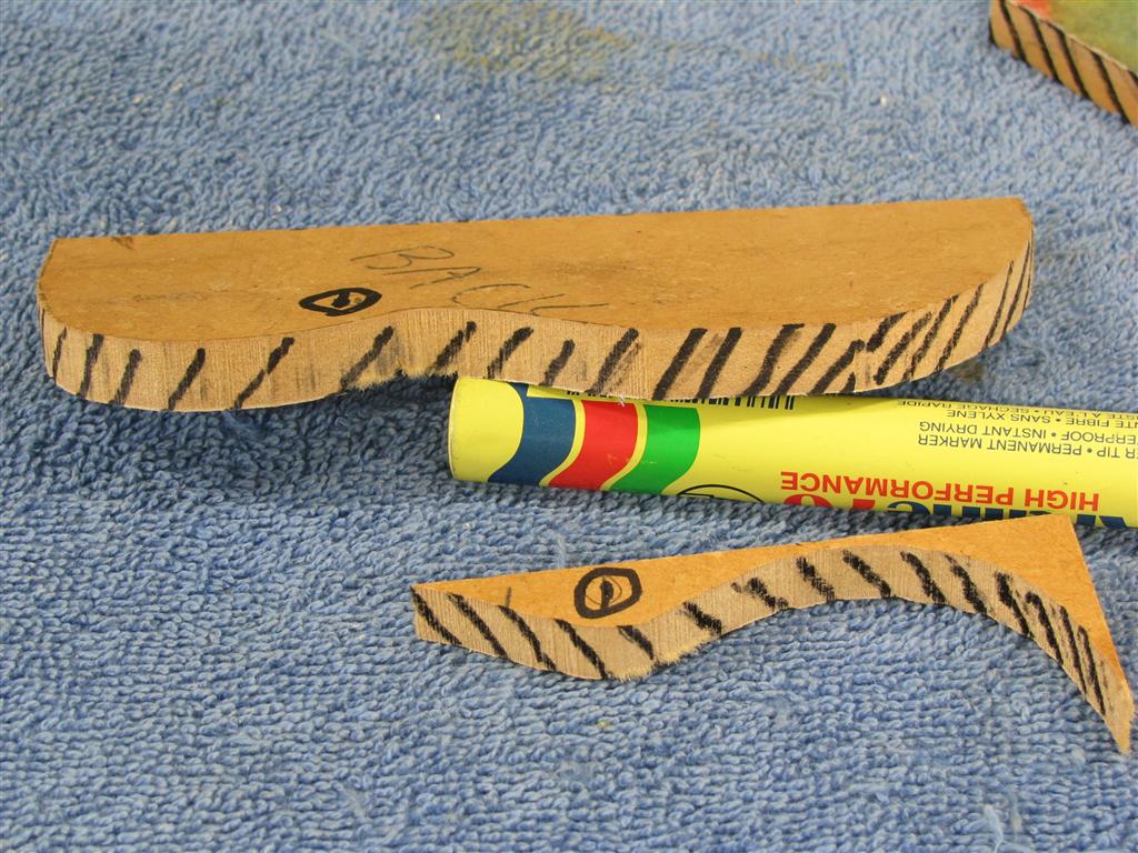

And now if you've read this far, things may finally start to get interesting.
Here we see off cut 1 with plate 1. It has been turned 180o so the long straight edge will present as the glue edge and as suggested, the runout is going the opposite way to that which we see in the plate.

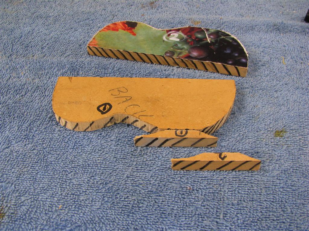

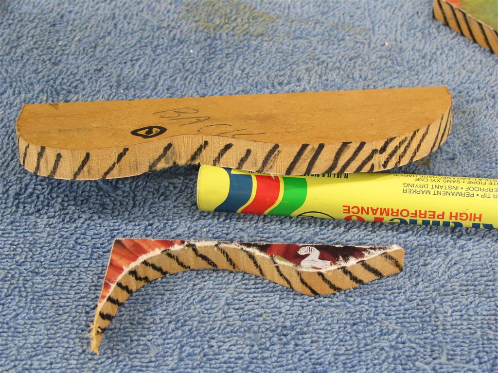

So lets take the same off cut from plate 1 leaving its long edge presented to the glue edge of plate one and just flip it over to see what happens....
Bugga!

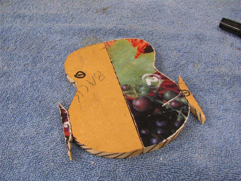

OK, lets get off cut #2 cut from the opposite plate and present the long straight edge of that to the glue edge of plate 1 to see what happens..
The runout is 'still' going the wrong way...so lets just flip it to keep the long edge facing the plate and see if that helps
So...nothing really changed, we have just tried every possible way to present the long edge of both off cuts for gluing to plate 1 but it simply can't be done if we wish to match grain runout and avoid that light refraction contrast...So... this explains why manufactures don't simply flip a plate to improve the appearance of their tops which display moderate runout...it doesn't bloody work!! The only way the concept of moving one plate to match the grain runout in the other could work, would be to turn one of the plates thorough 180o, and doing that would of course completely destroy the whole point of a bookmatched set so you may as well just go an grab any random bits of wood and start gluing them together as guitar tops.. :|

And just in case you need a bit more of a visual to help understand how two bit of wood sliced in bookmatch from the same board can end up with completely opposite directions of runout, then look at two edges of our original billet in this image and it should clear things up for you nicely.
