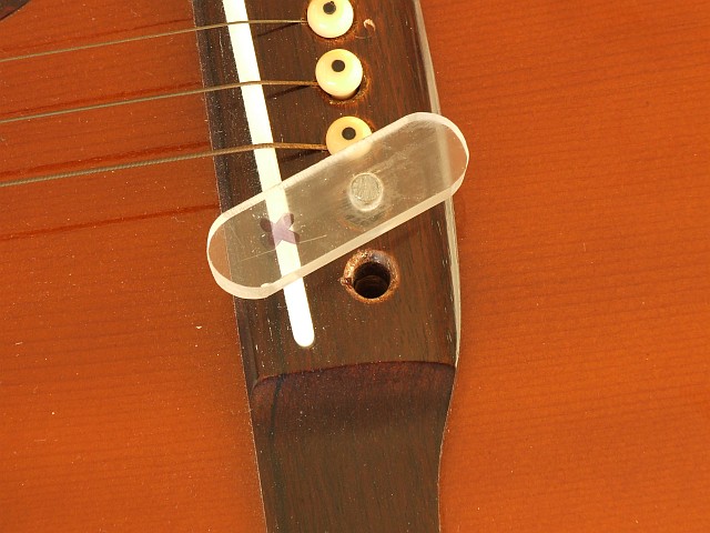

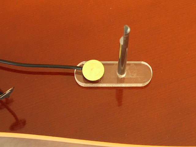

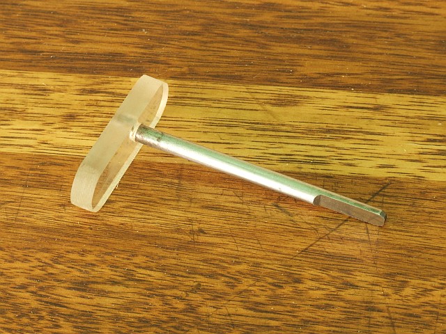

The first is just a more robust version of the K&K golf tee method for steel string pinned bridges of the X-brace type. It uses a tool made from a piece of Perspex and a short piece of 3/16” rod (bits of off-cut from making truss rods).
This method won't work for falcate braced guitars with the braces running between the bridge pin holes.
From the outside, chose where you want the piezo pad and select a bridge pin hole to use. Stick the rod into the bridge pin hole, align it over the position you want and mark the bottom of the Perspex with a Sharpie.
Remove the tool and stick the K&K pad onto the Perspex over the mark, using Blutak or similar.
Apply the superglue gel, insert the tool into the correct pinhole from the inside of the guitar and pull it up to stick the piezo pad to the bridge plate. The trick: make sure the flat on the rod points to the position you want the pad in.

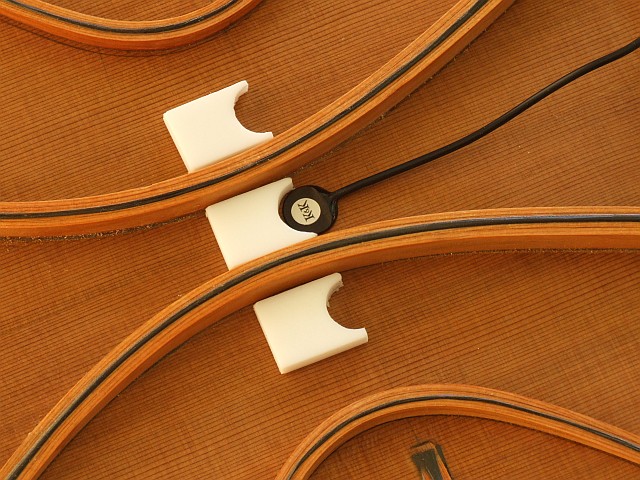

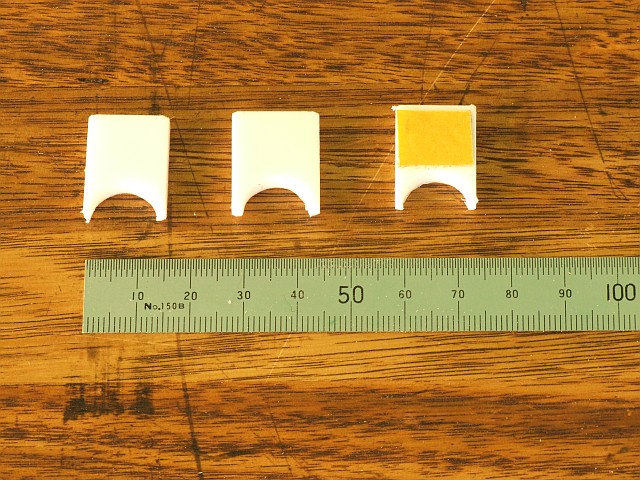

The second method I use is the “sheep pen” method. This method can be used on guitars with a variety of bracing types, provided you can get your hand in the soundhole and still have enough room to manoeuvre. I made these three “sheep pens” from 3mm thick PTFE (so any glue squeeze-out wouldn’t stick them to the inside of the guitar), but UHMW polyethylene will likely work just as well. On the underside is a piece of double sided tape.
The idea is to stick the sheep pens onto the underside of the soundboard so that they can be used to locate the K&K pads. The trick: you can move the pens around as often as you like and keep on sticking and checking (with a mirror) until you have them in exactly the place you want. And then it is quite simple to follow up with the K&K pad with its Superglue gel on the end of your gloved finger, locating it positively in the pen. If you land accidentally on the pen rather than in it, no worries, because nothing sticks to the PTFE.

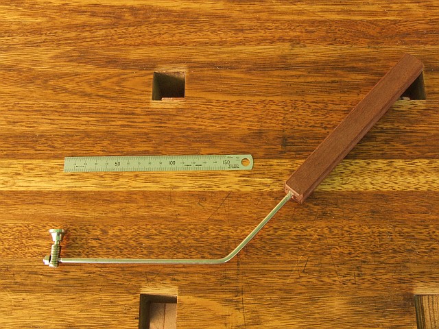

The third method is one I use mainly on classical guitars with small soundholes (e.g. the one in the “Rare Encounter" story) and I use this tool:

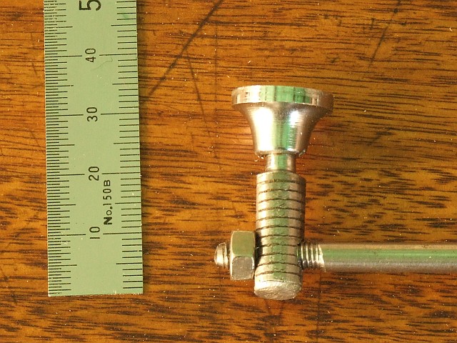

It’s made from another piece of 3/16” rod (truss rod off-cut again) and the swivel shoe from the screw of a G-clamp. I added a wooden handle to make it easier to manipulate. The G-clamp screw has been drilled and tapped and the rod end threaded. A lock-nut holds it in whatever orientation is required for the job in hand. Bend the rod so that it clears any bracing and so you can get clear access to the target position.
The method: lay a mirror on the back of the guitar so that you can see the target position when looking through the soundhole. Stick the K&K pad to the swivel shoe using Blu-tak or similar, apply the Superglue gel and then, looking in the mirror, stick the pad onto the guitar.
