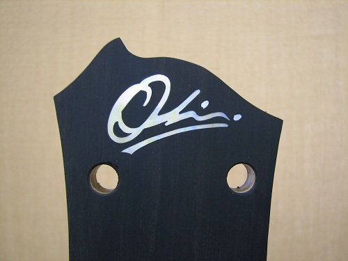

My process is as follows-
-Draw onto paper the logo/inlay you want making sure it will fit onto your blank (I have a standard logo I use so I used photo editing software to reproduce my original logo multiple times to fit on an A4 sheet then photocopied multiple sheets)
-cut around the logo/script fairly closely and then glue it (I use titebond but any PVA type will do) to the shell blank.
- Make a backing board to hold the shell on while cutting it. I made one from a scrap of 10mm MDF about 80-90mm wide and any length, this doesn't matter it only has to be long enough to hold in a vice. Then I just drilled an 8mm hole close to one end then ran a slot from the hole out to the end so you effectively have a 'keyhole' that runs out the end
- Cut out inlay from shell using the jewellers saw (this is the bit that requires practice!),hold the shell down onto the board (I just use two fingers either side of the cut) & try and keep the saw moving up and down vertically!If you twist at all you will break a blade! The other thing that's sure to break a blade is if you don't hold the shell down tightly enough and it kicks up while cutting! Believe me I found these two facts out from practice :oops:
The books will tell you to rotate or move the shell whilst keeping the blade cutting, rightly or wrongly I also move the blade and turn the frame as well as needed, it works for me.
-Any 'holes' inside your inlay, pre drill a small hole. The blade can easily be removed from the frame so put it through the pre-drilled hole and fix back in the frame to cut out these inner holes
*Make sure you wear at least a suitable mask when cutting shell but ideally some sort of suction device near the cut. The waste from shell is extremely fine & easily inhaled!*
-After you've cut out the inlay it may require 'cleaning up' to straighten out wavy cuts or incorrect curves. Hold the inlay tightly down on the board with the section that needs cleaning up over the 8mm hole and use a needle file to clean up the edge, don't rub the file on the shell on the upcut, this will risk breaking the shell on finer sections, only cut on the downcut!

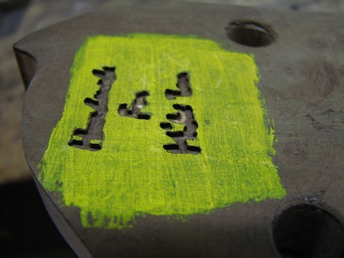

-Once the inlay has been cut & you are happy with the outline I mix up a little yellow poster paint (the powdered stuff you mix up for your children's early painting exploits, with a bit of warm water) and paint it on the face that is to be inlayed. Only do the area you want, no need to do the whole face!
-When the poster paint has fully dried I put the shell inlay I've cut onto the face & position it where I want it to go.
-While carefully holding the shell down I trace around the inlay with a sharp scriber (I have a very fine purpose made inlay scriber available again from Stewmac but any finely tapered sharp point will do, old points from a marking gauge will do or a machinist's scribe). This will leave a line in the yellow paint to follow in the next step.
- Mount a cutter of suitable diameter (I use downcut bits because it doesn't fuzz up the top edge of my cut and leaves a nice clean cut) into my Foredom (Dremel is ideal for this also, I used one for years before getting the foredom) which is mounted in a router style base(ignore the bit and edge guide, I copied directly from Stewmacs site)
I set my depth of cut to not quite the full thickness of my shell (0.060" shell= 0.040-0.050" depth), we want to remove a small amount of shell in the final step, this way it will be perfectly level with the headstock face. I carefully begin routing my pocket. You can go slightly outside your lines but try not to make a habit of it otherwise when you come to the filling step you will end up with a lot of filler which will be obvious!
Again this is part of the practice I spoke of earlier and for your test/scrap/first inlays you may wish to practice on scrap!
- Keep nibbling away at the inlay pocket until the shell fits nicely in it.
- Before gluing the inlay in lightly sand off the poster paint, any that is sitting in grain pores can be removed with a damp cloth. We want to remove any traces of paint now because it may become trapped in the pores after the next step & will show up!
- Mix up some epoxy (I use the 24 hour Araldite) and mix in a little fine sawdust from any scrap of the same veneer or material that is on the headstock face. This makes the epoxy almost the same colour as our headstock face when dry & any gaps a little less obvious!
-Fill your pocket with the mixed epoxy, not too much but enough that when you put the shell in the epoxy oozes out & fills any gaps. Ideally you want a line of ooze out all around the outline of your inlay.
-Leave to dry for 24hours then file off the excess epoxy leaving your filing slightly proud of the surface, then finish off by sanding (filing is good for getting the bulk of the excess off but we don't want to mark our face!) down to the face.

I will add that if you plan on using a light coloured face on your headstock that the pocket must be very close fitting. Any sawdust mixed with epoxy will darken up and will show up as a dark line on the lighter woods.
Good pictorial too Pete, sums things up nicely. Don't have all the pics necessary for a full pictorial tute that's why mine was a bit word heavy but pictures do tell a clearer story. :D
