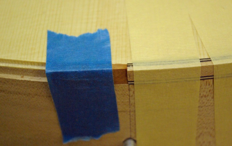

I was struggling to keep the purfling and binding lined up at the centreline at the base of the box.
What worked for me was a little stop block taped dead on the centreline. Then I could push the binding and purfling against it while fiddling with strips of wood, strips of tape and glue everywhere.

great idea. thanks
