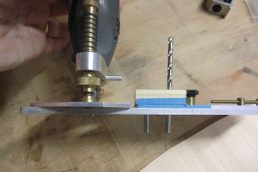

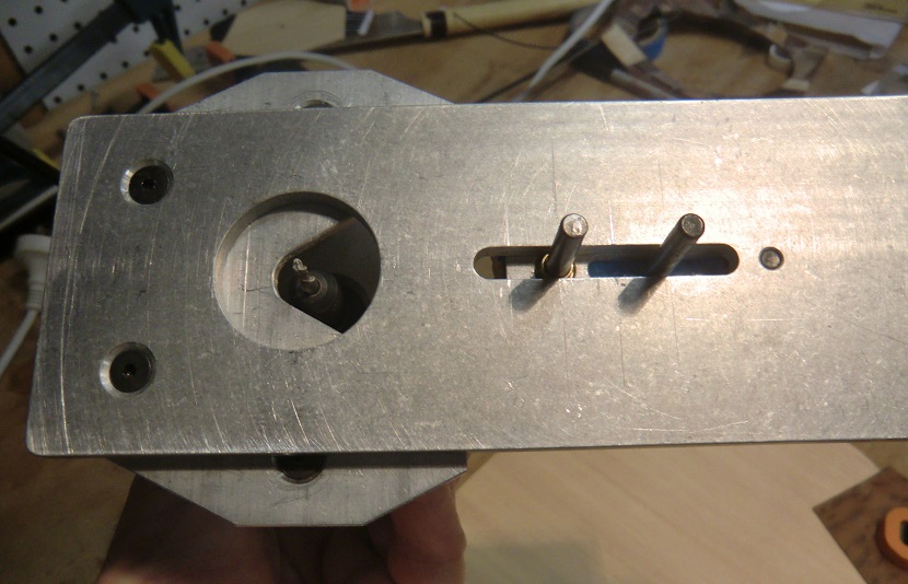

These examples demonstrate how to route a big ellipse shape, like a table top. We need to scale it down to make a guitar rosette and soundhole. Here is my adaptation of the Stew-Mac circle router using a Dremmel tool. The usual axle pin is supplemented by a second (a drill bit) held snug in a small block of wood and secured to the jib by tape (double-sided tape, or the superglue and masking tape trick).
Some basic mathematics – the area of an ellipse is (π x R1 x R2), where R1 and R2 are the radii of the short and long axes of the ellipse. You can choose dimensions which will give an equivalent area to a normal circular soundhole (e.g. 120mm x 80mm gives an area almost exactly that of a 98mm diameter circle). Once you have decided on the dimensions of the ellipse you set the two pins at a distance from the Dremmel bit that equals half the diameter that you want to achieve. For example, if you wanted a hole of 120mm x 80mm you would set the pins at 40mm and 60mm from the bit. You need to consider whether to take your measurement from the near side of the cutting edge (if you are cutting out a rosette disc) or from the far side (cutting a rosette channel or the soundhole) – but if you have experience cutting circles with this jig you will already have worked that out.

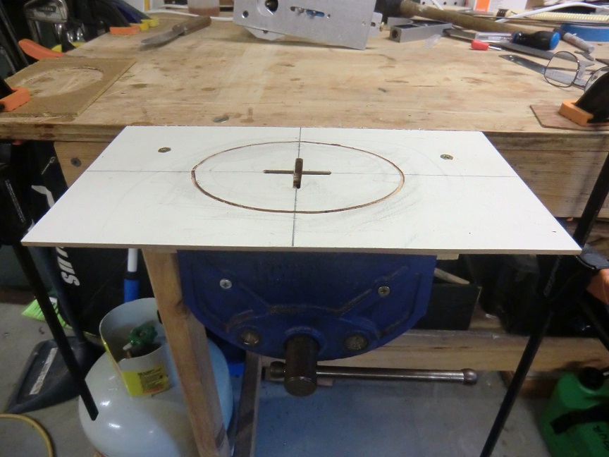

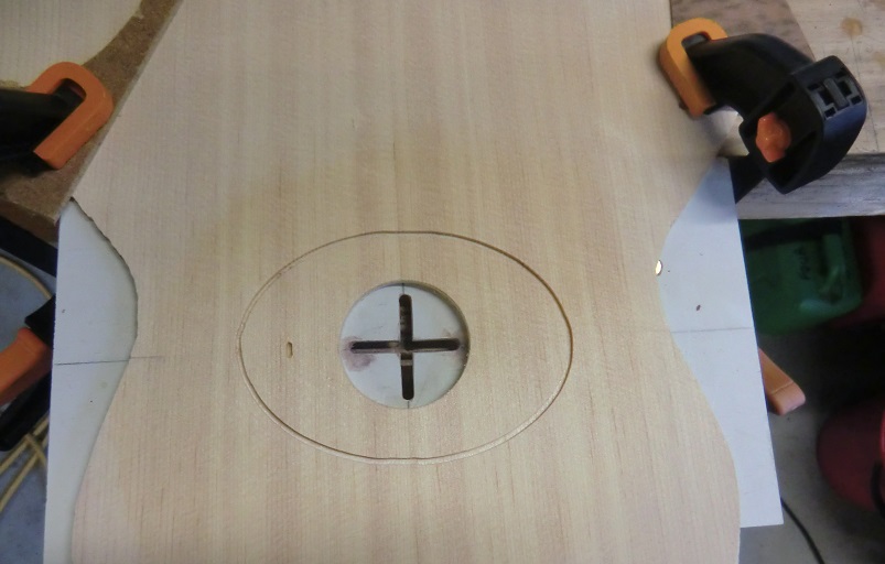

You then need to make a cross-shaped track for the pins to run in. Thin MDF or Masonite works well for this. The cut-out needs to be a tight fit for the diameter of the axle pins so that they don’t wobble about as they run. I screwed a solid block of wood to the underside of this so that I can mount it securely in a vise at bench height. Then the guitar soundboard sits on top with an initial small hole cut just so that you can see the jig underneath and get the alignment right. Some corresponding marks on the soundboard help get it straight. An oval that is slanted a bit wouldn't look too good.
In this job I cut the outside edge of the rosette channel first. Then you could adjust the diameter to do the inside edge of the rosette, and then use some method (Dremmel freehand, or chisel) to hog out the material between the channels. My rosette was going to extend all the way to the soundhole edge so I didn’t need to do a second channel for the inside edge.

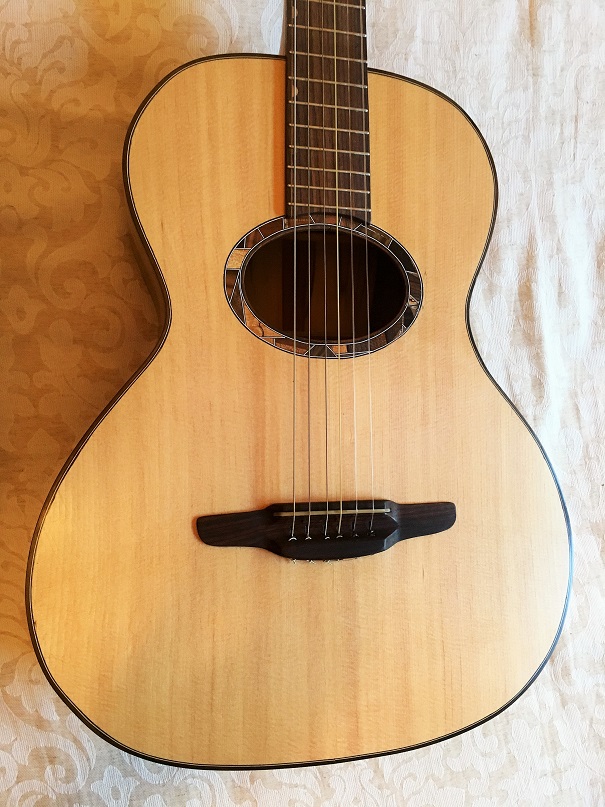

Use a similar process to cut out your rosette material. I glue it in with a Perspex caul in the go-bar deck.
oval jig 5.jpg (93.81 KiB) Viewed 53037 times
oval jig 6.jpg (136.09 KiB) Viewed 53037 times
Once it is dry you can cut out the soundhole to final dimensions. In this case it was a bit oversized so that a soundhole binding could be added to bring it to final dimensions.
I found the cutting process a bit stressful (high pucker factor as Robbie O'Brien would say). The tracking of the cutter can get a slight wobble as it flips from pivoting on one axis to the other. You need to go slow, especially at the ends of the ellipse (where you are also most likely to get tear-out of the grain). I had to tidy up some slight irregularities. As always - do lots of practice on scrap first!
