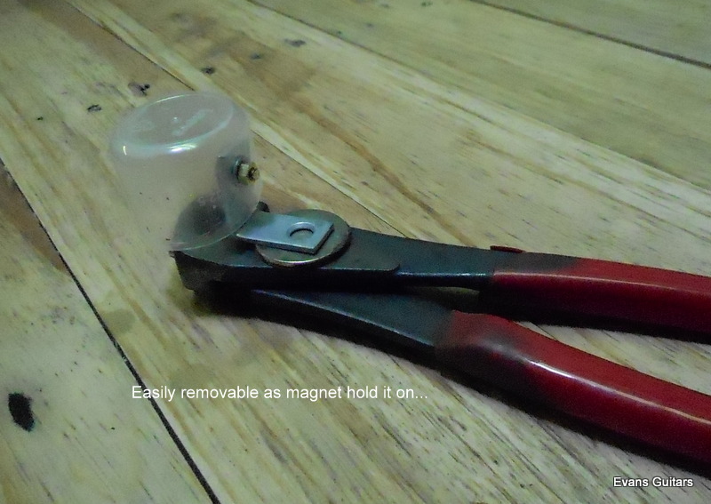

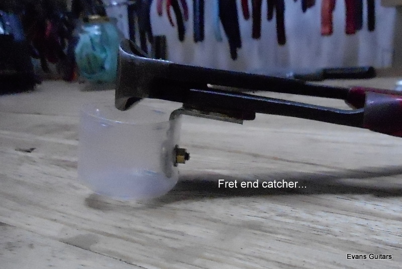

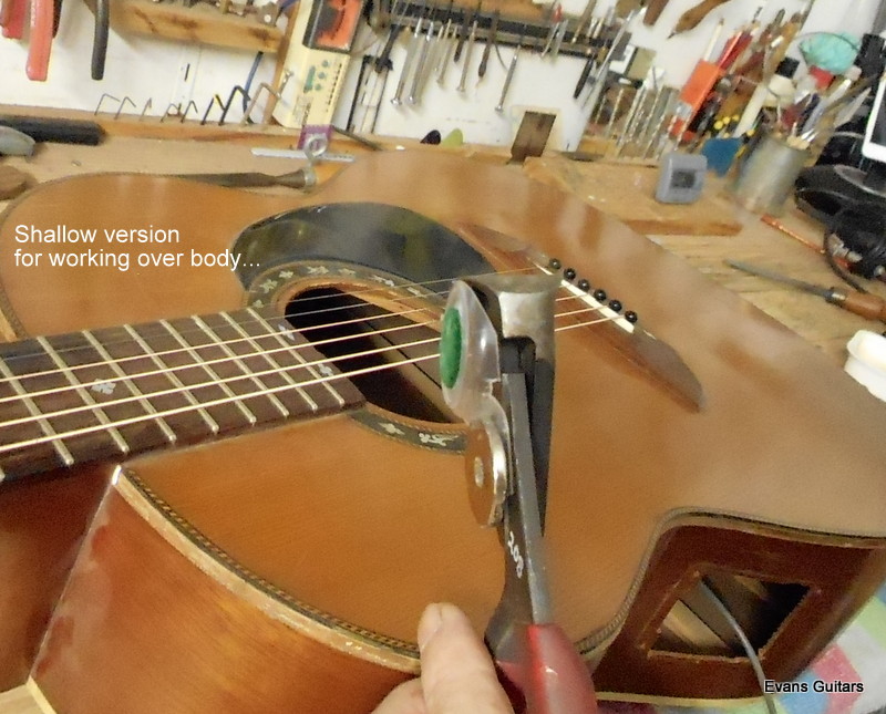

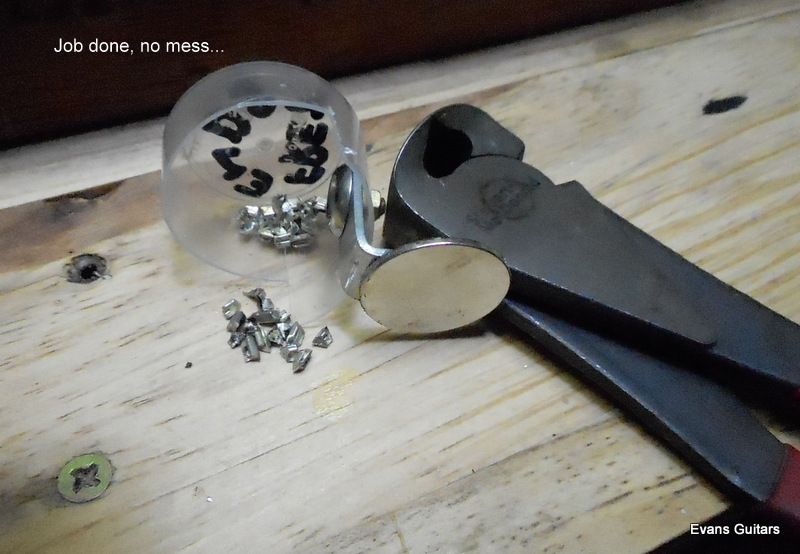

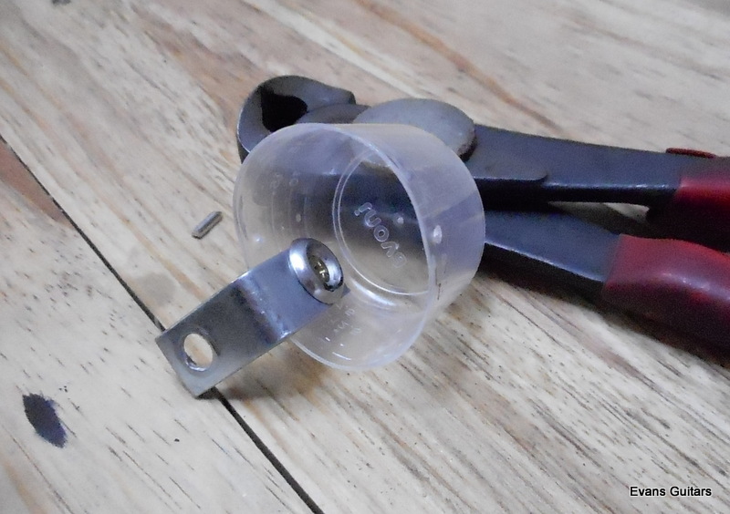

Let’s start off with a simple idea.
The Fret End Catcher:
Pictures tell the story, and it only took me 50 years to come up with this idea due to my wife complaining of tiny fret ends in the carpet in the house.
Thanks for looking.

Yes and it will help missing some of the fret bits on the bench and denting a box.
