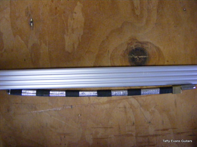

Hi, Hi, I used to make my own rods back in the day and still do if I need a custom size. Basic description: They are only one-way acting and consist of a 3/16/steel rod bent in half and taped as shown with aluminum tape One end stops at the brass block while the other goes through the block and is threaded to take a nut of your choice. In my case, I use a Fender-style bullet-style nut.
I got this idea from William Cumpiano’s book Guitar Making Tradition and Technology. I got my book in 1989 but there have been reissues since then. A great book for the beginner.
Cheers Taff

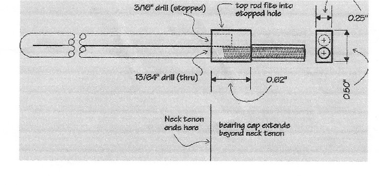

Hi again, just came across this in one of my files...
I used to get the brass blocks from Gilet in Sydney.
Cheers Taff

Thanks Taffy that is such a big help takes all the guesswork out of the equation
