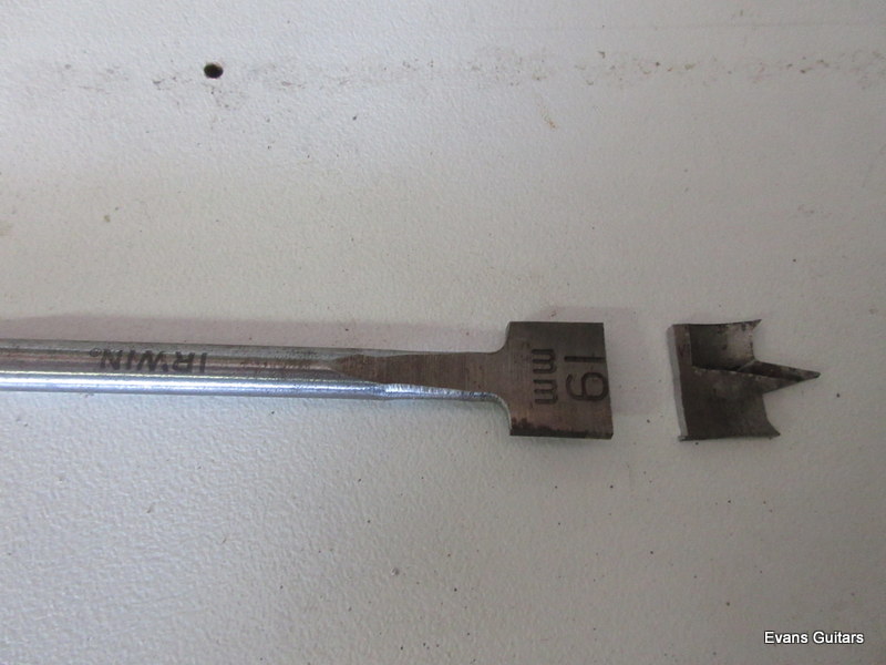

Hi, here is a very simple idea I came up with for drilling a countersink hole inside a guitar.

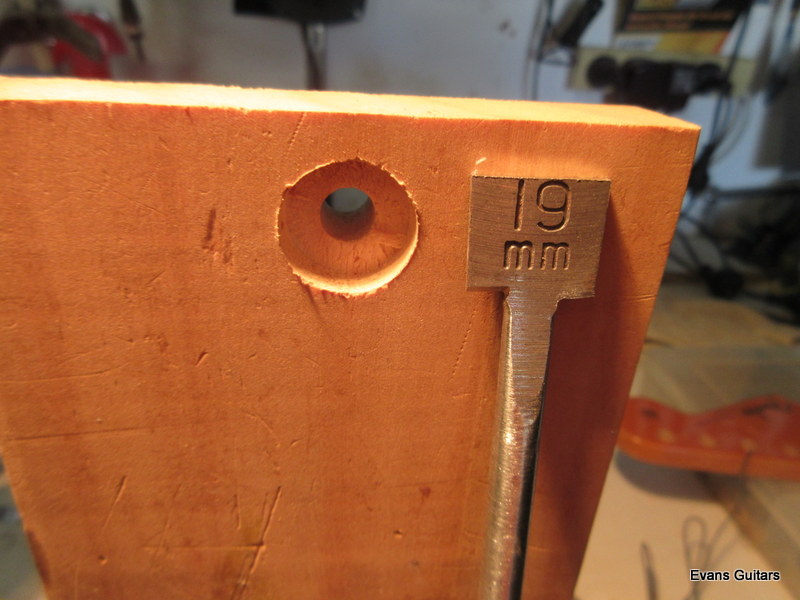

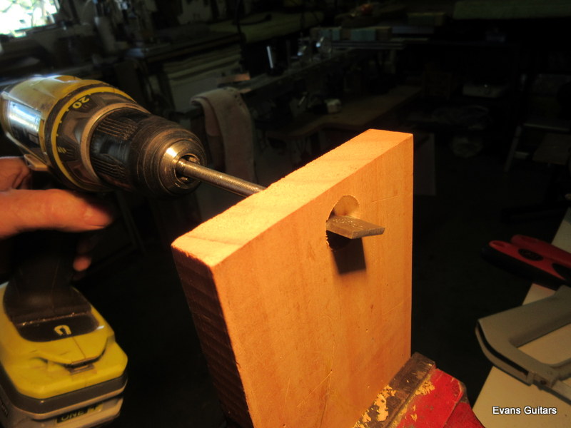

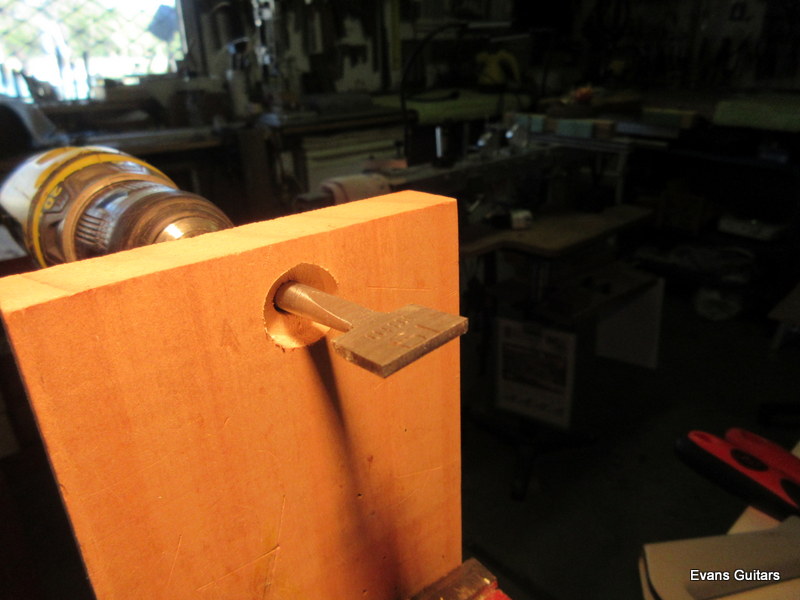

At times when doing a repair regarding heal repairs or neck resets I have often converted the neck attachment to a bolt-on method. To make the repair look neater I always counter-sink the bolt head into the neck block. This is not possible when the guitar is complete, so I do as shown in the photos, the cutting edge is on the back of the blade at the shaft end.

Is that just a square cutting edge on the back of the bit or sharpened similar to the front of a spade bit? Thanks, Bob

Hi Bob, thanks for looking in, yes I filed a cutting edge on the back like that on the front. The shaft that goes through the hole replaces the locating point that is normally on the front and stops the bit from skating around. I am just wondering if a similar bit of a suitable size could be used to countersink the washers used on tuning machines on the front of a peghead, for a neater look. I'll give that a try. I may need to incorporate the cutting-edge that has scribing blades on the outside edges. I hope that makes sence.
