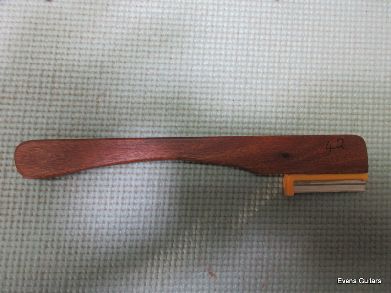

Hi, I have a set of these Music Nomad diamond nut files, and they work fine in the cutting department, but for me, they are too small, and with my hand on the yellow handle it restricts my view of the job.
So to make them more in line with my other nut files, I did as shown in the photo. It also permits better light access from my bench light.
Also if you go shopping, I found a difference of $20.00 each, between the retail price of some dealers.
Cheers Taff

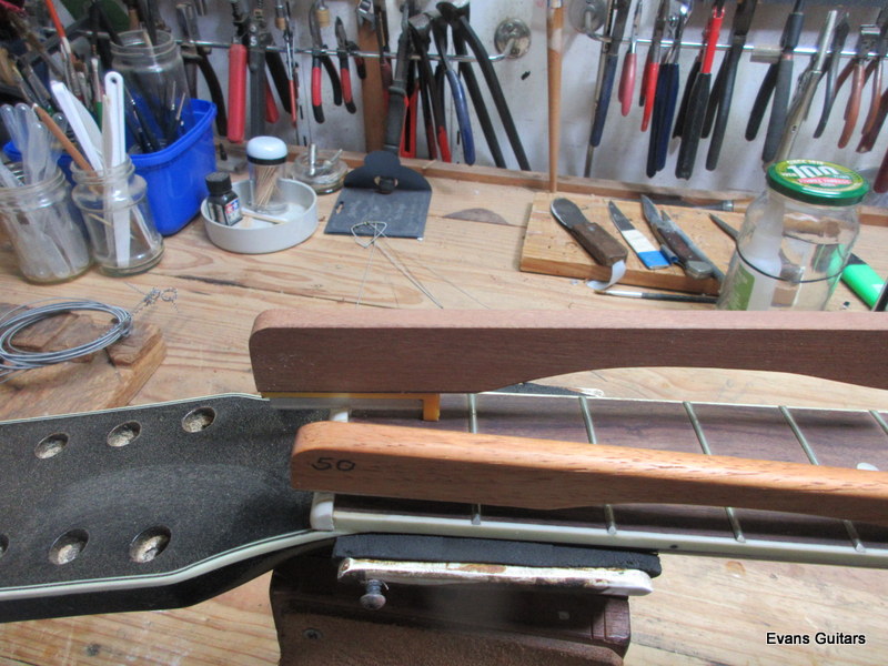

I find tuner posts and strings are in the way of the correct slot angle on a strung instrument as well with those files. Thanks Taff, good idea I think I will make a handle too.

Hi Trent, yes, I found that, and the fact that the plastic end of the file holder was too close to the peghead finish for my liking. While I like the idea of wooden handles I may go to plastic. As I would need 10 or so handles, I thought I would get my grandson in Adelaide to 3D print them for me. He can sit back and let it happen. He has printed a few tools for me in recent times.

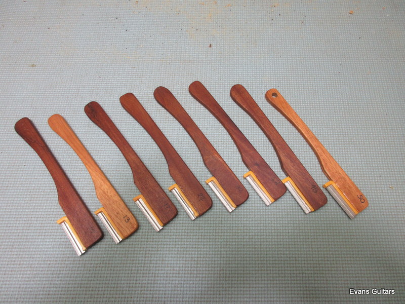

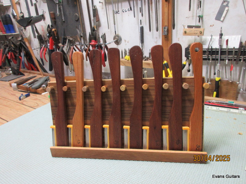

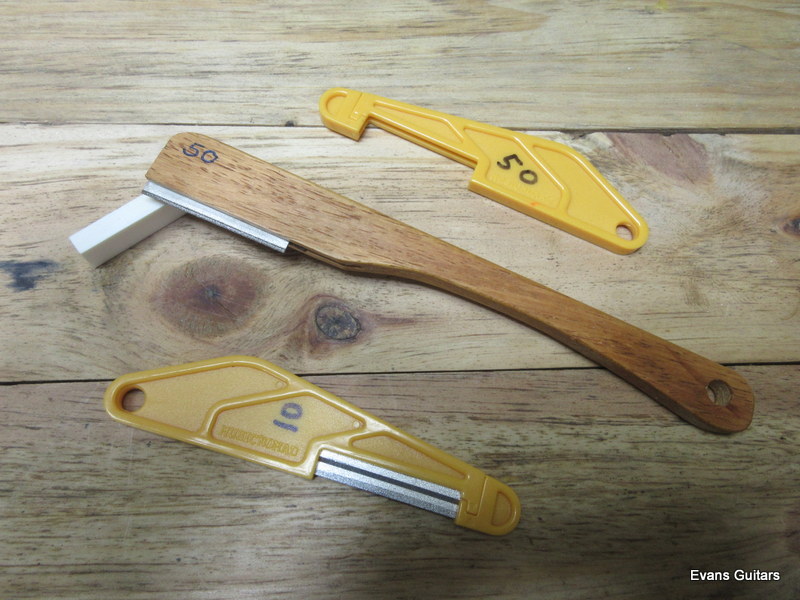

Hi, further to this project of modifying the Nomad nut files.
I decided that when making a whole set I would do it this way, utilising part of the original. This gives me better visual access than I had with my original design.
I do like the quick cutting of the diamond file, but the functionality of the original plastic file was woeful. The overhang at the front was the problem for me.
