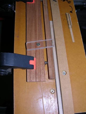

DSCN0433 (Small).JPG (27.81 KiB) Viewed 5323 times
Heres a jig I have used over the years when gluing up. Shown in the jig is a back strip but the same deal for binding. The jig is about a meter long or so and has springs like the one shown, down its length
