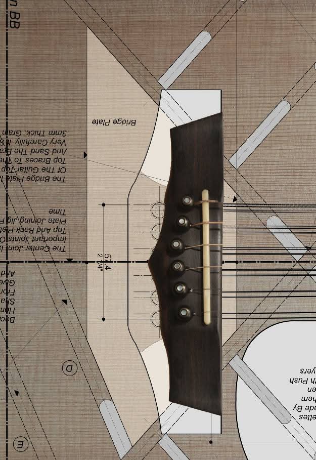

So I'm thinking of increasing the bridge size to address risk of bullying or bridge bulging.
I'm after advice on how much to increase. Minimum. Too much I reduce some of the advantages. Width? Depth? Thickness? Not necessary?
This is image of my grandson's chosen bridge shape superimposed over my 12-string dreadnought plan (and my soundboard.) Below options.
This is just depth:
Width and depth
Just depth
Oh. It changed the order and put the six string size at the bottom.
152x37.5mm = 6 string dimensions
152x42mm = more depth
172x47.5mm = depth and width
