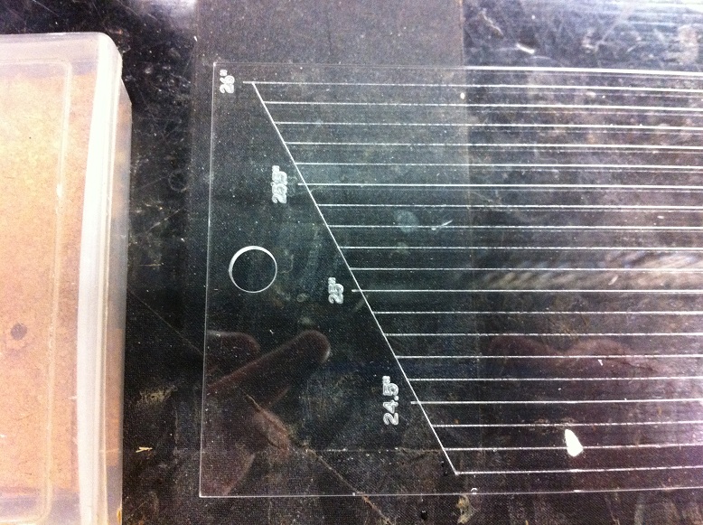

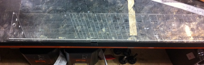

I might pinch your idea and put it onto a piece of see through perspex with the laser as an overlay, we are for ever using rulers to identify what scale length has been used prior to ripping a board of, this would give the answer in less than 20 seconds
Re: Scale length approaches
Post by simso » Sun Sep 07, 2014 2:08 pm
Tims idea on plastic

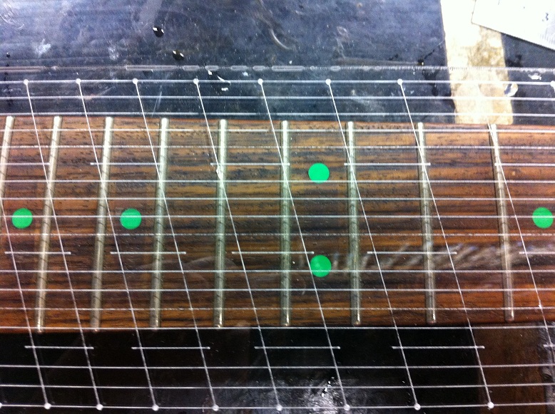

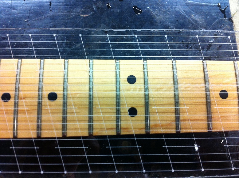

Some 12th positions
The gapped spots on the ruler, are quick referenced 1/2 inches example 24.5, 25 and 25.5
12th ibanez.JPG (226.42 KiB) Viewed 63342 times
12th fender.JPG (220.44 KiB) Viewed 63342 times

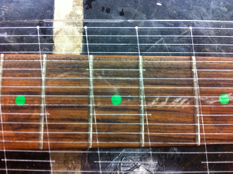

Post by simso » Sun Sep 07, 2014 2:10 pm
Checking some other positions to make sure they are in the right spot compared to the 12th
template head.JPG (228.81 KiB) Viewed 63342 times
fretted positions.JPG (227.71 KiB) Viewed 63342 times
Post by simso » Sun Sep 07, 2014 2:18 pm
The ruler identified really quickly that the ibanez neck which was meant to be 25 1/2 wasnt fretted perfectly, it wasnt out by much, but at the 24th fret it was a good 2mm off, and the other positions were all fractionally out
The fender neck was perfectly fretted in all positions

Post by simso » Sun Sep 07, 2014 4:06 pm
If you want one, happy to send one out, the unit I made is 24.2 to a 26 inch scale,
You've helped me out before kim with the kerfing jig, so Id be honoured to send one down to you, but remember credit goes to tim, its so obvious of an idea but only in retrospect, if anyone else wanted one so long as they pay for the acrylic and postage no probs
