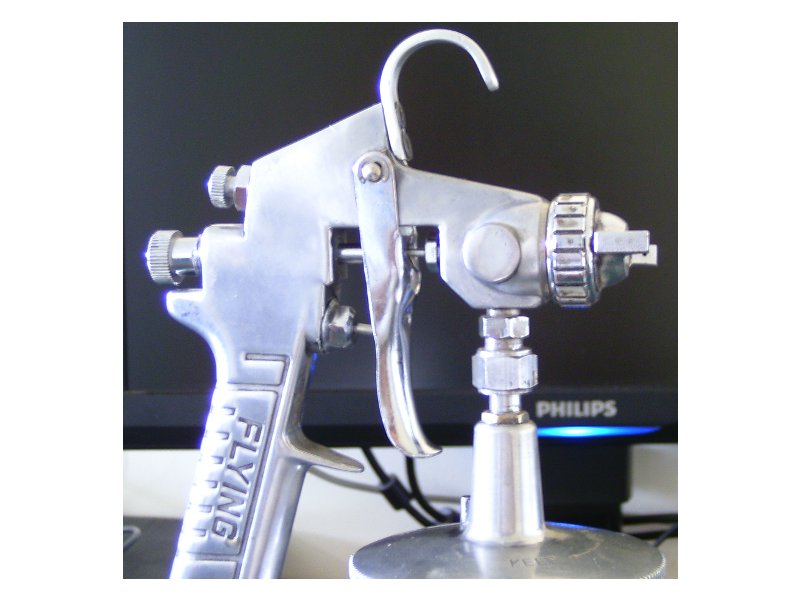

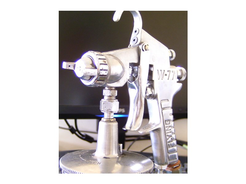

This is probably a dumb question but here goes. :oops:
Can a suction feed spray gun be converted to also use a gravity feed pot?
I ask this because I've been given what appears to be a reasonable quality spray gun that looks like it was designed to be made to work either way as it has a round molded section to one side of the nozzle where one could possibly drill and tap in a fitting.
Or would it be a waste of time and effort?

Wal,
I think it would be a waste of time! I do a lot of spraying at work doing the galley's in motorhomes,timber moulding etc etc, and myself and family have always owned smash repair business's. Over the years I think I have tried them all,but the one that impesses me the most for spraying guitars is a Star gravity feed touch up gun similar to the one Allen has. The new model has a air control, which is situated under the grip,fan adjustment on the side and flow control on the back of the grip.I have recently purchased the new model, and surprised to pay only $85.00.

If the gun sprays fine as a suction feed, then I wouldn't bother with trying to convert it. In fact, the ordeal of trying to make it into a gravity feed with unknown result would put me off of it.

Thanks so much for the reply guys, I'll leave it as it is.
