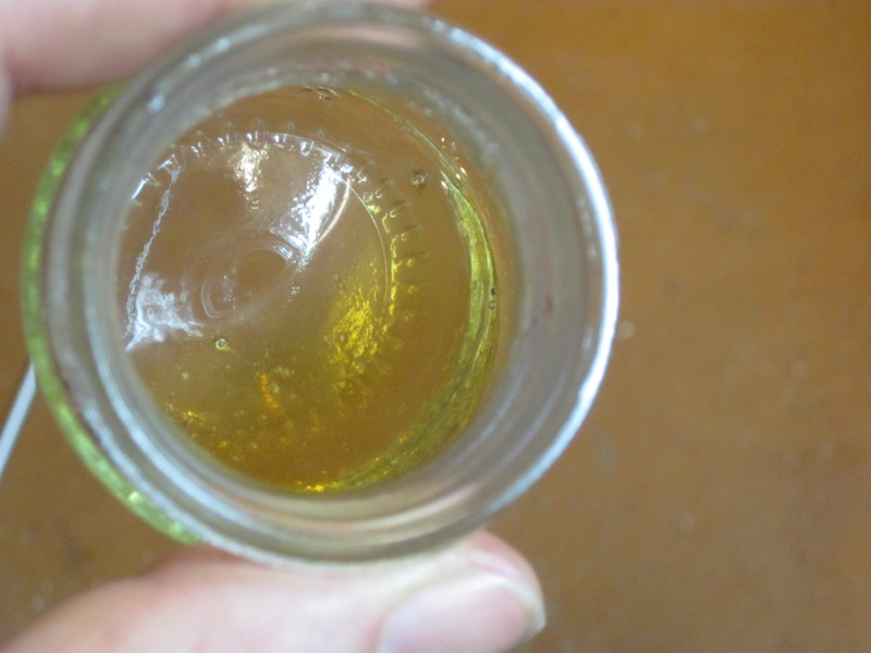

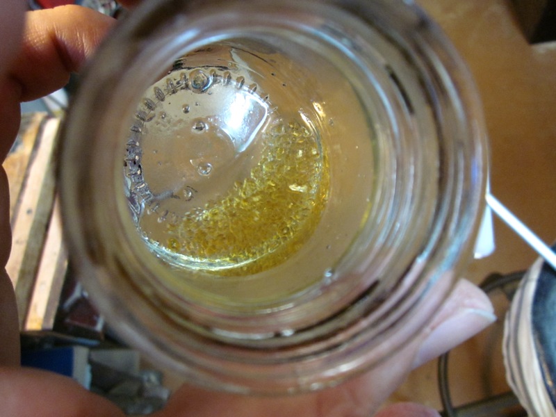

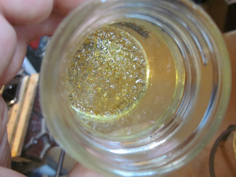

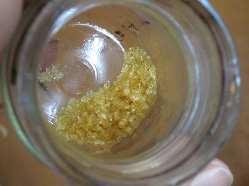

I did a quick photoshoot on my glue prep stages.
From start to ready-to glue approx 12 mins, and is enough for quite a bit of work.
Teaspoon of dry hide glue
cover with water, and a bit more
wait ten
add some juice
after two mins, runny like thin honey. Keep at this consistency for strong work. Thin as required.

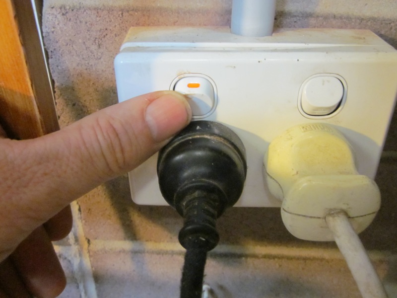

Just to clarify.....in Photo 4 the switch has to be in the "on" position and to get it from the "off" to the "on" position you use your index finger? :mrgreen:

kiwigeo wrote:Just to clarify.....in Photo 4 the switch has to be in the "on" position and to get it from the "off" to the "on" position you use your index finger? :mrgreen:
I'm glad you cleared that up Martin. It can be so confusing knowing which finger to use. In this case I use my thumb, because my index finger is used for taste-testing the glue to make sure it is properly cooked. It is not good to get gobs of glue on the on/off switch. But if you do, it all cleans up nicely with hot water. This is why hide glue is so safe.
**Readers please note: the switch can also be used to turn the electricity off when finished.
