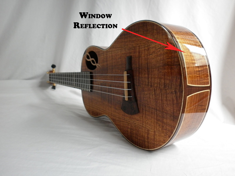

When positioning your instrument, take mind as to the type of reflections you are getting. The white backing is great to throw light around and remove unwanted reflections but as you are using natural lighting, that has to get in somewhere so you will have reflections depending on the angle you are shooting from. Such as this window frame -
As many of our finishes are high gloss, it can make it difficult to shoot. They will reflect everything, yet without reflection, they can make the finish look flat. It is difficult to get the balance right, particularly when you are also wanting to highlight the refraction of light in the figure. You can use the highlights and reflections deliberately as in this picture to show finish gloss, but I feel it is too much here.

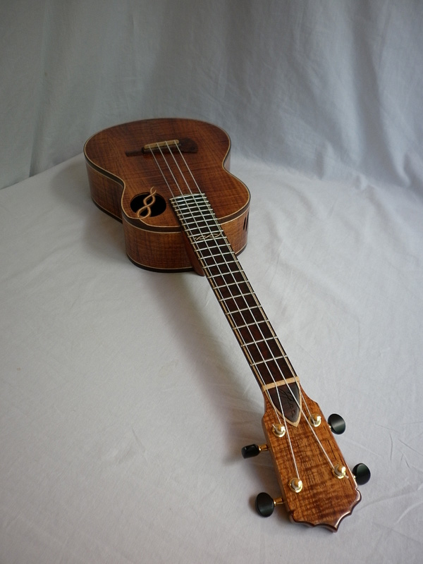

Finally a note on composition. I move the instrument around a lot and try different angles. I find that a bit of 'attitude' in the shot can make the item seem larger than life so to speak, so play around. This next image is a good example of what I mean. But here ends the 'photo shooting' aspect of this tutorial. Next I'm going to use Photoshop to remove the background altogether. I am fortunate enough to own my own copy of this - for those who don't and can't justify the purchase, I believe there is free software available with similar functions though I can't recall now what it is. Perhaps someone else will chime in with the option. If not, you could certainly opt to use a 'harder' flat backing such as a large roll of cardboard or similar so your background is acceptable as is. The sheets could be acceptable too, just that they don't go with my website you know? :mrgreen:
As I said, pretty straight forward thus far but I hope it helps some of you. Sorry to those who were hoping of a more accessible way to remove the background or create similar images to mine... :roll: Anyway, that is how I achieve the photos themselves.

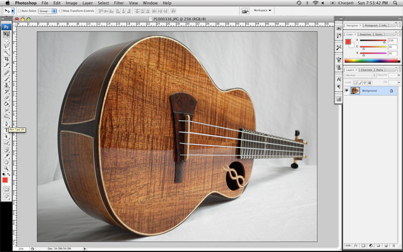

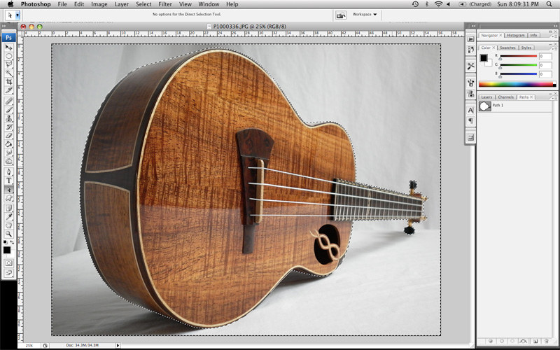

Next, the image I'll use for this part of the tute. As mentioned, I use Photoshop to remove the background. This is awesomely powerful software of which this work only scratches the surface of its capabilities, but it is all we need for the job at hand. Here is a screenshot when I open the image - if you have photoshop and yours looks different to this, it may be because of the Mac interface I use or the version of the software. The tools and methods won't alter much though.

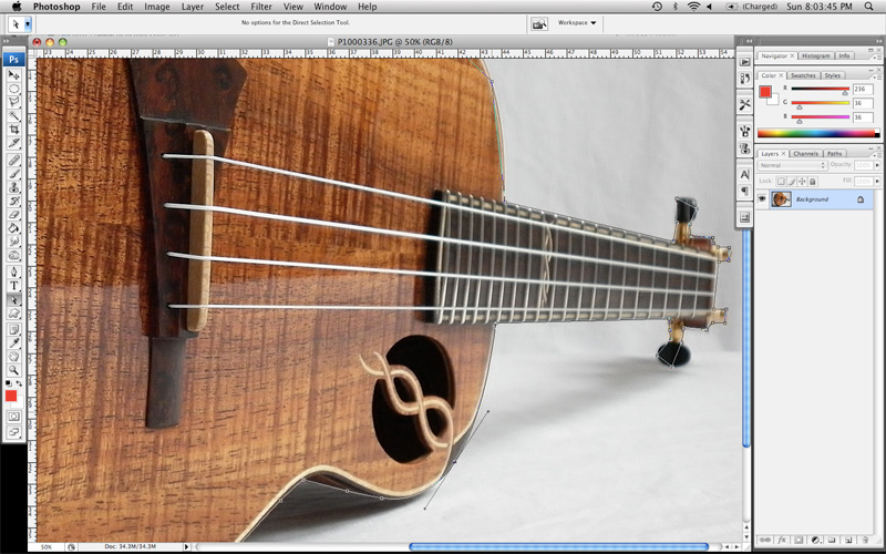

We need to create a path around the item, which is called deep etching. There is a fancy 'one click' tool to do this called simply 'Magic Wand', but don't use it! It's crap. Well perhaps it is not and has it's purpose somewhere but for this, you would be disappointed with the pixelated results. Choose the 'Pen Tool' which looks like the little 'Quill Nib'. You can see it 'highlighted' in use on the next image. I use this to place a series of points around the outline of the guitar. It pays to zoom in on the image here as you want to be able to see what you are doing. If per chance, your image starts to "fill" the area with a colour block, there is some extra tool options on the top bar. Hovering over them will tell you what they are. If this occurs, it is likely "shapes" is highlighted whereas you want "path" to be selected.

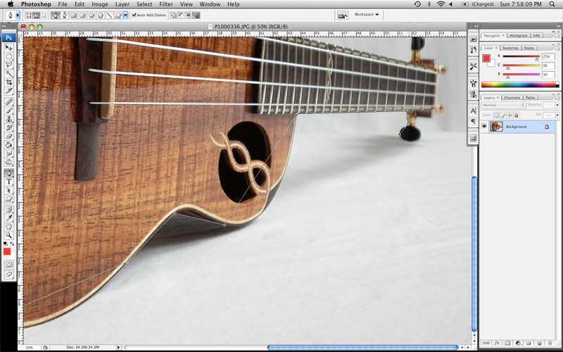

I place these points strategically all around the instrument, generally wherever the curve changes. You'll get a feel for where to place these the more you do and trust me - I've had a lot of practice... Carba-Tec catalogue anyone?? Yep, me... hundreds... thousands... for years... the dreams... the nightmares - doc they're bac... Ahem, erm sorry where was I? Oh yes, like I said - lots of practice... :roll: In any case, place these points around the whole instrument with a final click on your starting point to "close" the path you have created. Once you've done this, the path obviously needs refining to fit the shape of your chosen object. We do this by "right-clicking" on the path, between two points and selecting "add anchor point".
This drops another point on the path where you clicked, but importantly, it is a bezel curve with "handles" allowing you to adjust the curve to fit precisely. If it is not, you can right click the point again and change it to bezel or curve.

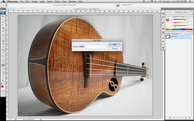

After which it is a matter of going around and adjusting your path to the outline of your entire object. It can be time consuming work, particularly with complex shapes, but it is worth the effort. When you are happy that your path fits the object well, you need to save it. On the right side of the screen, you have other tool and picture options. You can see on my pictures above, it has highlighted "layers". Next to this is a tab for "paths" and you need to select it. If it is not there on yours, it will be somewhere in those options so find it. Once you click this tab, you will see a thumbnail of your created path and it is called by default "work path". Right click on this and select "save path".

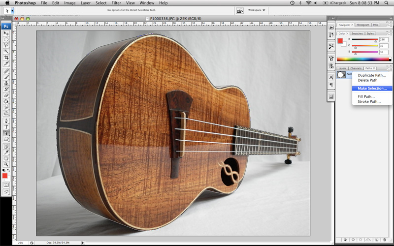

After you have saved the path, the name you choose is irrelevant, right click the new name under the tab and hit "make selection".
You have now selected you object separately to the rest of the image. You want to reverse that selection so that you have highlighted the background instead. You can choose the "select" menu at the top and hit "inverse selection" there, or by using shortcut keys. On the mac this is "shift+apple(command)+i); on the pc I'm not sure but probably something like "ctrl i) or similar. The flashing dashed line should now surround your instrument or object and the outer border of the pic like this.

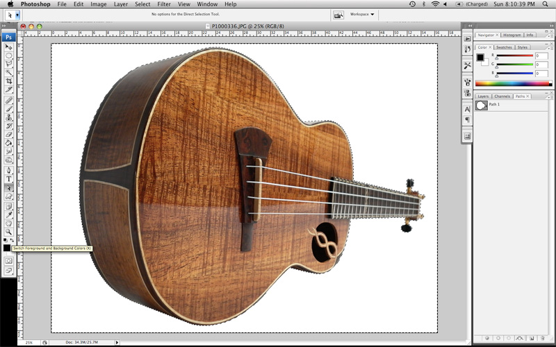

Then you just hit the "delete" button and it's done... more or less. :) If you don't now have an image something like this, or at least what you were expecting or hoping for, something has gone amiss. Go back and work out where it went wrong! Fortunately the same tab options on the right of the screen have a "history" tab which records your steps as you go - to a set amount. So you can literally just click back through these to see where the error was made and continue on from there again.
It will probably delete to white as your default colours are black and white - the two boxes at the bottom of the tools column on the left. You can change this to whatever you like from here and do anything... But I'm a bit old fashioned I guess and prefer to stick with black. 8) I just reverse the two colours in that box using the arrows beside them, select my path, inverse it and hit delete once more to get this - the finished product.
And there you have it. :gui
