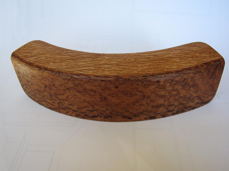

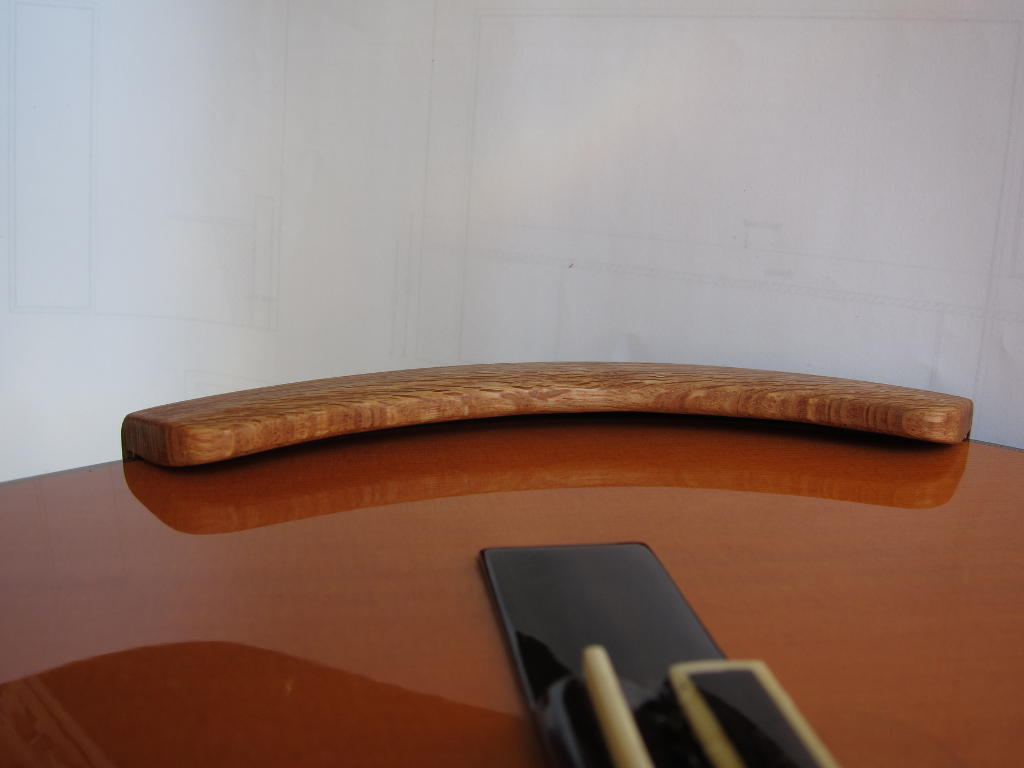

I recently made myself an armrest held on with rare earth magnets. It was pretty much a make-it-up-as-you-go-along sort of effort, and definitely capable of improvement, but here goes. The materials for an armrest were:

Note that the pictures show a left-handed armrest, as I play left-handed. Adjust accordingly for right-handed.

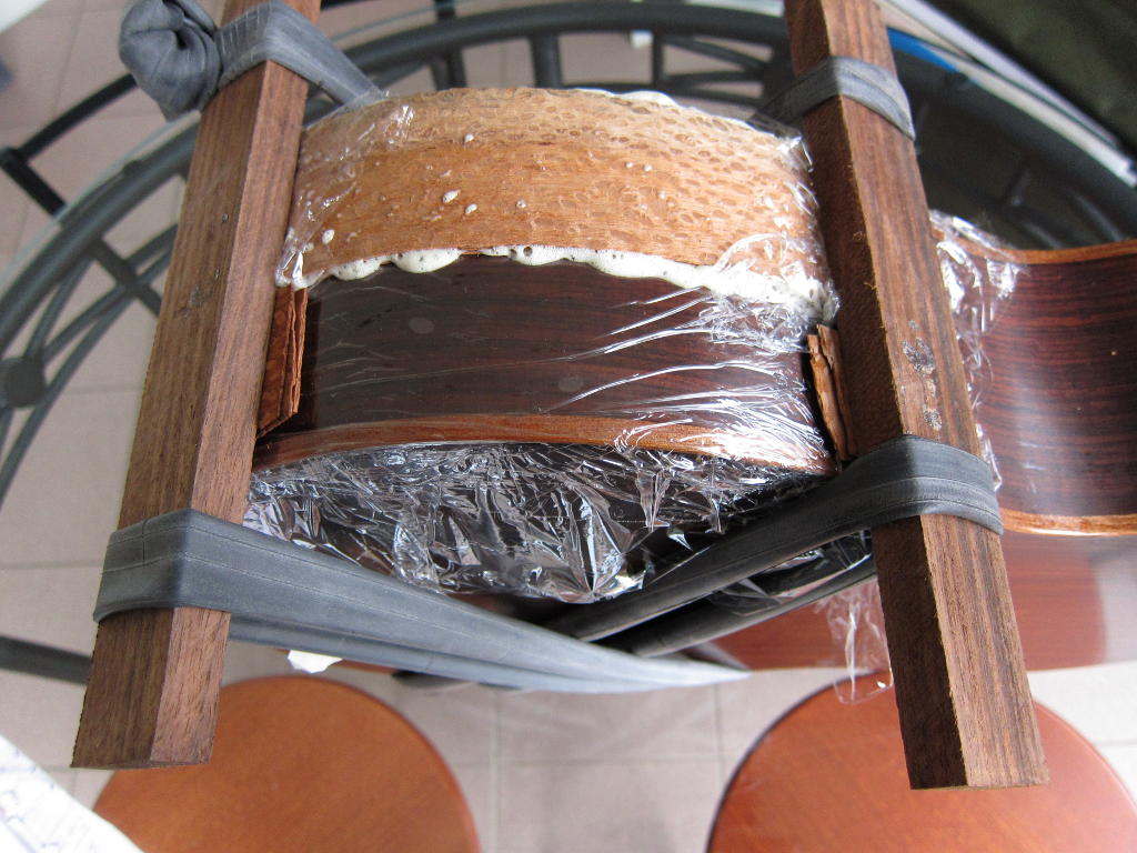

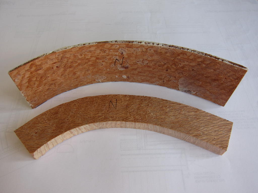

1. Cut three pieces of veneer, two long-grain and one cross-grain, to make a three-ply. I cut them to 220x55. You need to decide where to position them on the lower bout. For my purposes (playing classical guitar in the normal classical position), I decided that I wanted the centre of the rest to be slightly below the centreline of the bridge. When I take a line through the centre of the bridge out to the completed armrest, there is 110mm of rest below that line and 80mm above.
Glue the veneers around the lower bout of the guitar, using a couple of bridge blanks and some old bicycle inner tubes as clamps. You also need three small pieces of veneer as packing under the other side of each bridge blank to keep it square to the side of the guitar. I found I needed glad-wrap not only underneath the layers of veneer but also on top, as the glue migrated right through both the top and bottom veneers. To shorten the inner tubes to get sufficient tension for the clamping, I just tied a knot in them.

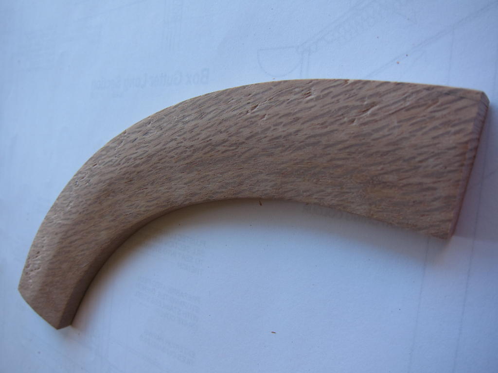

2. Clean up the veneer laminate and use it to mark the correct curve on the timber for the top of the rest. Cut to shape. I used a bandsaw, but a jigsaw or fretsaw could also do the job
3. Clean up the curved piece, making it a good fit to the laminate, and taper the inside of what will be the underside, to provide clearance from the soundboard. I tapered it down to about half thickness over 2/3 of the width. Check that the curve you have on the outside accurately matches the lower bout of the guitar

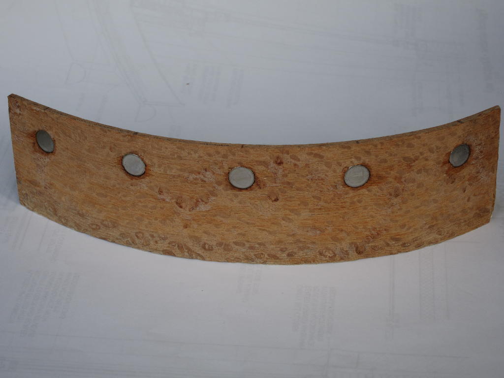

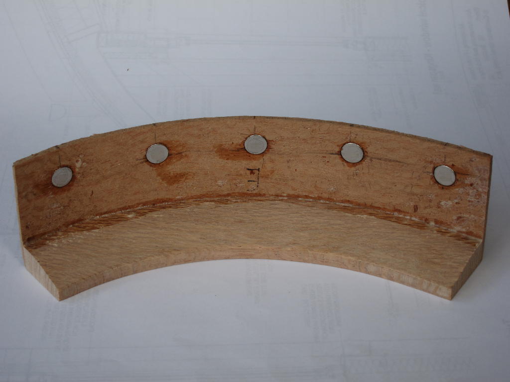

5. Drill 10mm holes through the laminate for five of the magnets, making sure that they are positioned so that their pairs inside the guitar will clear the kerfing when the armrest is in place. Ditto for their lateral positioning to clear any reinforcing pieces on the inside of the guitar. Push the magnets into the holes, make sure that they are not proud of the surface on either side, and glue them in place (I used superglue, running it around the edge of each magnet and letting it wick into the join).

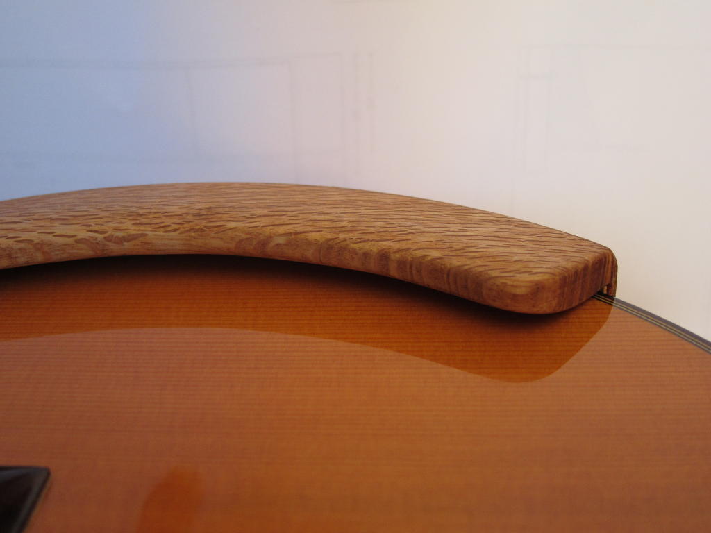

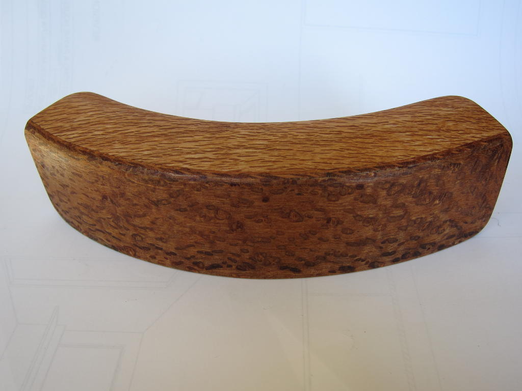

7. Taper and curve the outside of the top of the rest so that it slopes down towards the outside of the guitar; curve and clean the ends. To get the taper, I cleaned the excess glue off the top, scribed a line about 6mm down from the top, and then removed wood freehand on a sanding belt over the outer 2/3 of the top of the rest.
8. Fine sand and apply a finish. I used an oil finish as providing a surface that my arm would easily slide over.

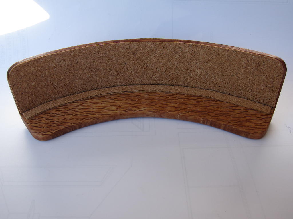

9. Cut and fit the cork sheet on the inside of the armrest to protect the finish on the guitar.

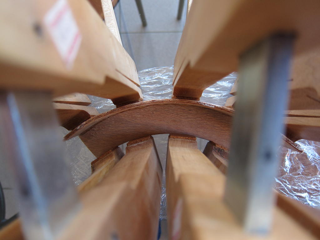

10. Position the armrest on the guitar and place the corresponding magnets inside to hold it in place. I was able to get my hand in far enough to easily place the first three - as soon as you get them close to the correct position they jump into place. The two at the bottom of the lower bout I couldn't reach directly, so to get them in place I put the magnet on the end of a bicycle spoke and manoeuvred it into position with an inspection mirror. It's not as easy as it sounds - if you let the magnet you're trying to place get too close to one of the already placed magnets, it flies off and attaches itself there. Once you get the magnet inside close enough to the magnet outside, it has a stronger attraction to the other magnet than to the spoke.
I haven't yet fixed the magnets in there so that they will stay in place when the armrest is removed - I'm still mulling over the best way to do that.
For the next one I make, I'll taper the rest part of the armrest more - this one looks too blocky. I also think that five magnets is maybe overkill. Three would probably be enough, and with a larger size (say 15mm diameter x 3mm thick, which have a pull over 50% greater than the 10mm I used), two might be enough.

p.s. I forget to say that I used contact cement for attaching the cork. Strong enough for the job and doesn't penetrate into the cork and stiffen it.
