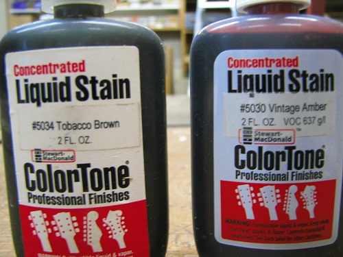

For the following Tobacco burst I will only need to use two colours, Tobacco Brown & Vintage Amber.
Stains used.jpg (84.24 KiB) Viewed 123746 times
I've shown the Stewmac 'colortone' product here, I'm not advertising or advocating their product specifically but I have found, personally, this to be the easiest and best product I've used in a liquid form. I have loads of aniline powders I've sourced and used, from several different suppliers, sometimes the powders come in a colour that just isn't available as a liquid (purple comes to mind although the Blue and Red does so I could mix my own if I had to I guess :oops: ).

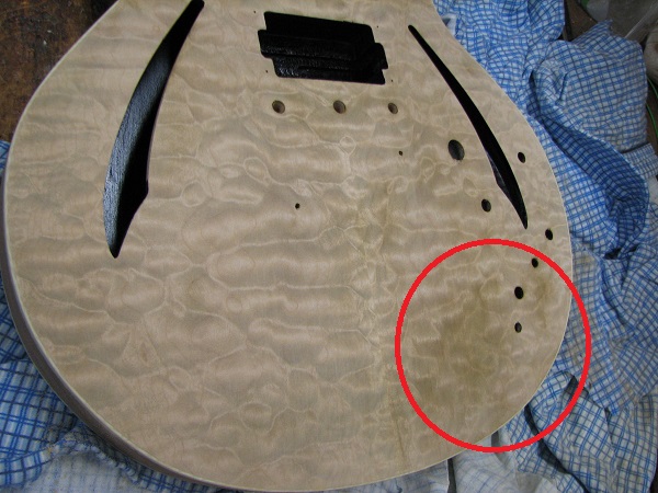

I want to grain enhance my water stained ( :wink: ) bit of Maple I used for the 356 build's top so first I played around to get the right mix of stain in order to acheive the right degree of enhancement on my top. To do this I used a bit of the scrap offcut.
For anybody that isn't familiar with grain enhancement, what happens is that by applying an intial dark colour, the end grains (the thing that gives the wood it's figure) absorb more of the stain than the normal grain. By sanding back we are removing the stain from the 'normal' sections (where it hasn't absorbed as deeply) and leaving the darker stain in the end grain thereby 'showing up' or enhancing these grain features.
For the darker stains such as a blue or red topped instrument (can be other colours but these are the main two), the grain enhancement stain can be just straight black but for the tobacco burst, whilst I wanted to be able to see the quilt figure I didn't want it too dark and dominant, I only want to enhance it not make it the main feature!

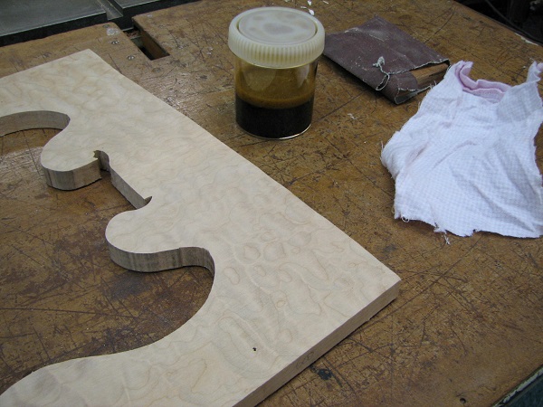

So to apply the stain on this job I need rag, my scrap (to get my recipe right) and the mixed stain and Latex or Vinyl gloves. The stain is a shit of a stuff to remove from your skin, it ain't called stain for nothing!
*Note*Some people would advocate wetting the surface of the wood first just with clean warm water to raise any grain 'hairs', I would do this if I was applying a burst or colour to the wood and not carrying out the grain enhancment stage first, it's not necessary in my opinion, if you wish to do this step then please don't let me stop you. Tailor things to what suits you best but you are going to be sanding anyway, may as well save some elbow grease!

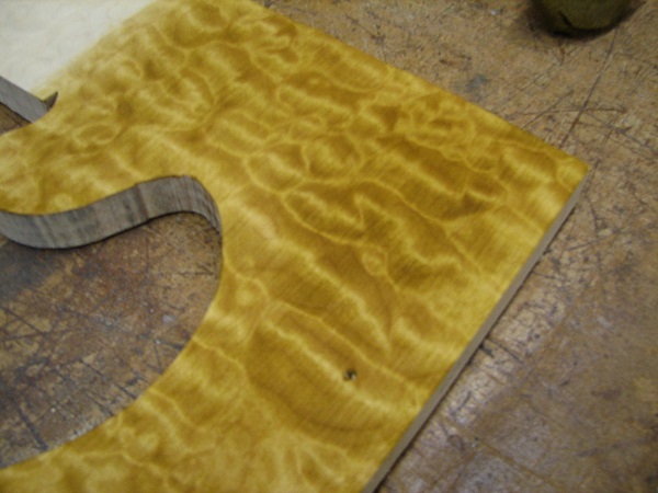

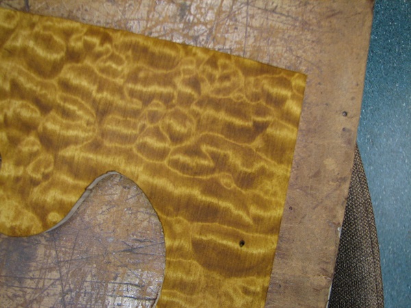

First we'll try a 2:1 mix of Amber against the Tobacco, twenty drops (the bottles come with a blank spout that you can cut the end off, I don't! I pierce the end with a 1.5mm drillbit to give me repeat results with all colours, one drop of one colour will be the same amount as one from another) of Amber and ten of Tobacco into about 100mls of warm water and with a clean rag I just simply wipe it onto my surface, no particular direction i.e you dont have to wipe with the grain, infact circular motions are better for blending & stopping from getting dark lines of stain forming on the surface. If you do get dark lines of stain on the surface you can counteract this easily but more on that later...
One application of the 2:1 mix
2 to 1 mix.jpg (85.16 KiB) Viewed 123746 times
Hmmm it's OK but still not quite what I'm after, I can sure see the quilt but it isn't quite prominent enough for what I want (ignore the straight lines running with the grain, that's just from the 80 grit in the thickness sander), remember that we will be applying the Vintage Amber and Tobacco brown later over the top of this so things could get lost if they are too subtle.

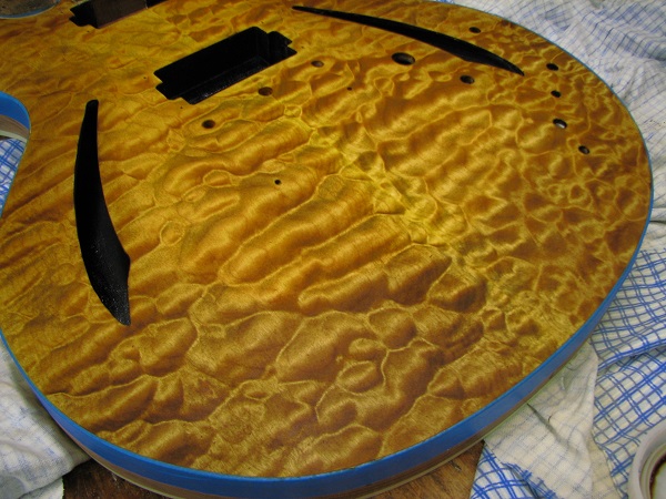

Lets up the mix by adding another ten drops of the Tobacco to the brew so now we have a 1:1 ratio.
1 to 1 mix.jpg (109.77 KiB) Viewed 123746 times
Much better, this should show the quilt under the other colours without being too "in your face" :D

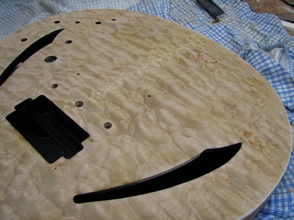

Using 240grit, I sand with the grain until it looks like I've removed all the stain from the surface of the wood. I want the Maple to look evenly white across the surface, here you can see a slightly darker patch (circled), this needs further sanding or it will mix with subsequent applications & I'll end up with an uneven colour in my Amber base coat.
Body rubbed back- blotchy.jpg (115.44 KiB) Viewed 123746 times
Job done and ready for the colour coats to go on :D
Body rubbed back.jpg (108.1 KiB) Viewed 123746 times

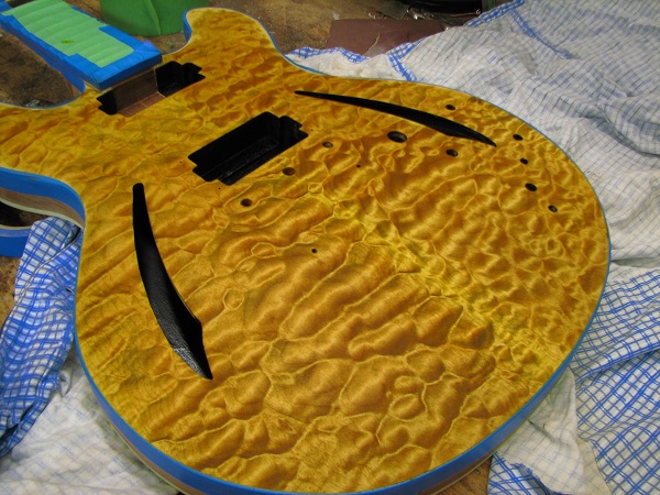

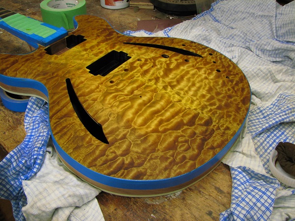

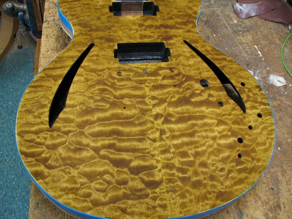

Next I need to apply the Vintage amber base, I'll mask off the fingerboard and front binding before I apply the stain. I'm only masking the rim purely to stop any stain 'accidently' getting absorbed into them from any overhanging rag! I also prefer to use the Blue painters tape, this has a smoother surface than the traditional white masking tape so doesn't allow as much bleed under it.
A quick note about the use of plastic bindings! If you scrape your bindings you will end up with a smooth surface that won't "take" any stain and any bleeding of stain onto the bindings can be easily removed by a light scraping or wiping with clean water afterwards. If you've sanded the bindings, you've introduced numerous scratches that stain just loves to sit in and so you have to scrape a fair bit of binding to remove the stain lines ( I found this little tip out the hard way when I first started using stain! :oops: ). So if you can, go with scraping plastic bindings at all stages.
I've mixed up a batch that is about 25 drops to a 100mls of water, this can be tweaked to suit (as I did) and while the application is still wet it gives you a good indication of what it will look like under finish so you can adjust as you go if need be. I apply one coat by usuing a new piece of rag and again a circular motion, blending in any streaks or dark lines as I go, what we are after is an eveness of colour. It wasn't quite the depth of colour I wanted so I added another 10 drops to the brew and let the first application partially dry off. This only takes a matter of minutes for the surface to appear 'dry'. This is a good gauge of how wet you are getting the surface, if it takes an age then you are applying too much stain & therefore water!
Another application and I have the look I'm after
Vintage Amber 2 coats.jpg (143.24 KiB) Viewed 123746 times

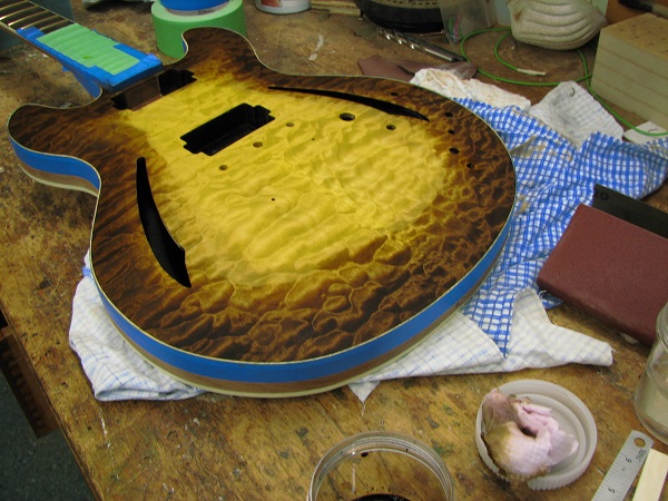

I'll repeat the process for the third coat moving outwards even more, what we want is a progression of this shading without any obvious changes in shade.
Tobacco brown build third application.jpg (141.7 KiB) Viewed 123746 times
If you do get a bit of a line between each application just use the clean water to blend it out, don't use the stain rag to do this as it will add more colour. Dip a clean rag in the water and squeeze out any excess, we want it damp enough as to not 'drag' on the surface but not so damp that it leaves glistening pools on the wood!
Time to let all this dry out again and mix up some 'pure' tobacco for the edge. I mixed up a batch similar to the Amber i.e 25 drops to 100mls of water, I can always add to it if it's too weak or dilute it if it's too strong.
Ok, with my now dry body ( :shock: Can't say that on too many forums and get away with it!) I'll start applying the Tobacco edge. It's very much a matter of personal preference as to how wide this edge is but I go very much by eye until what 'looks' right.

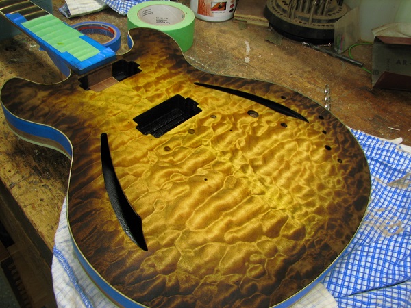

The next step is one of the beauties of using water based stains, you can either blend while it's still wet or let it dry. Even if it was left overnight one wipe with a wet rag and it will 'reactivate' it and it will become workable again (you may end up with a hard line right at the edge of the dry stain but a good rub with the damp rag will dilute this line out). I prefer to do it while it's still wet but it's a personal choice or maybe time restrictions interfere.
The rag I use for the clean water I will rinse out if I used it in the previous applications so it's clean once again and squeeze it out so it's not too wet then using a small circular motion, I'll rub around the line between my tobacco/amber and pure tobacco applications. Blending in the darker edge in with the not so darker tobacco/amber mix. Don't let the rag get too dry during this stage we want it about as wet as if we are applying stain otherwise the blending doesn't work out so well.
Keep going until you are happy with the merge, again it's a personal preference.
Tobacco line blend.jpg (132.62 KiB) Viewed 123746 times

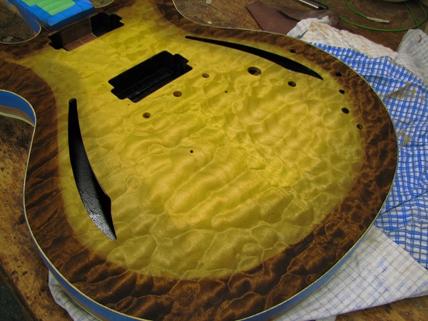

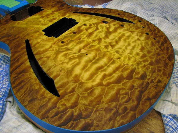

Still a little 'light' right out by the binding, I plan on going fairly dark with the sides and back so I want the immediate edge on the top to be as close in colour as possible. So I just keep adding more applications until I have the colour I want. I let the last couple of applications dry off overnight in between as doing it wet will just 'shift' the colour about and won't actually darken it.
Darn near complete.jpg (142.84 KiB) Viewed 123746 times
So now we are pretty close to what I'm after, I did one more application after this photo was taken and kept it fairly narrow just to darken that edge a little more.

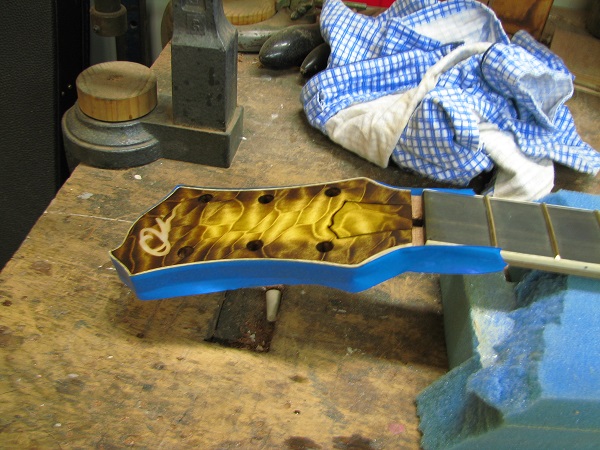

Ok, I forgot to mention that because I'm using a maple headstock I burst this at the same time in order to get things all looking the same.
What you do to the body you do to the headstock!.jpg (132.67 KiB) Viewed 123746 times
Once I'm happy with my burst I spray a couple of good coats of clear over it. 1) It "locks" in the burst and 2) it allows me to give it a light sanding and get any extrenuous nibs of the grain that may have been raised during our bursting.

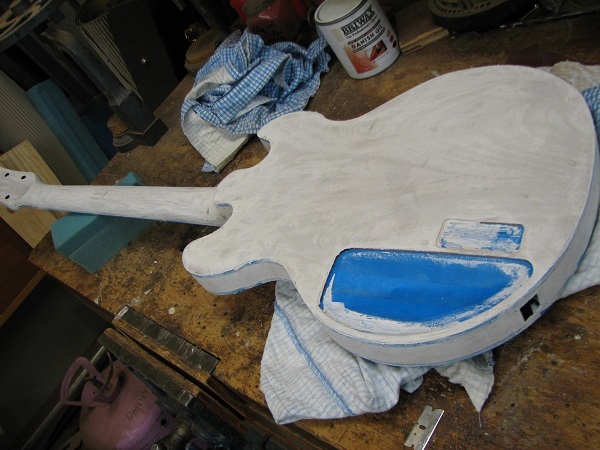

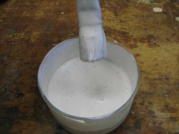

Now we to move onto the back & sides. First I need to pore fill, for this I use a neutral water based pore filler. For this job I will be colouring the filler once it's on the wood and sanded ready for staining, there is nothing to stop you adding stain to the filler prior to filling though, should you want to.
For the pore fill I will be using the "colortone" water based filler but from everything I've researched about it, it is identical to locally (Australian) made "Timbermate" wood filler (I'm even wondering if Stewmac get it from Timbermate's manufacturers and sell it under their own colortone label?).
Anywho, which ever brand you use, it will need thinning with approx 10% water to get it to the consistency of bottled cream (not whipped!)
pore filler.jpg (93.12 KiB) Viewed 123746 times
I just quickly masked the majority of the binding with the paper masking tape just reduce cleanup at the end!
in the white.jpg (108.16 KiB) Viewed 123746 times
Filler applied and left to dry, I guess this is what they mean by wood "in the white?" :wink: Once it has thoroughly dried I sand it off with 240 grit and move to the next stage of the job.....staining the back and sides!

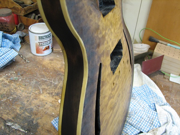

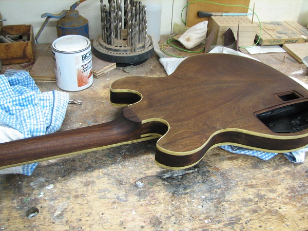

I want a nice dark tobacco colour for this so I up the ratio of my Tobacco stain by adding another 25 drops to the mix.
Even though,as I said, it's easy to remove stain from plastic bindings I'm all for making life a little easy for myself & still mask the bindings just to reduce the amount of cleaning up I'll need to carry out. I usually like to use 3M's 471 blue vinyl tape on the bindings. This comes in several different widths starting at 1/8th and goes up from there. It's flexible enough to wrap around the tightest of bends and adheres well to the binding, it'll even stick to the curves on the front face too.
But for this one I got hold of some 218 fineline Vinyl tape that I thought I would try, according to the shop where I got it, it's supposedly the same stuff all bar the colour. Plus you got twice as much on a roll.
New Tape.jpg (124.25 KiB) Viewed 123746 times
I didn't like it! :shock: When it came in contact with water in the tighter area's where it was under the most pressure to stay stuck (inside the horn area's) it came unstuck leading to stain bleeding onto the binding. Plus, unfortunately, it was/is a beige colour which was close to the ivoroid colour which made picking up the exact bottom edge of the binding quite difficult for my diminishing eyesight :oops:. But I got there eventually
Bindings masked.jpg (135.7 KiB) Viewed 123746 times

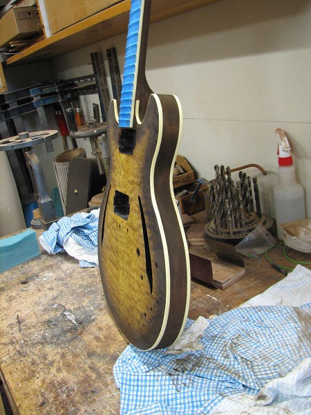

Once I had everything I didn't want coated in Tobacco stain covered up, it was just a simple matter of applying the stain.
First two coats.jpg (141.22 KiB) Viewed 123746 times

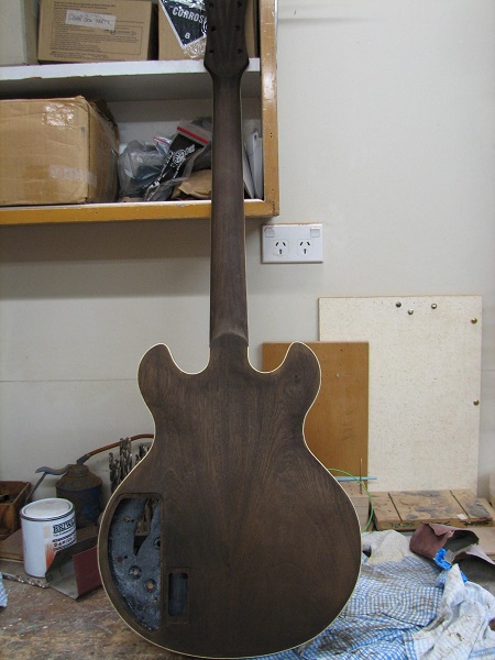

After the first two coats (allowing it to dry completely between applications) it still wasn't as dark as I wanted so I'd add more applications until I have that nice dark brown I'm after.
Colour Match.jpg (119.2 KiB) Viewed 123746 times
Nice and dark and it fits in with the edge of my burst

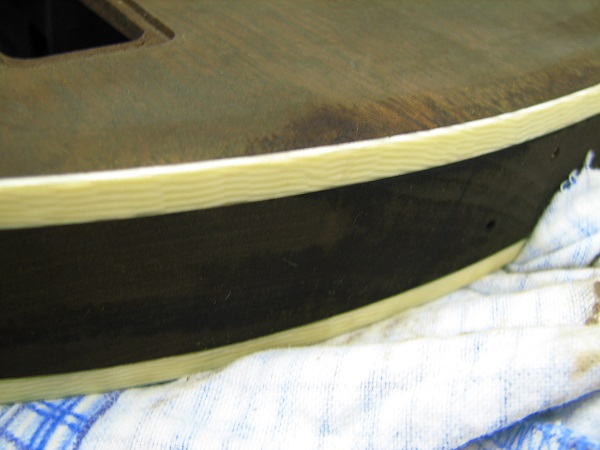

There were a couple of problems I ran into, but they both highlight the ease of using water based stain! One was that after it had all dried off & I'd removed the masking tape, I noticed a small area on the neck that I'd missed :roll: Adding colour to an already stained piece of wood is a simple mater of applying more stain over the area, it blends in readily and is much easier to 'patch up' than colour in the finish!
Missed colour.jpg (58.59 KiB) Viewed 123746 times

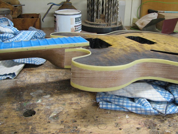

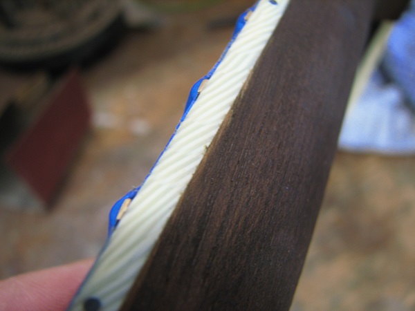

The other was, as I've already pointed out, bleeding under the masking and onto the binding, this was especially obvious in the area of the horns.
Binding bleed.jpg (77.96 KiB) Viewed 123746 times
This can be easily taken care of though by using the 'clean water' rag and carefully wiping the binding with warm water to remove the bled stain.
Binding cleaned.jpg (68.83 KiB) Viewed 123746 times

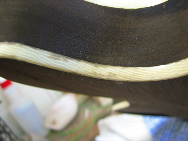

If you encounter any stain that has gotten into the binding then you will have to scrape but bare in mind, scrape too much and your 1-1.5mm wide binding edge will quickly become thinner!
That is pretty much it for the staining now except I felt, even though the binding is already a creamy colour, against the darkness of the brown it showed up as being quite stark and almost white. I decanted a small amount of my Vintage Amber and mixed more water with it so that I ended up with a really weak mix and whiped the bindings with that, just to 'age' it up a bit and take some of the whiteness out of it.
Binding Tinted.jpg (70.45 KiB) Viewed 123746 times

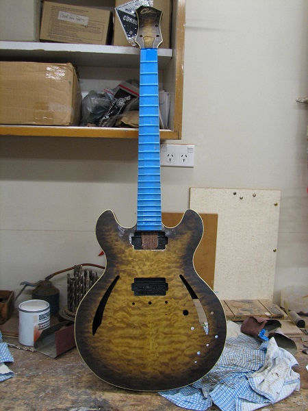

All ready for spraying the top coats. (the top looks 'dull' because I've already sanded it back ready for top coats)
PrePaint 2.jpg (117.84 KiB) Viewed 123746 times
PrePaint 3.jpg (130.48 KiB) Viewed 123746 times
So that is basically how I execute a tobacco burst. Next step will be to spray the topcoats, I won't show that because I think most of us know or can find out how to carry that step out.
