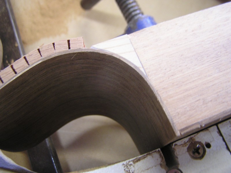

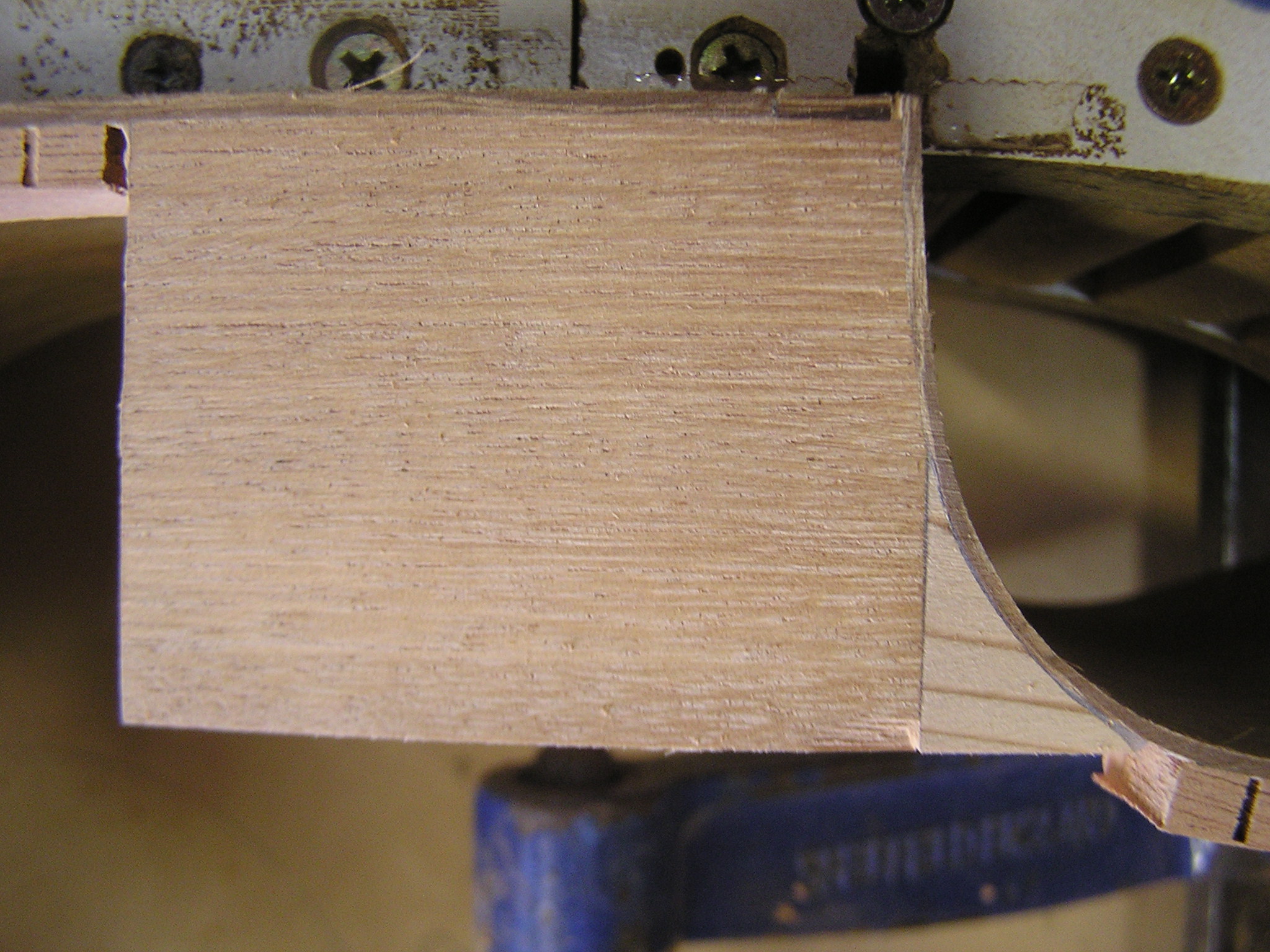

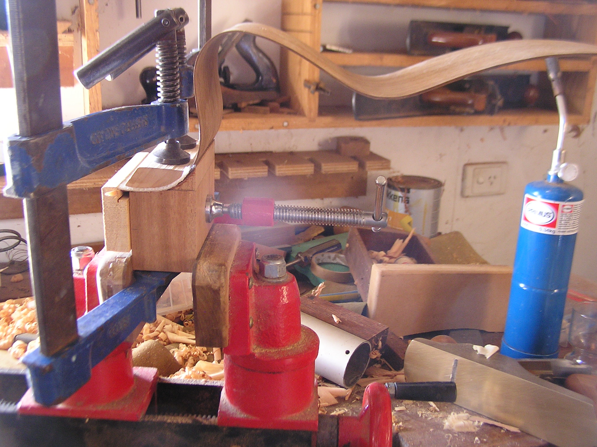

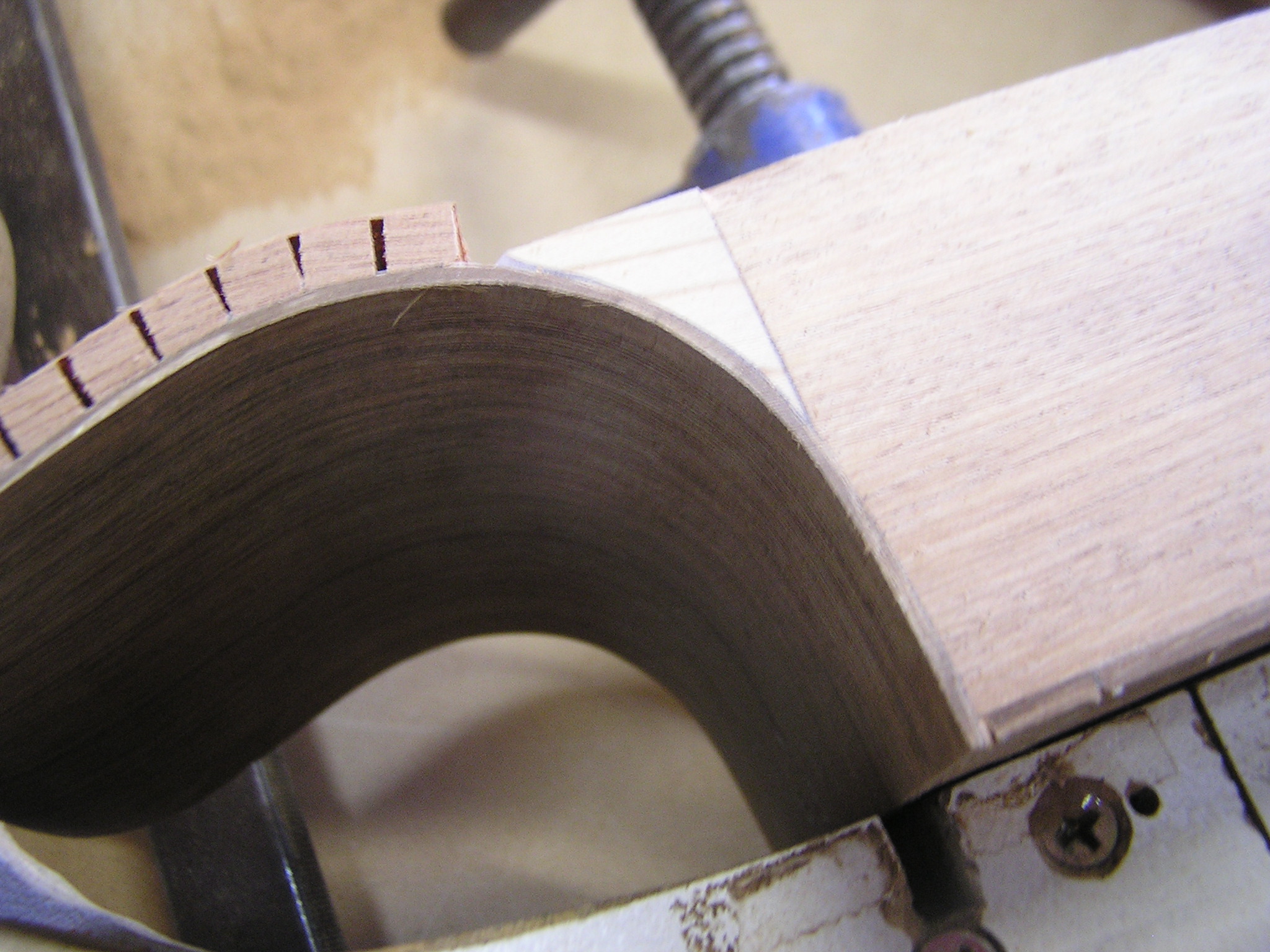

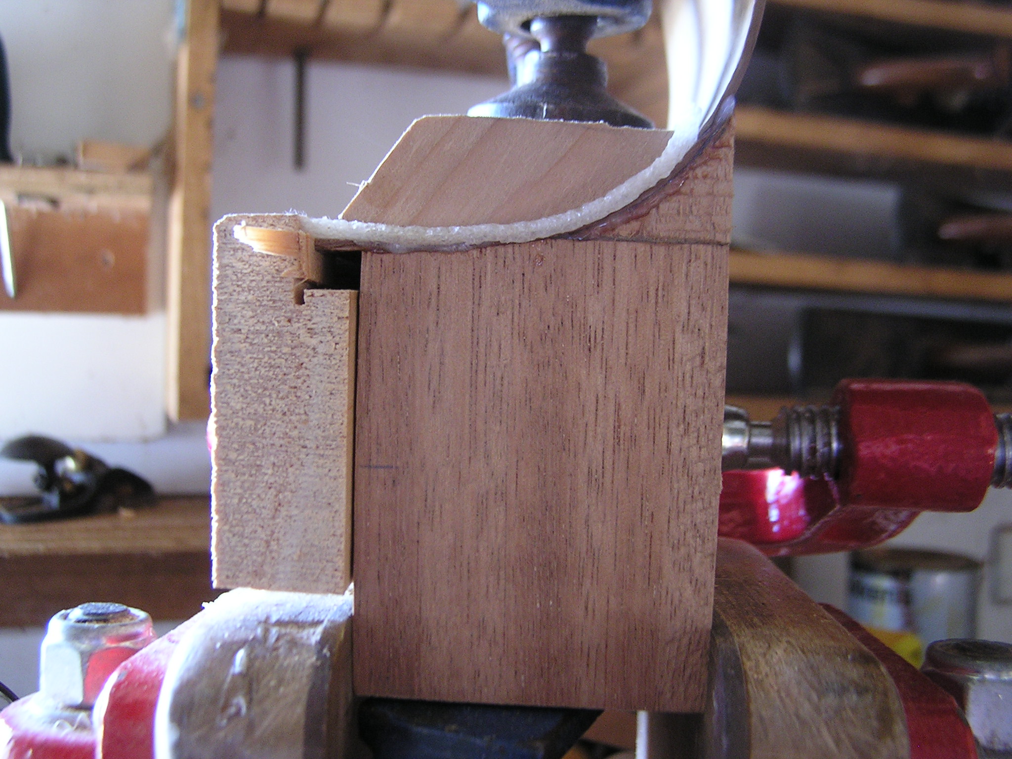

Post by woodrat » Wed Aug 21, 2013 5:43 pm

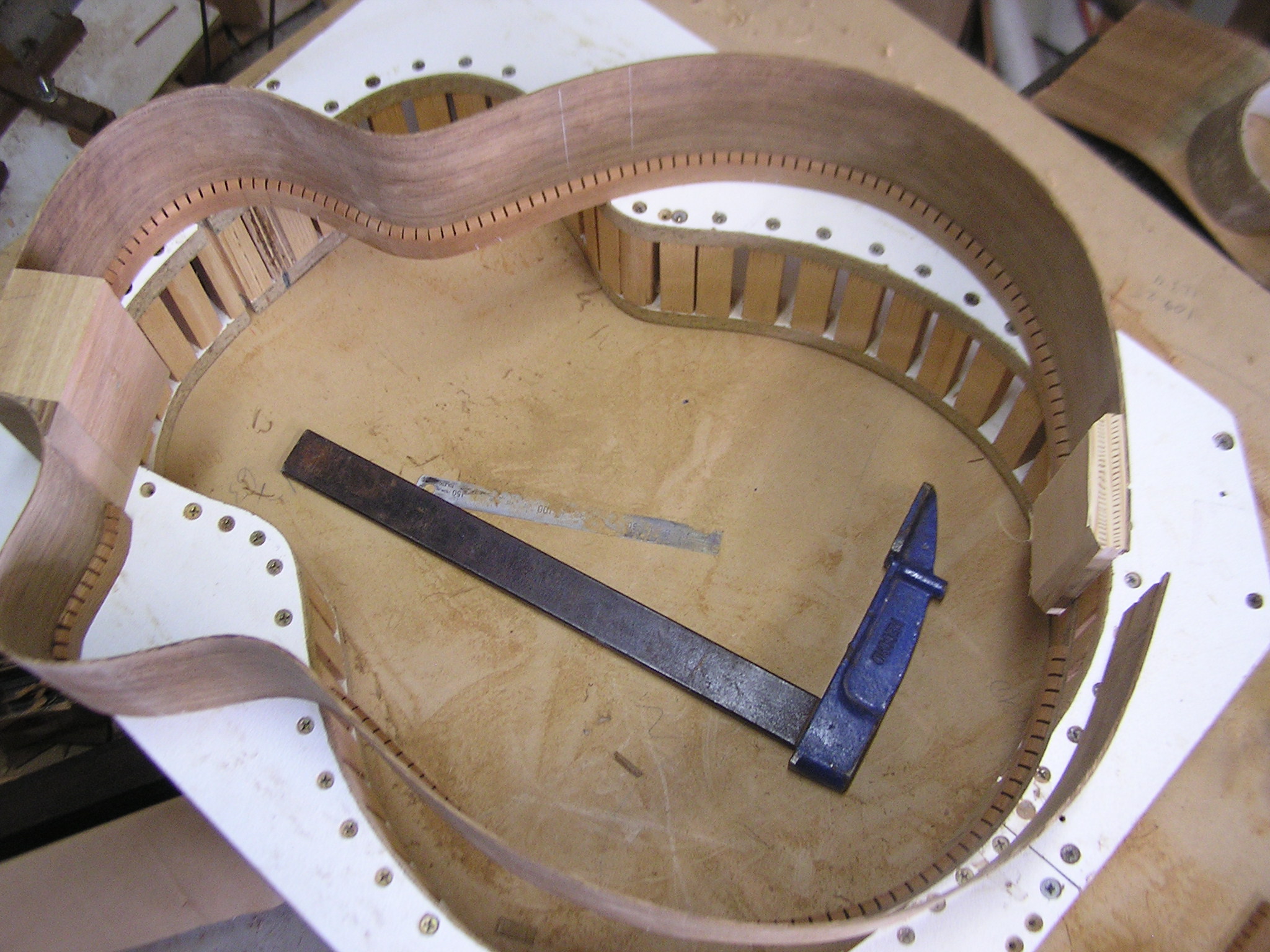

I am making a new Wenge Om with a cutaway so I thought that I would show how I skin this particular cat. Firstly I make the head block by gluing a piece of WRC to the side of the head block to act as a support to the cutaway side. I use Techniglue for this as it is an end grain to end grain gluing application. Then I put both sides in the mold and I place it over a piece of paper and scribe the cutaway shape onto paper and then cut it out and overlay it on the head block and trace the shape out and then bandsaw and sand to exact shape and fit. I put it back into the mold and get it fitting perfectly and then I draw some reference lines so I can glue the head block on in the right position when I glue it out of the mold. I then make a stop so that the side does not slip off the head block and I can clamp it with confidence. I make a caul from the head block offcut and I use a piece of thin foam between the caul and the surface of the cutaway to distribute the pressure more evenly. I use the type of foam that you get when you unpack a new electrical appliance....it is fairly easy to come by anyway... Clamping is then just across the head block as per the pictures. I use Techniglue for this as well.
I know there are many ways to divest a feline of its fur and this is but one of them....I hope that it is helpful to someone....:)

Bruce....I didn't go to the Nationals...I was planing to go to the UK and I decided to give it a miss this year....Would have loved to go but I couldn't make it all fit in...With regard to the head block....I use a standard dimension head block and glue on to it with WRC as it is easy to shape. The cut starts in the head block and then goes into the cedar...care must be taken to get a smooth transition between the hard and soft material but can be done with care (like all lutherie I suppose)
Steve...I am happy with this venetian....if you dont get it right it can look a bit naff...I have been working on getting the proportions right and then the bending just right....I thinned the cutaway part down to 1.5mm to make the bending easier.

... Bruce, another reason I do the head block that was is because I want to increase the glue surface area as an insurance....:)

...the glue up complete...
Re: How I glue a cutaway side to the headblock....
Post by woodrat » Thu Aug 22, 2013 12:45 pm

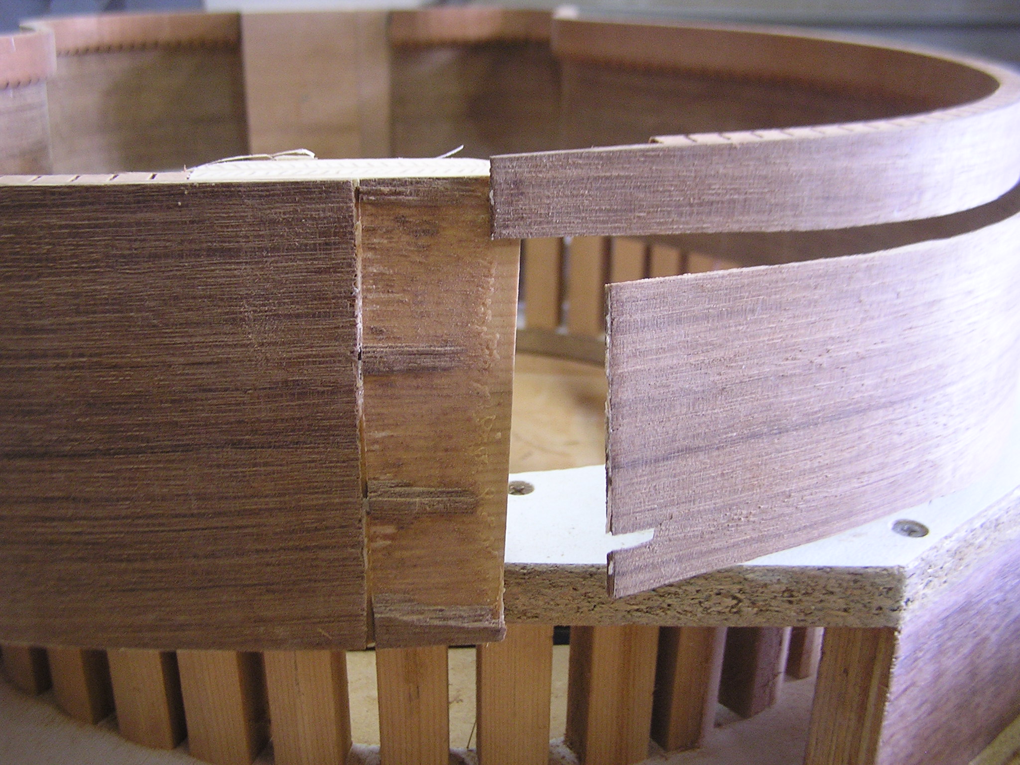

...well all was going well...until I had a little accident on the way to the radius sanding machine... :(
I sand it in the mold and I clamp the head block and the tail block with clamps and have a stretcher at the waist. The clamps I was using are the Record bar clamps (cramps?) that you see in the pictures. Well I am not sure exactly what happened but the clamp came undone when I was not expecting it to causing the whole assembly to fall and subsequently catastrophic damage was visited upon what was a project that was coming along nicely.... :oops:
Anyway what I have learned from this experience is just how weak Wenge is in and along the grain. I know that quartersawn timber has a tendency to split along the grain but this tore like paper and the grain that was glued to the tail block just popped off leaving all the glue behind. Wenge is a favorite of some pretty high end builders at the moment but with this experience I am a bit wary of it . The Wenge I have is perfectly straight and quartersawn and about 25 years old at least. I was looking forward to using it but there you go...lesson learned...well two actually....also dont use the bar clamps use a G clamp next time!!!! :evil:

Hi Steve....I like to always take a positive out of situations like this.....I learned something about Wenge that was better learned at this stage rather than later in the construction or after it was finished....I was really surprised how the side popped off the tail block...it wasn't like the thing hit the floor....I was just offering it up to my sander and the bottom of the clamp slid down the bar causing Muggins to lose control and it slipped about 6 inches to the bench the sander was on and that was the result...when I examined it I saw that the glue had either not penetrated the Wenge to any great degree or the face grain was so weak that it gave way or a combination of both...anyway enough for me to choose another timber instead....
