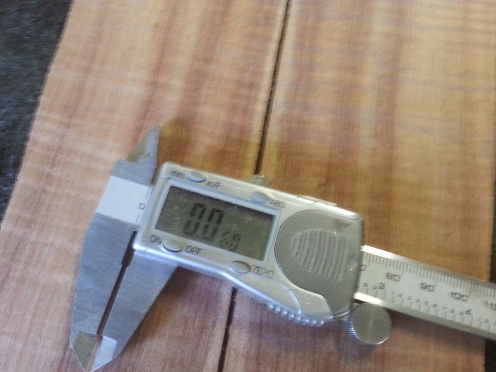

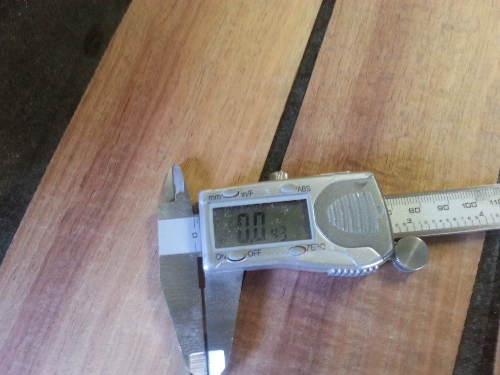

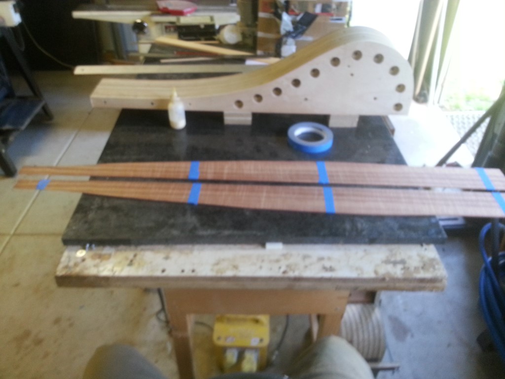

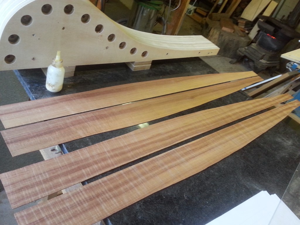

Profile and thickness the two sets of sides
The internal side set is a plain set of Blackwood. In fact these ones have a small (but solid) knot in them. I thickness these to around .040" (1.016mm)
The outer set, which is highly figured is thicknessed to around .060". (1.524mm) I leave these a little thicker to allow for sanding. So the final thickness will be a little over .10" (2.54mm), which is a little thicker than most single sided guitars. They also have more mass.

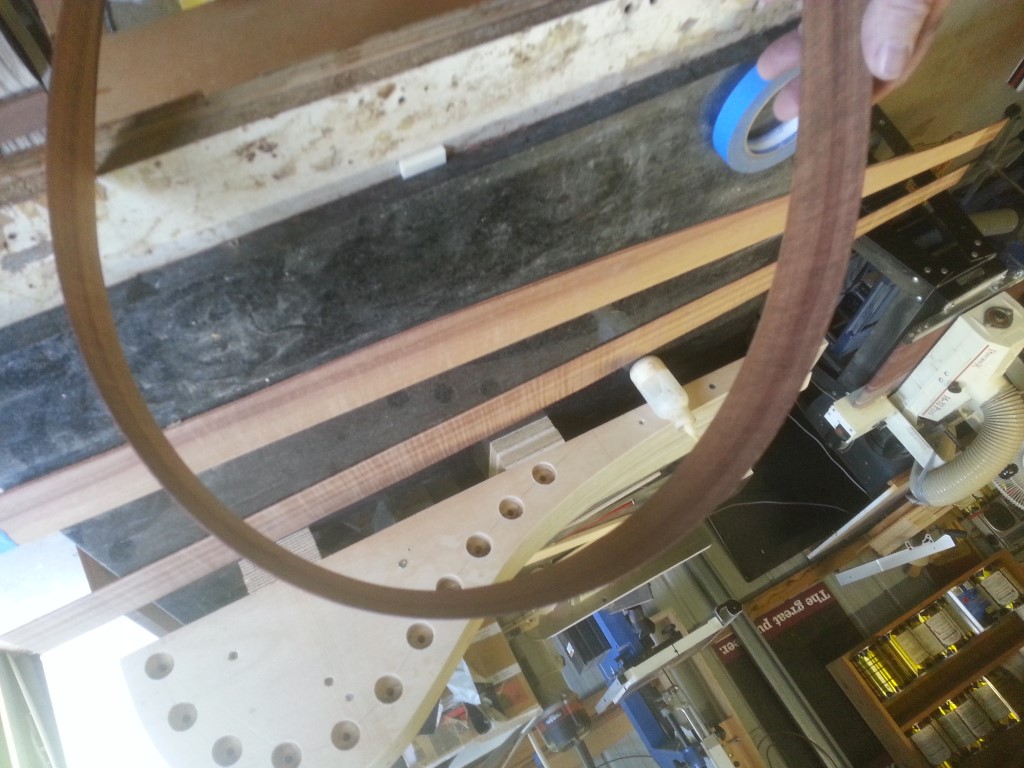

You can see that at these thicknesses the sides are really flexible you are not going to break even the most highly figured timbers.

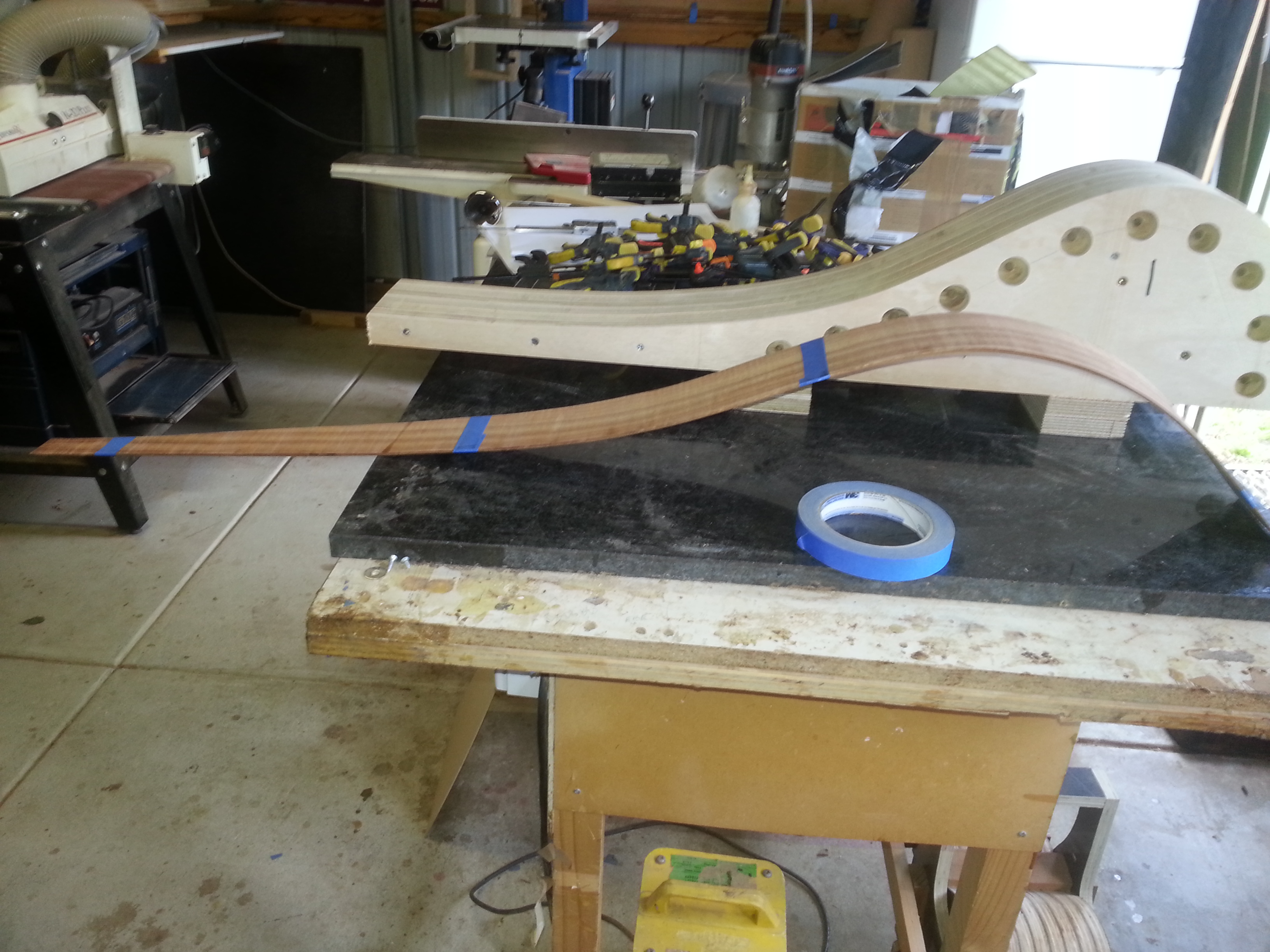

Now tape the sides in pairs and put them in your bender as if you bending a single side. Because they are so flexible the temperature does not need to be that high. I usually let it get to about 100C and then turn it off while I get the clamps in place and then turn it back on to give it a final blast. I use a couple of stainless steel slats with the wood sitting under the heat blanket. I wrap the wood in paper to keep the Blackwood away from the stainless steel so it doesn't get the green discolouration.
And I don't use any water.
This is great because there won't be any discolouration or rippling in the sides due to the water.
You can see there is considerable springback when you take the sides out of the mold.

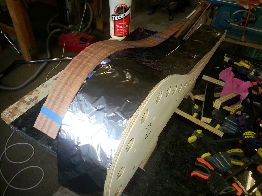

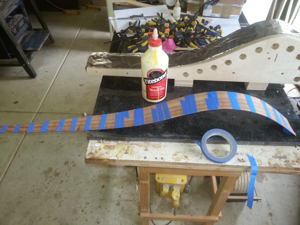

Next get some aluminium foil and place on the mold to prevent your sides getting glued to it.

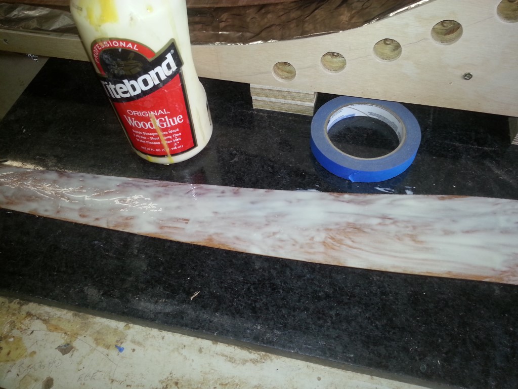

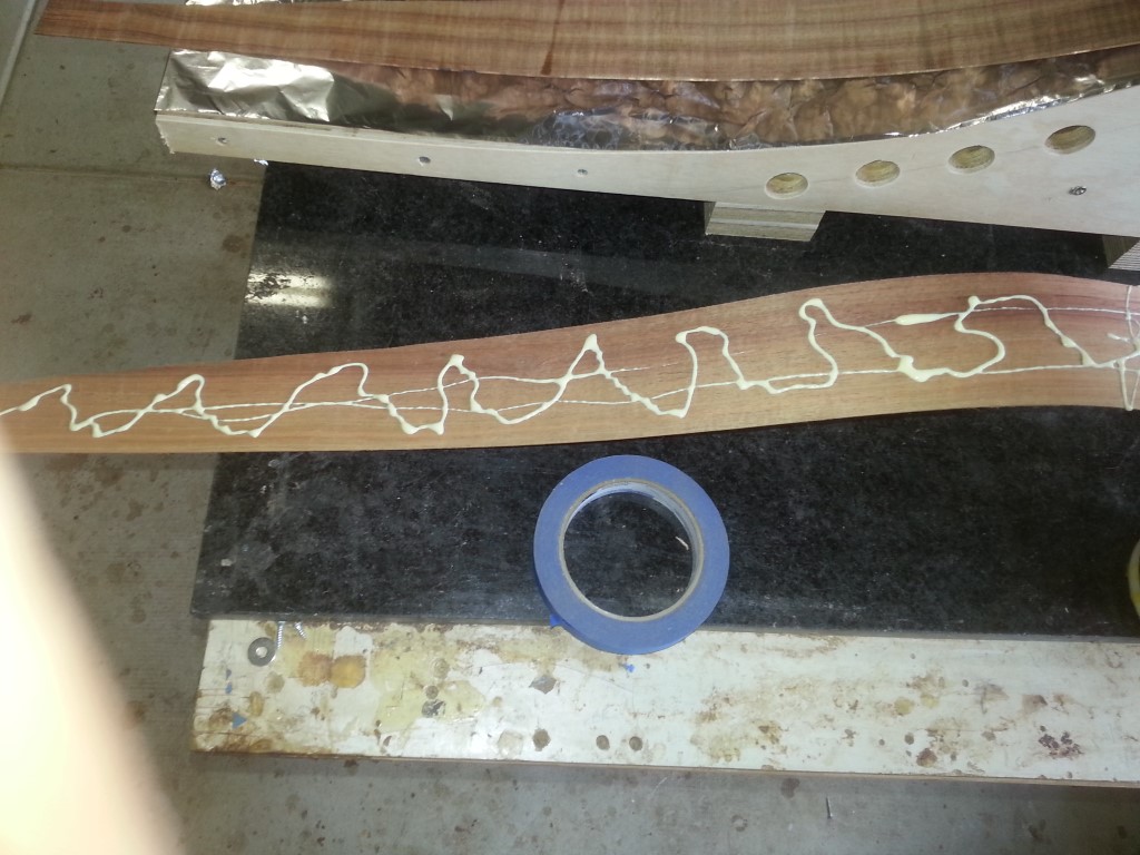

Now put some Titebond on and spread it evenly. I use a rubber glove on one hand to do this step.
This next step is the most important of the entire operation.

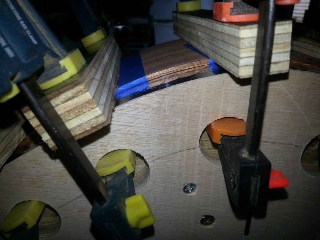

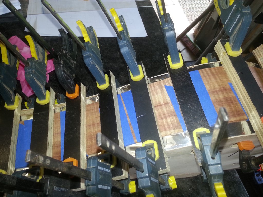

Tape the sides together with blue painters tape and ensure that there are no gaps between the two sides. The tape can be as close as want to put it but 1" (25mm) should do the job. Make sure you pull those sides together as tight as you can.

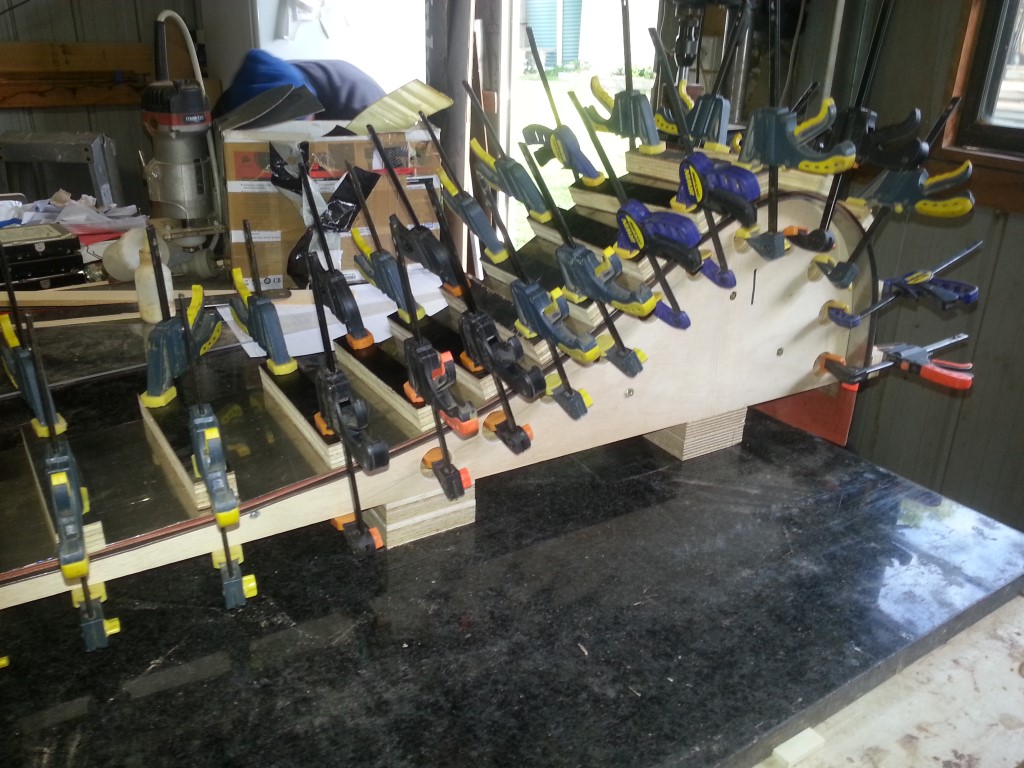

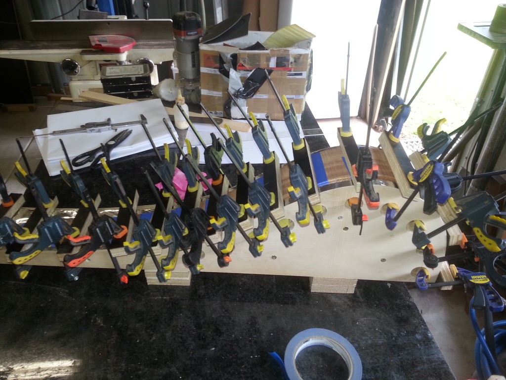

Now put the sides back on your mold but don't use the stainless steel slats.
There shouldn't be any gaps. if there are we can fix them once the sides come out of the mold but you can't leave the gaps as you'll either sand through or you'll have bits of the side flying everywhere once you start routing the binding ledges.

On the 4th picture where you are flexing the 'slat', how did you manage to stand on your head long enough to take the pic?

Photo 7...there's an opened box in the background......details please!!

The opened box contained several items that Kim Hickey gave me while I was in Perth recently.
1. the vacuum jig that the Canadian bloke Bob Garrish made for us a few years ago. I got mine modified so it would work properly and then sent it to Kim. I got his back so I can also get it modified.
2. Some new jaws for those pattern makers vices a few of us got from woodworker.com made by Kim.
3. some primo leather for the above mentioned vice
4. a nice set of fret pullers beautifully ground and polished by Mr Hickey
5. some giraffe bone.

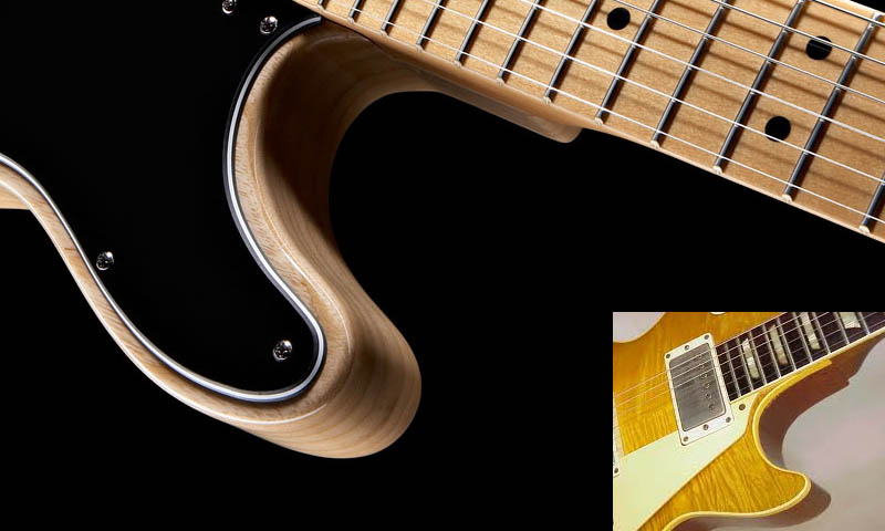

I had my first 'crack' at bending sides today. I didn't put them through the thickness sander as I wanted to see how maliable they were at 2.4 mm (thick I know). If I were to what bob has done in this tute do you think the sides would be flexible enough to bend & then laminate into a form as tight as say a Tele or Strat horn/ cutaway or even a les paul cutaway? Or are these forms too tight to bend on a hand pipe???
I ask as I've seen plenty of hogged out classic factory leccy builds but not many with bent sides..same goes with les pauls/ strats. The best examples I've seen have been on Stuart Eadie's Site.
Stu
Stu
- Cutaway.jpg (76.5 KiB) Viewed 48083 times

Re: Double (or laminated) sides -
You should be able to bend some timbers to a tight curve like that in a Tele or a Strat.
The pic below is a mando so the cutaway is quite tight. That was bent on a pipe with figured timber with the thickness a little over 2mm.
Mind you that particular piece of Blackwood was quite malleable. I have other examples of Blackwood which are no where near as accommodating.
Double sides lend themselves more to heat blankets. They won't retain their shape until they are glued.
