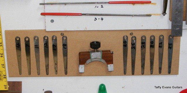

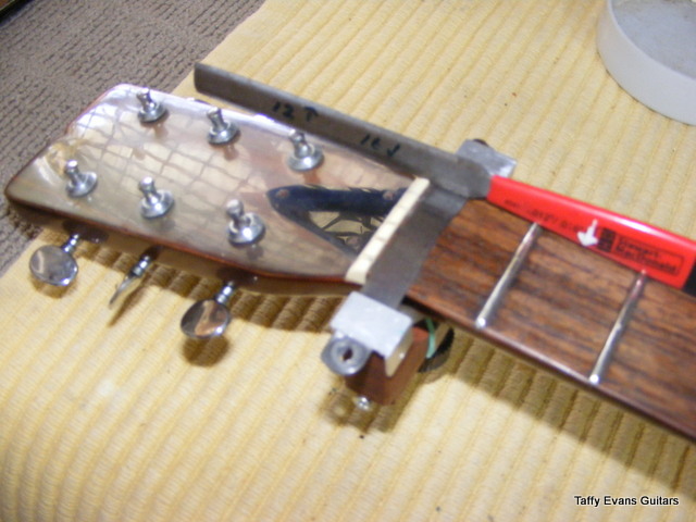

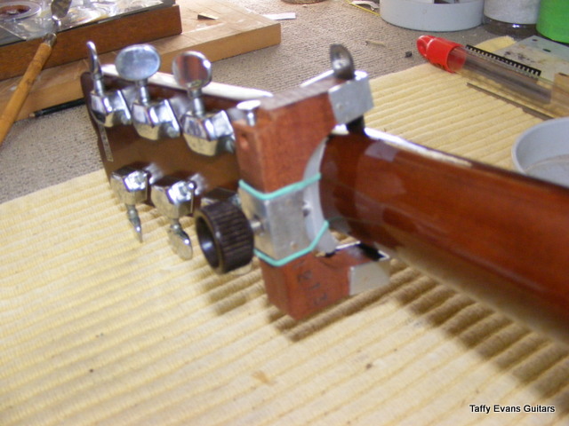

I also saw the nut slotting aid in the Stumac catologue and as I needed a break from guitars I thought I would make my own.
I do use feeler gauges at times especially when I or the customer need to know a particular setup's details, but usually I use the "feel and eyeball" method, a lot quicker but then I cant give the customer the spec's. Any way the project wasted an hour and if I need it I've got it. So first stop is the "gonna use scrap bin", and what I got is what you see here.
