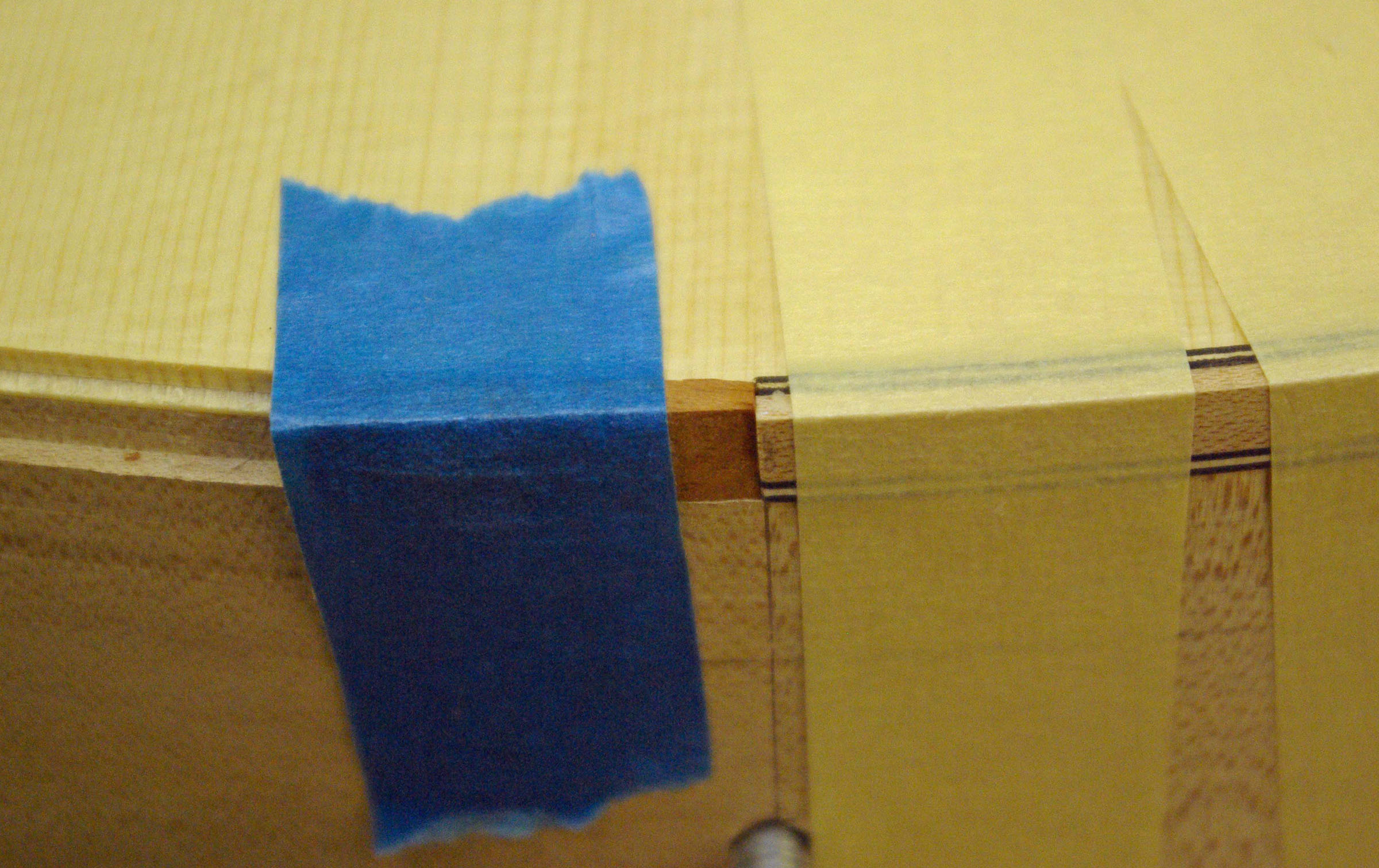

I was struggling to keep the purfling and binding lined up at the centreline at the base of the box.
What worked for me was a little stop block taped dead on the centreline. Then I could push the binding and purfling against it while fiddling with strips of wood, strips of tape and glue everywhere.

great idea. thanks

Thanks for the tip!...small things like this are a big help...
