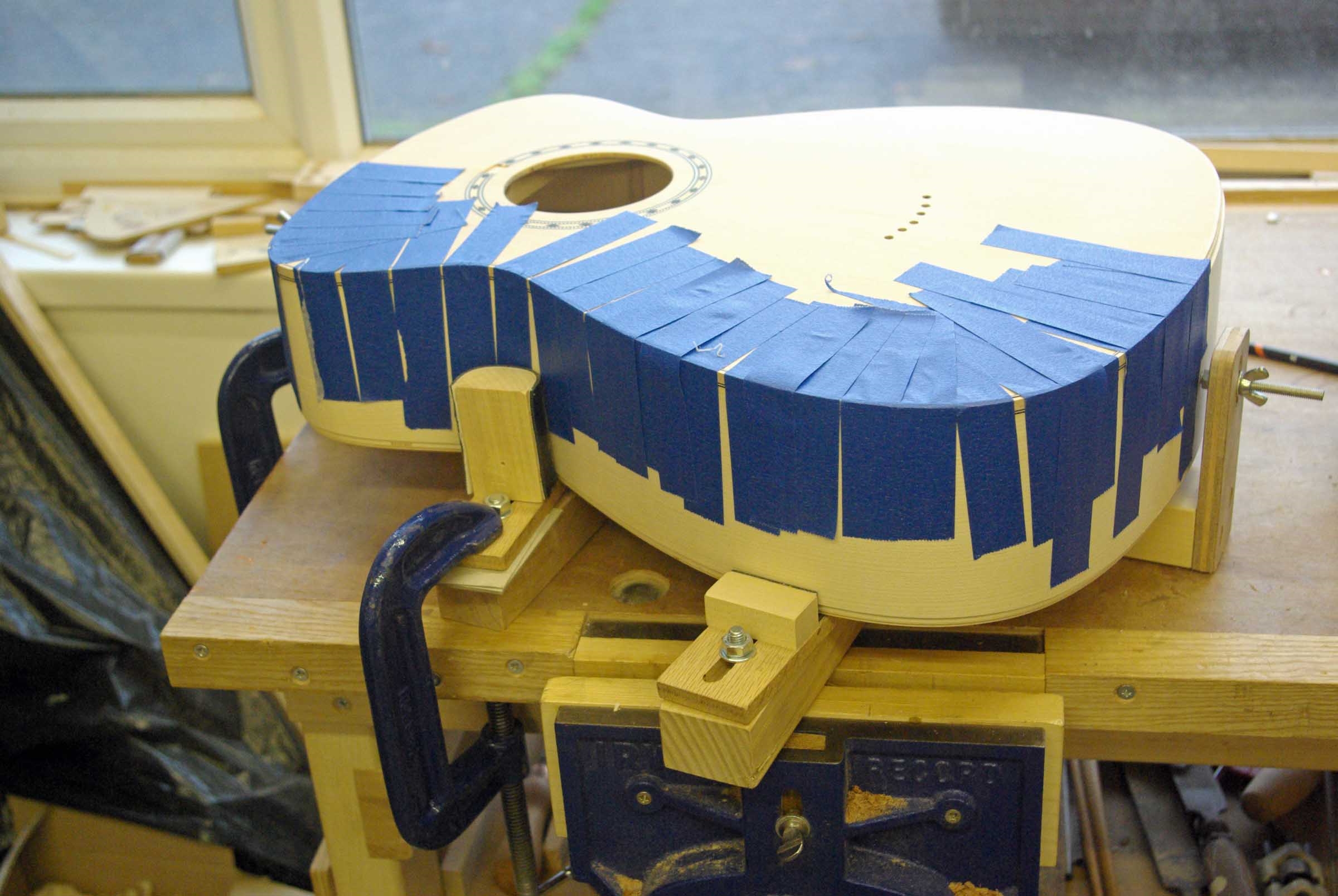

This may be obvious to everybody but I have only just thought of it.
The cradle used when cutting the binding channels can be used to secure the box to the benchtop making it easier to apply tape. I found it much easier than having the box sliding around.
Re: Glueing Bindings
Post by kiwigeo » Sun Dec 20, 2015 10:11 am
A good tip Dave. I sit the instrument in it's external mold. I stick some cork blocks underneath elevate the guitar high enough to get the binding cutter jig around.
Nice looking guitar BTW
Post by Mark McLean » Mon Dec 21, 2015 11:32 am
Yes, why didn't we think of that before?
Seems like a good idea. I have a binding job to do this week so I am definitely going to put that idea into practice. Thanks Dave.
