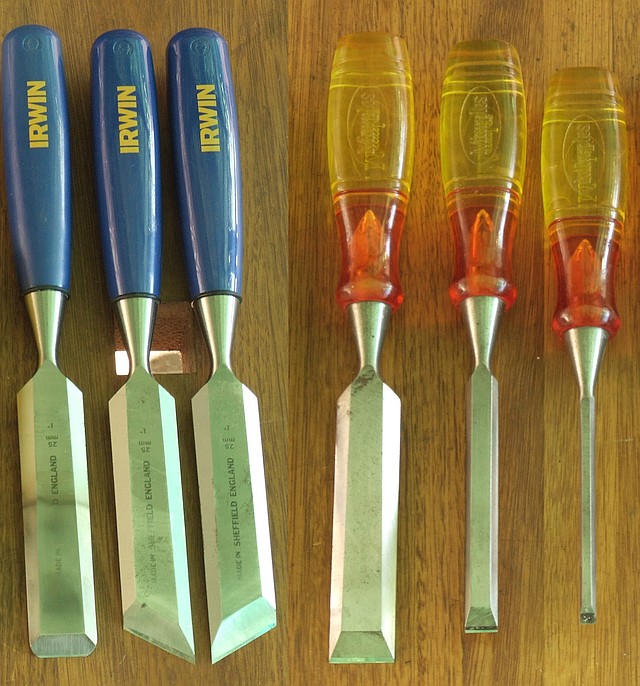

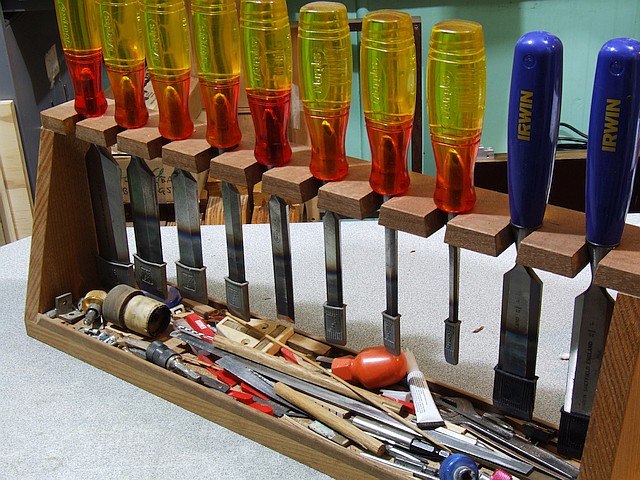

Many of you will have chisels of the Stanley/Marples/Irwin ilk. I’ve had a set of Marples for, idunno, 20 years or so, but was never particularly impressed with their edge holding when used in a guitar building context. My blue handled Irwins were added maybe 10 years ago and they were of similar capability, i.e. not really cutting it.
You can see from the pic of the Irwins that I had had a go at hardening the brace carving chisel, with no real beneficial effect. I took to using a variety of old chisels bought at junk sales which performer better, but still not as well as I wanted. I even made a chisel from an old file, which turned out to be the best chisel I owned, holding an edge way sharper and longer than anything else I had.
I was just about getting to the stage of junking the Stanleys and Irwins when a correspondence with an old mate happened to mention a method of hardening some of the alloyed tool steels that somehow I had in mind couldn’t be heat hardened. I’d previously tried and failed with the Irwin brace carver and a couple of old Stanley plane blades, which reinforced that thinking. I thought “nothing to lose here”, so give it a go.

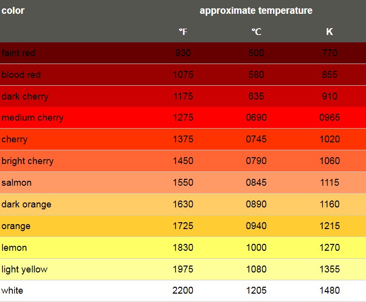

The process is to heat the last 50mm of the tool to ~750°C, hold at temperature for ~ 1 minute then plunge it into olive oil. That’s it! To get to 750°C I needed two butane torches flat out and matched the hot steel colour to the chart attached (cherry).

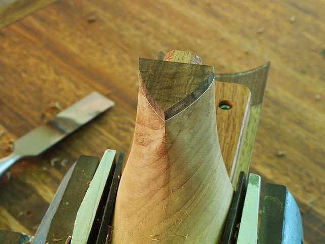

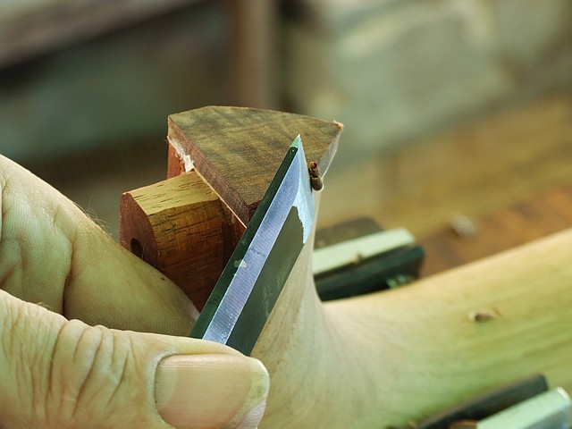

Well, I was impressed! I used the brace carver to flush trim a figured gidgee heel cap, reckoning if it could do that well, it would be fine. (The gidgee was some of that “mad” figured stuff from Pete McCurly; hard as the hobs of hell).

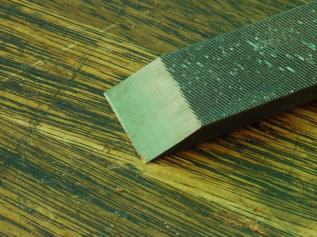

Not only did it flush trim it fine, afterwards it would still shave hairs off my arm without a strop or re-hone. Not even my “file” chisel will do that. So I’d call that a pass. Previously, that chisel would have curled up its toes after one stroke.

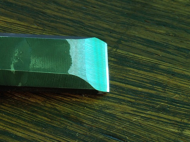

Here's a detail of the brace carver after doing the heel cap. I did the rest of the chisels with similar results, but left out the 38mm chisel because I only just had enough heat to get the 32mm one to temperature.

AG, what colour is the steel going to be at 180C.
I've been quenching in water when the steel gets to a dull red to try and get the tool hardness up. Time for a change of technique me thinks!

Re: Harden Up (your chisels)
Obviously not very good at this guys. Travel gets me!! (Just found the notify me when a reply posted)
So the colour of steel being heated to 200 deg C is light yellow. See attachment.

Dennis, In the same way as you hardened them is fine. Use the visual method to gauge temperature as per the previous attachment or use thermo markers if you want to be consistently accurate. A link attached
