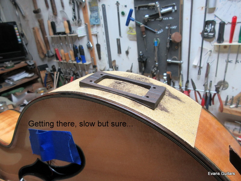

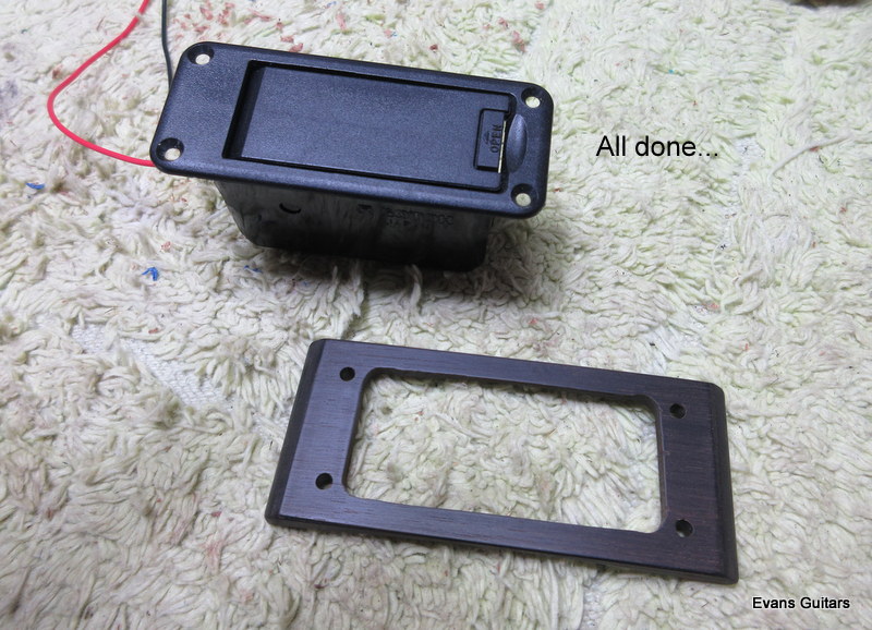

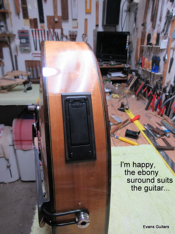

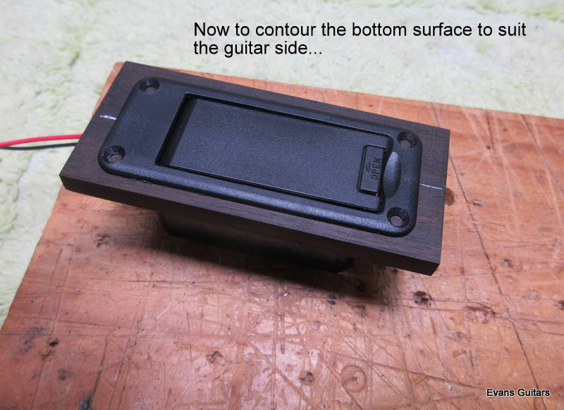

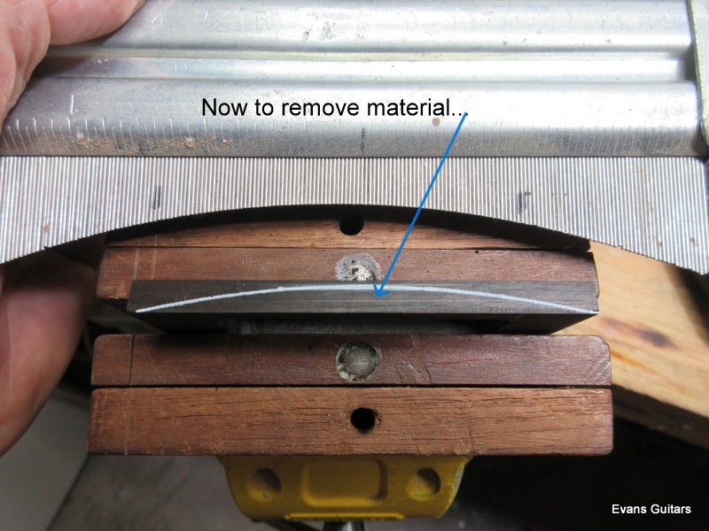

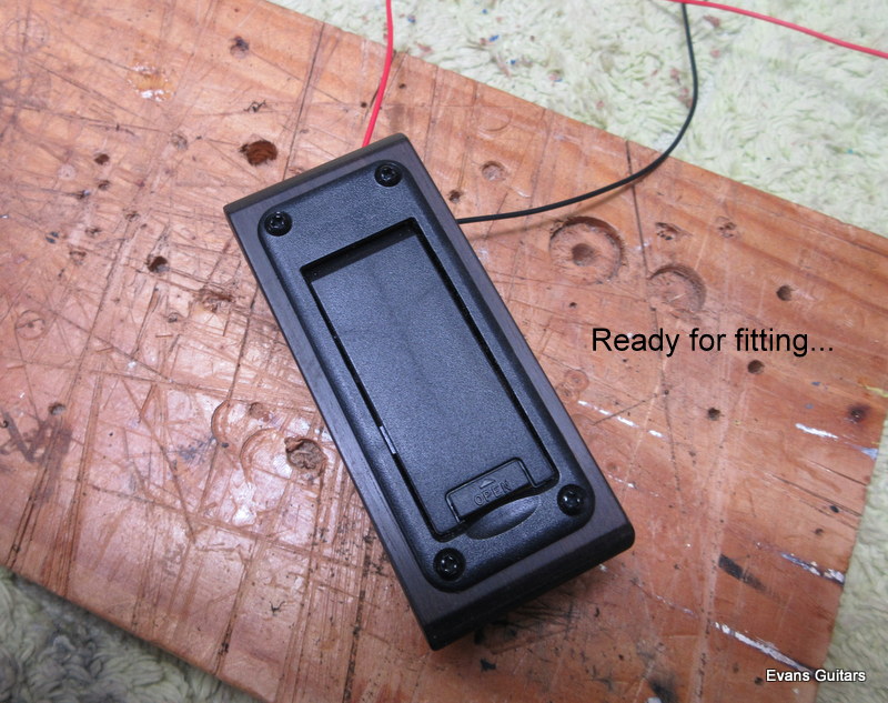

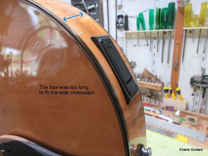

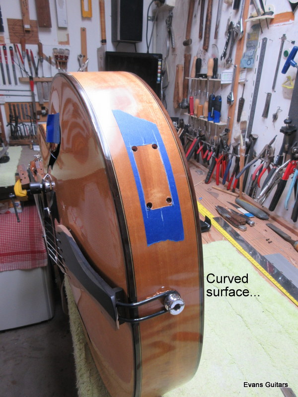

Hi, My customer brought me this nice guitar to fit a battery box into the side, as he was sick of trying to access the battery through the F holes.

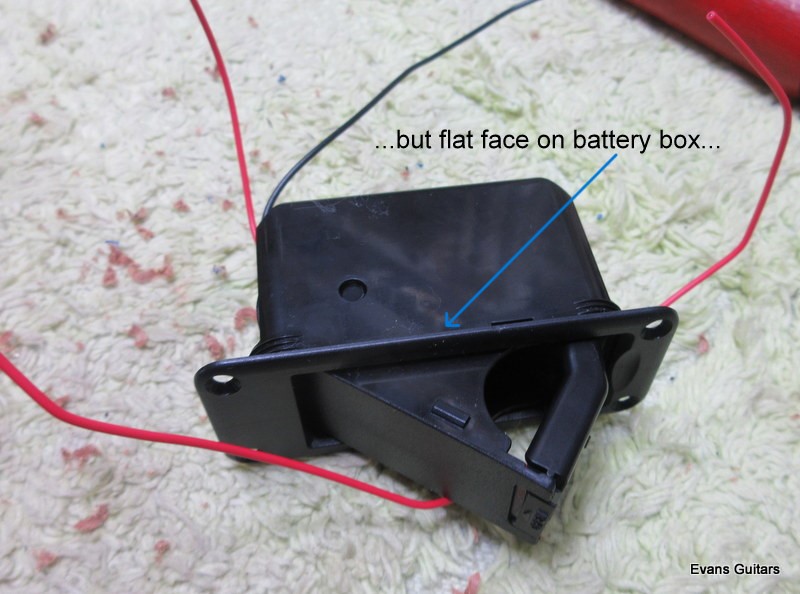

I had tried to find a quality battery box suitable for this narrow-side archtop guitar but all I could get was the type pictured here, for flat surface mounting.

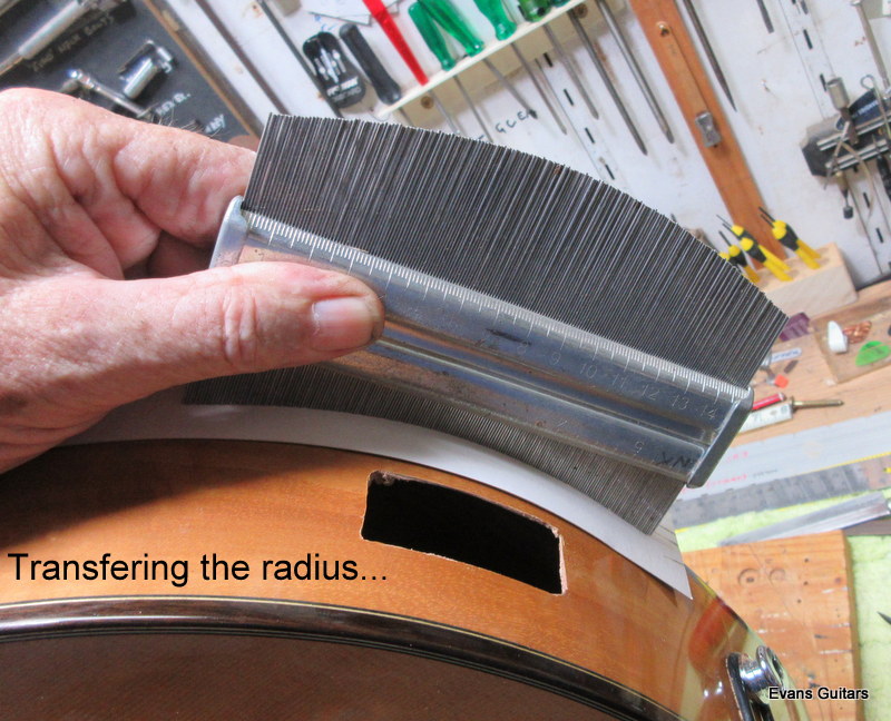

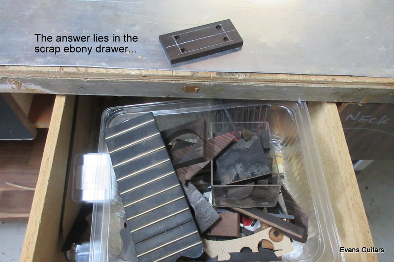

Question… does a flat surface onto a curved surface go? Well yes, with a bit of work. The photos show how I did it.
