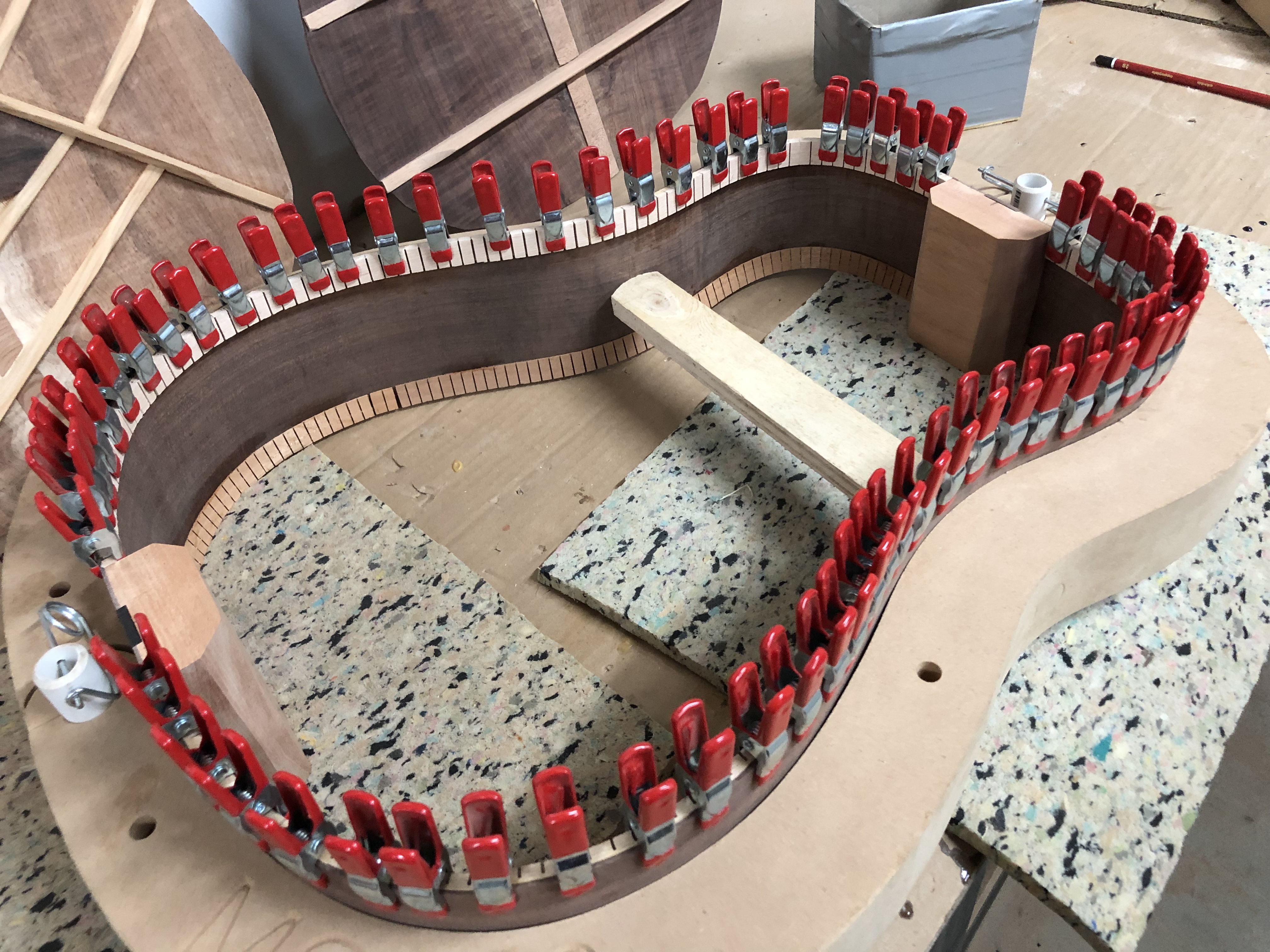

Front and back blocks in clamps:
Pencil lines to show when I’ve sanded for long enough on the radius dish:

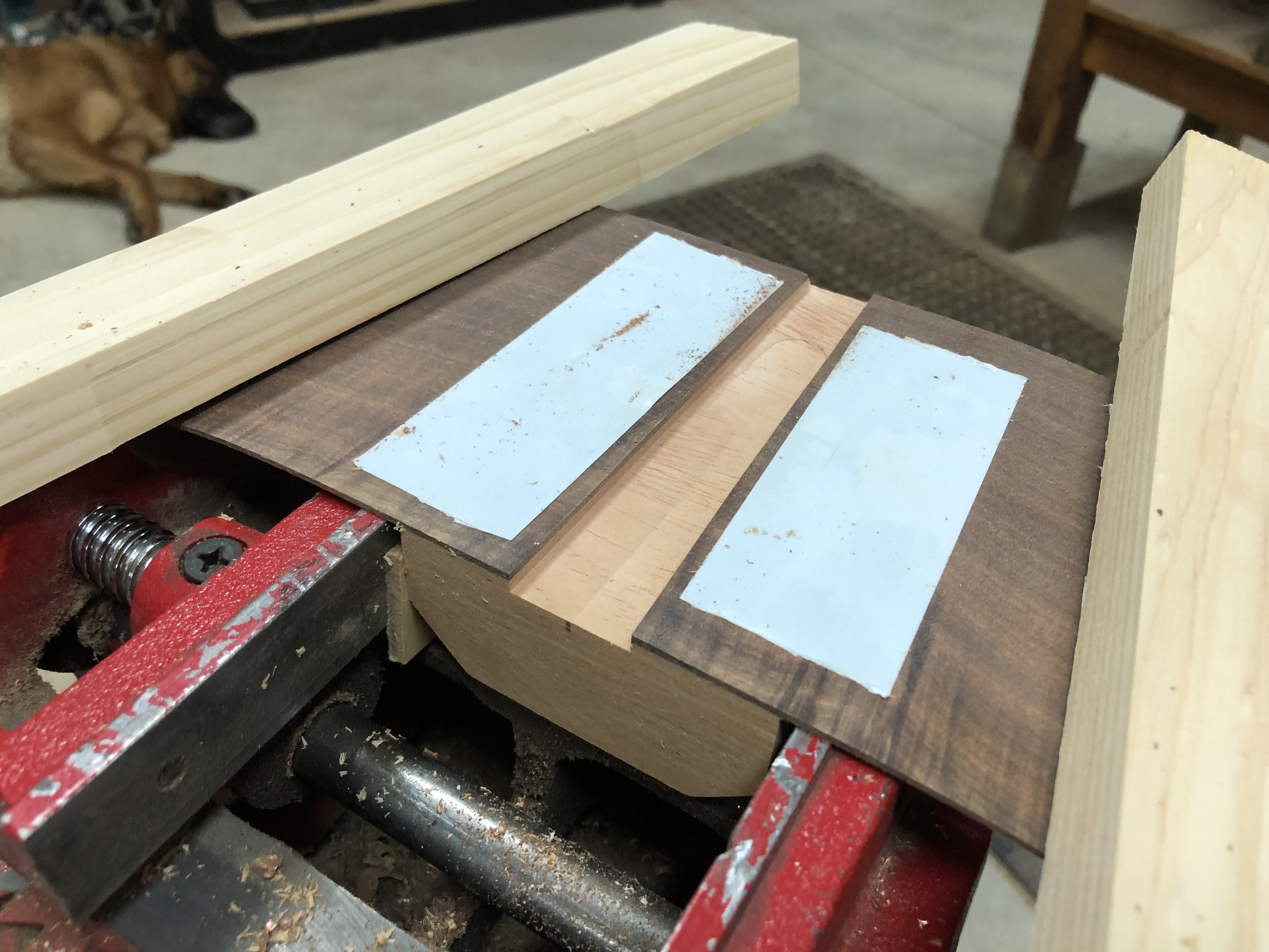

Route for the back strip. I don’t bother with jigs or anything here, just some double sided tape and a couple of bits of pine which I’ve run in the sander for a straight edge.
M

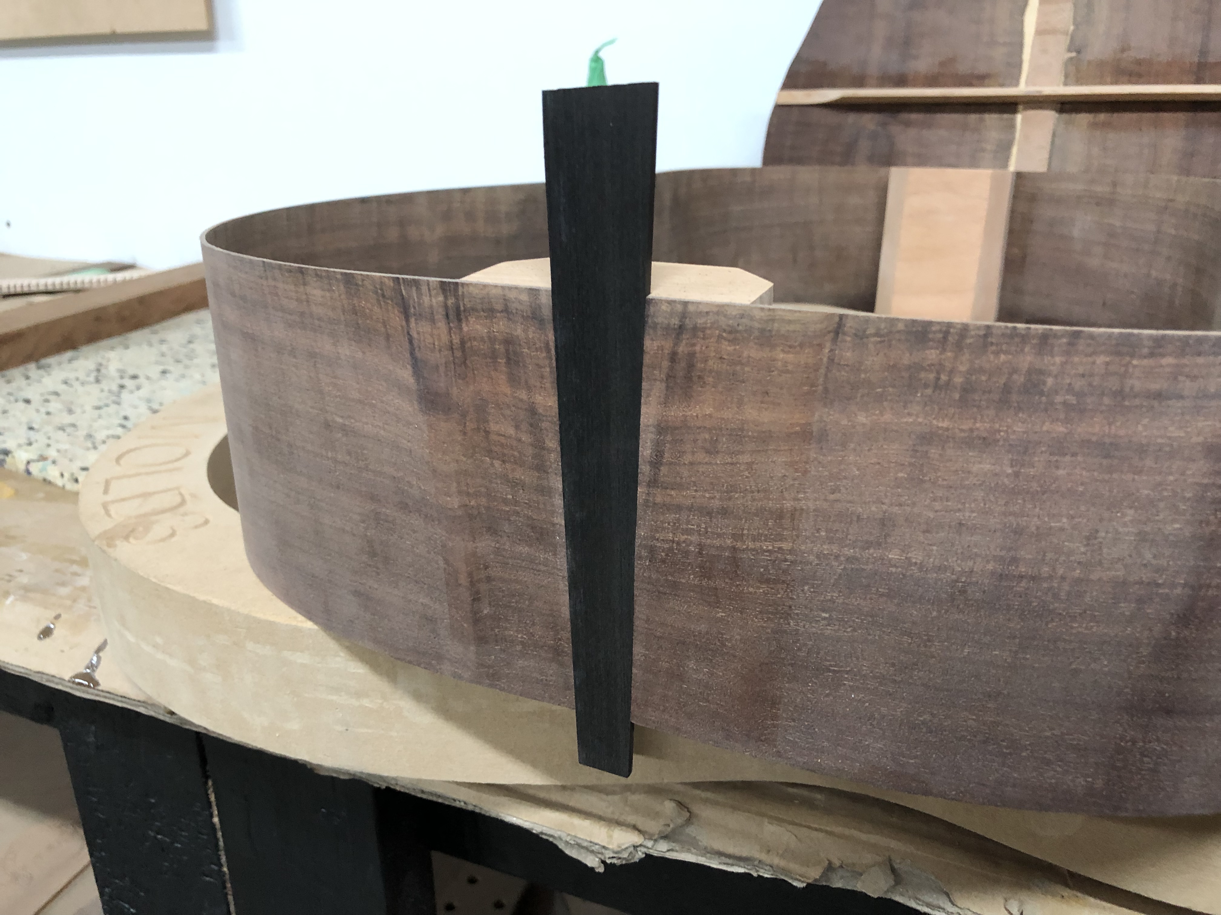

I like the wedge shaped backstrip as I can tap it in with a hammer and there’s no need for clamps, it holds itself in place.
Mahogany back lining in. I’m usimg mahogany for thebwck lining as I like the look, however I plan to make some thicker and taller maple lining for the top so it reduces the vibration down the sides, being it’s a Blackwood top I’m hoping this will help it come to life.

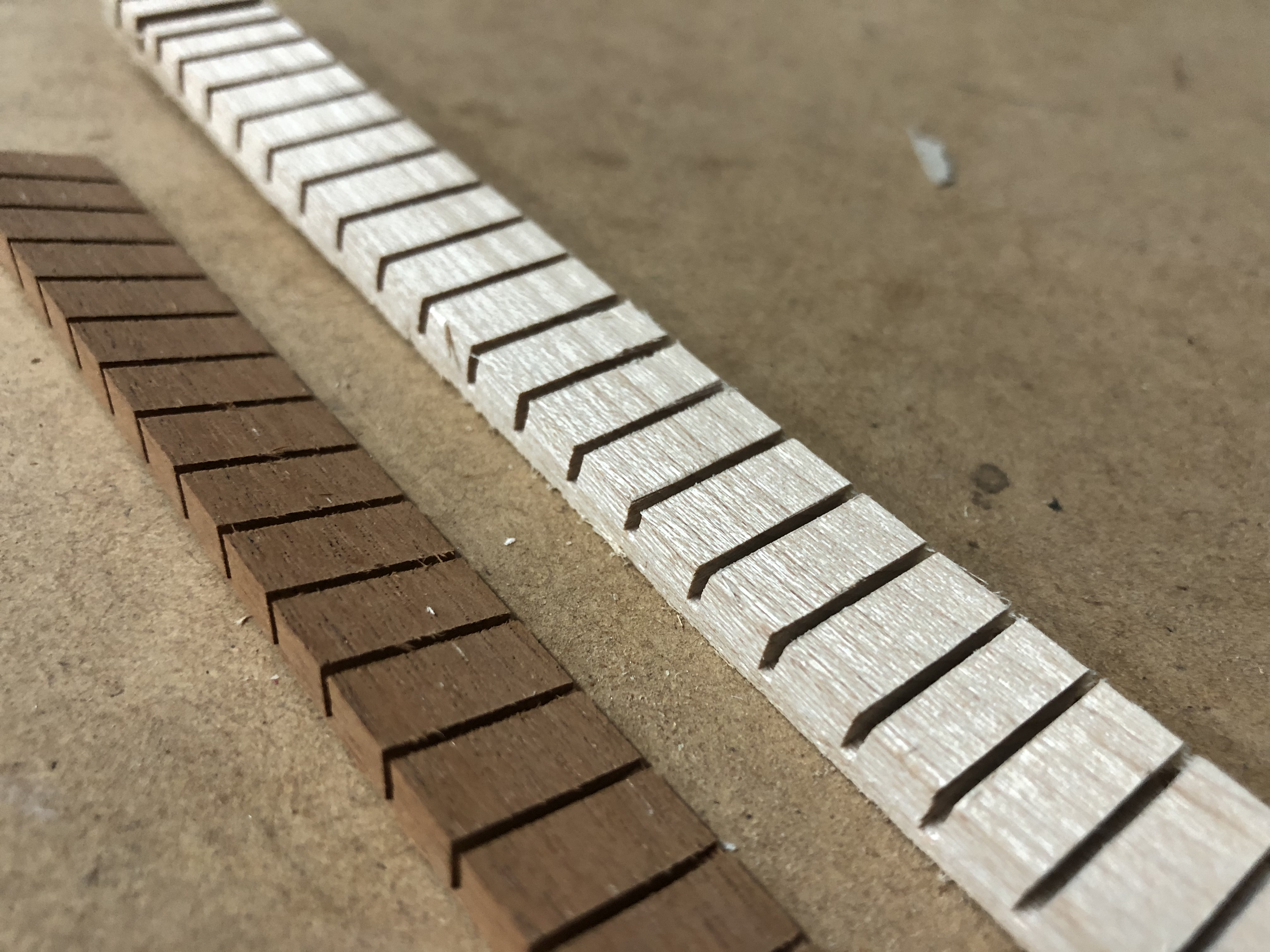

Thanks. It’s just something in the background of my usual work, but since things are fairly quiet at the moment I’ve able to throw an hour or two at it each day.
I also recut the maple lining, I wasn’t happy with the size of the first lot. You can see the makeshift jig I use, simply a block of wood with a slot to move the block forwards and backwards, then aocatoe pin, the same as a feet slotting jig.
In this pic you can see the chunkier maple lining next to a standard size. It’s not heaps larger, but i think it should be chunkier enough and stiffer to make a difference.

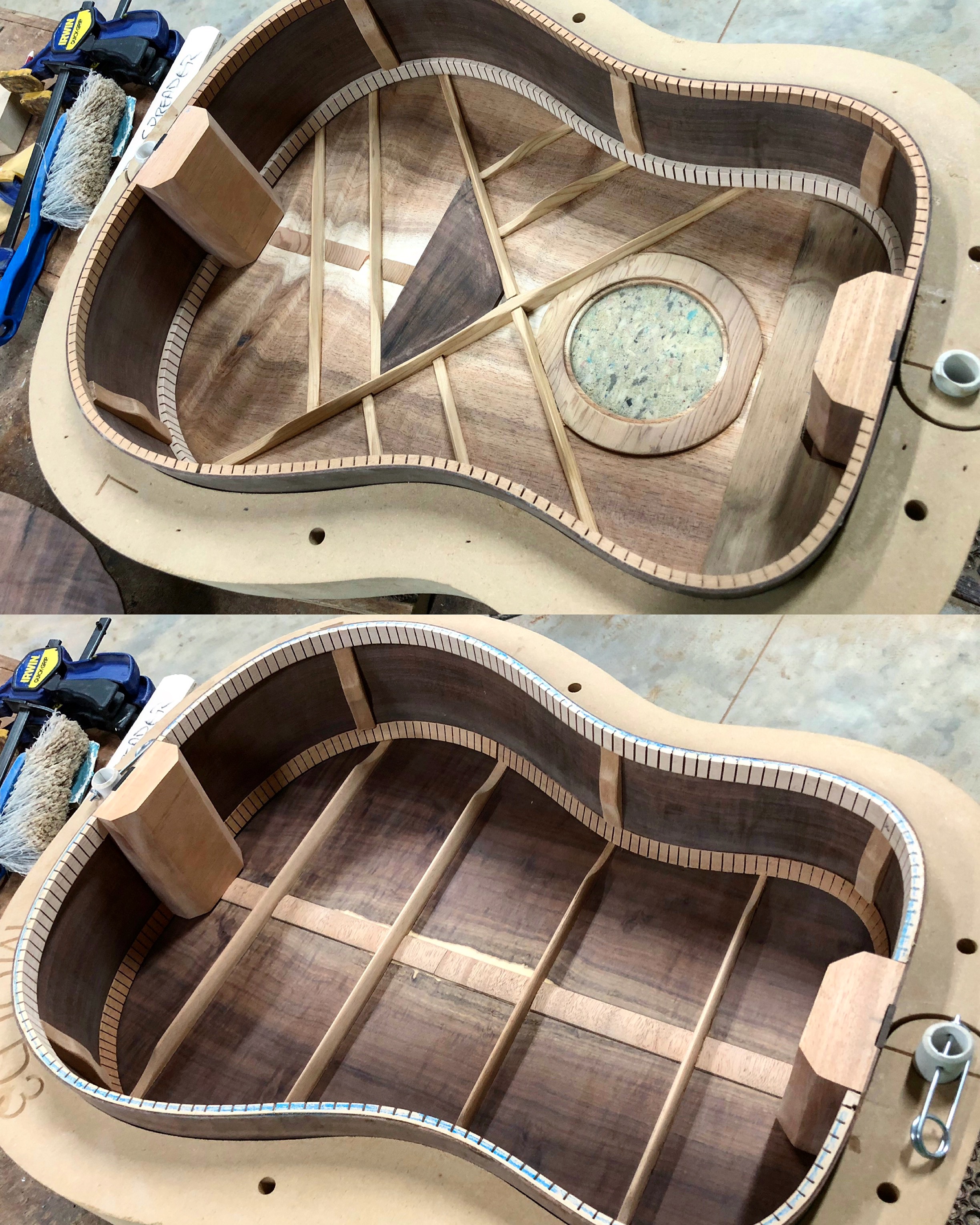

Post by demonx » Thu Nov 15, 2018 12:48 pm
Starting to look like an actual instrument now as opposed to some random pieces of timber thrown together.
I was hoping to get the back cut in and glued today but it looks like it may be a job for another day. Unless I can squeeze it in late this arvo.

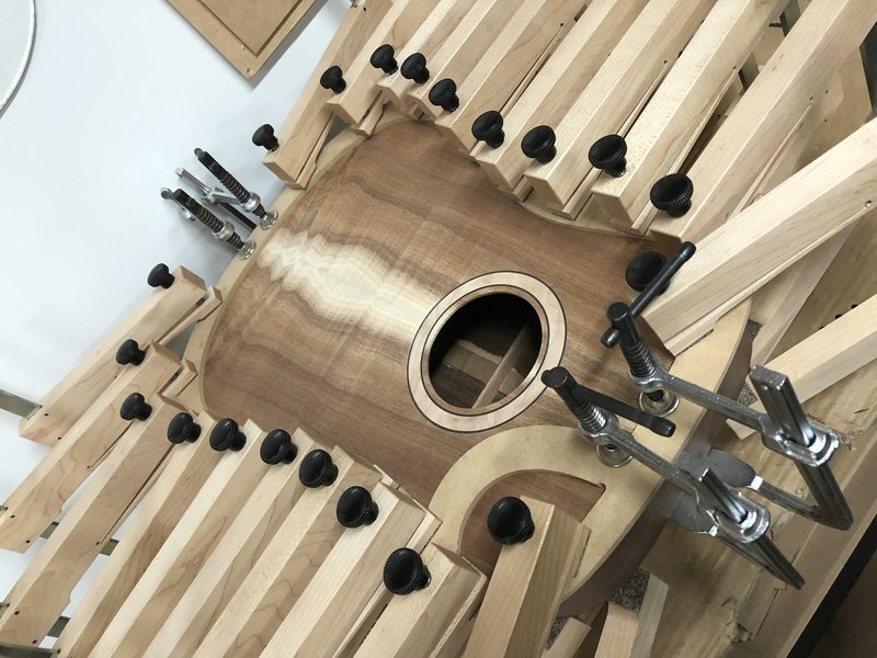

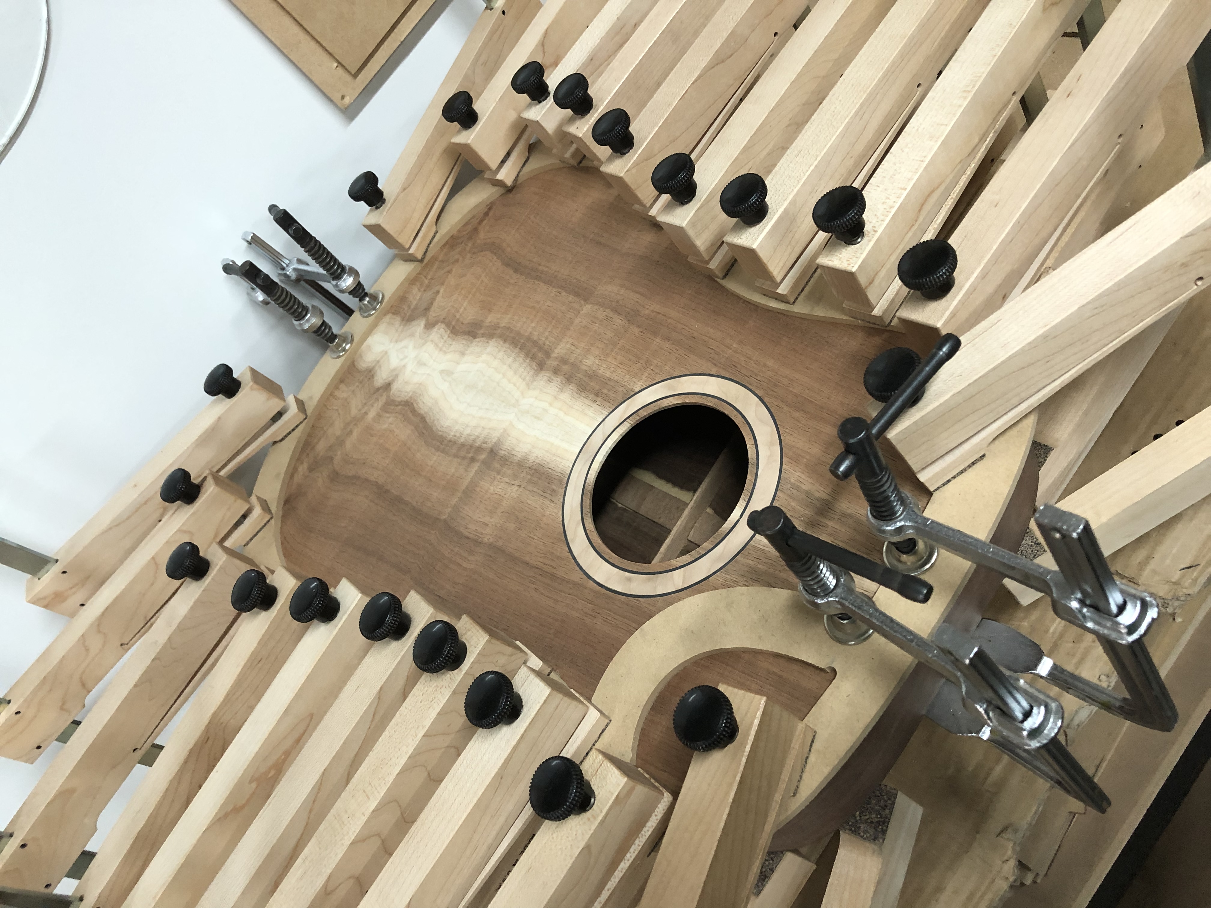

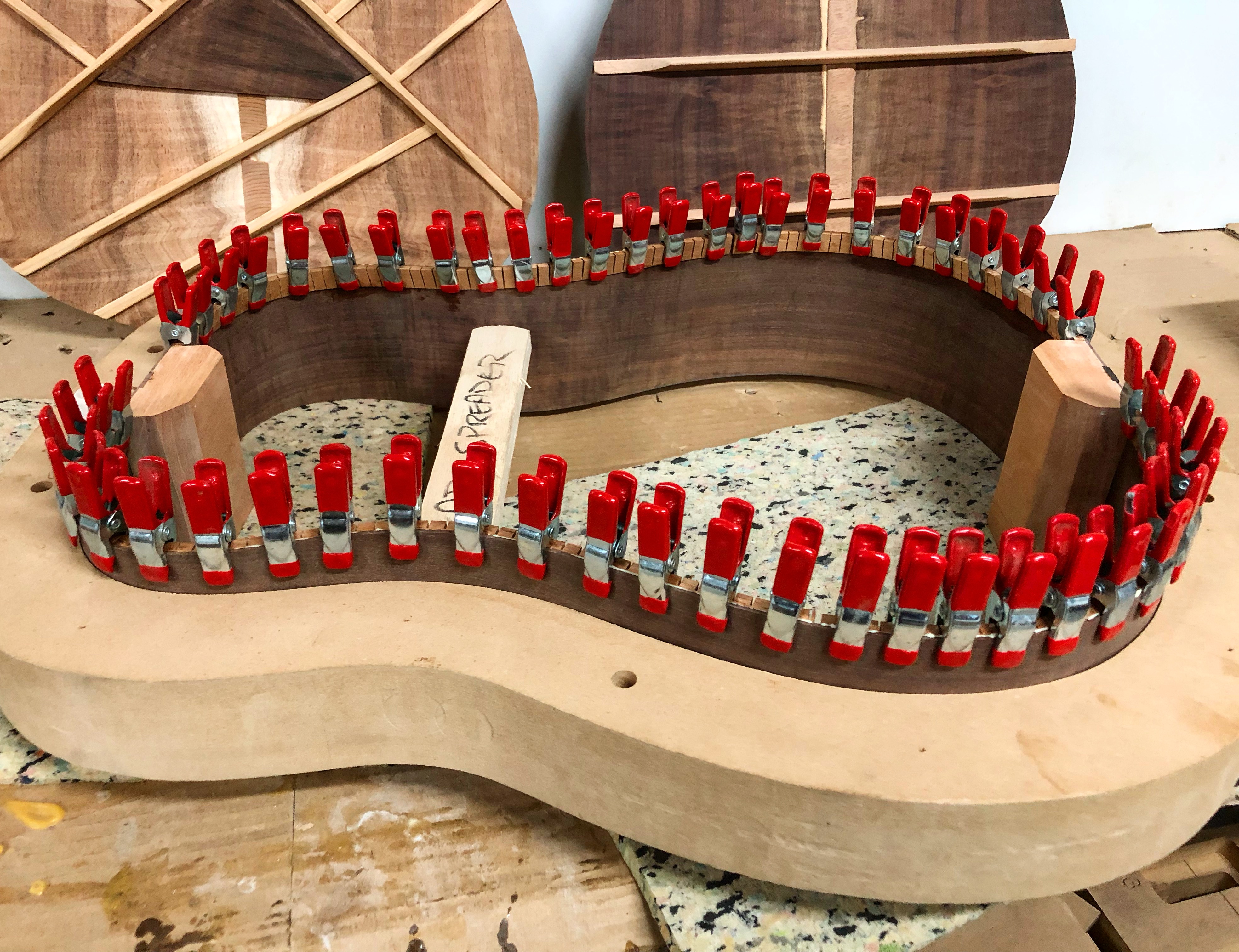

Box is closed.

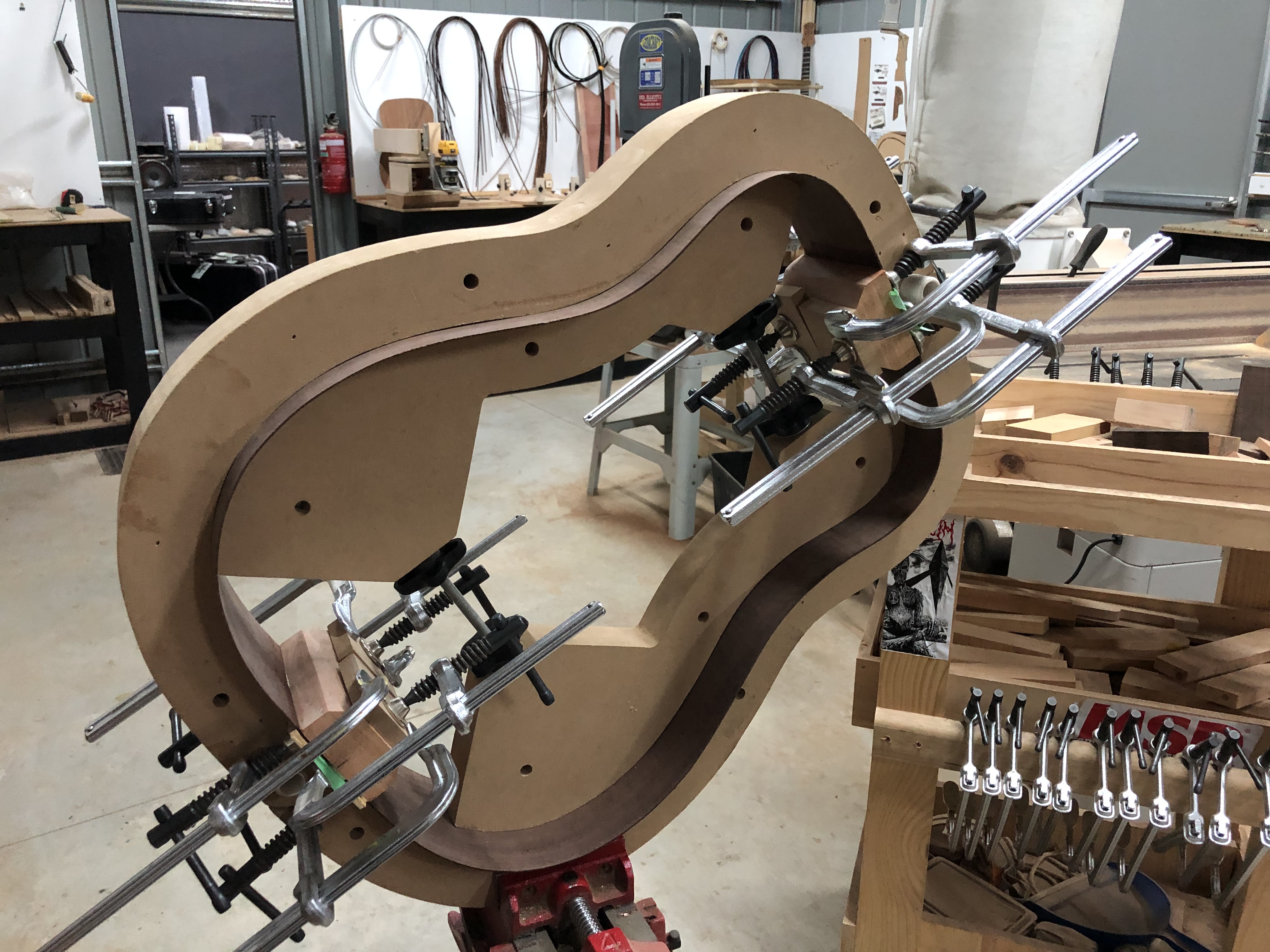

You can see in this pic I’ve started off with the metal clamps, they’re faster/easier to work with, so by doing the front and back blocks first with those it helps me get the centerline in place first, then the other clamps to finish the job.

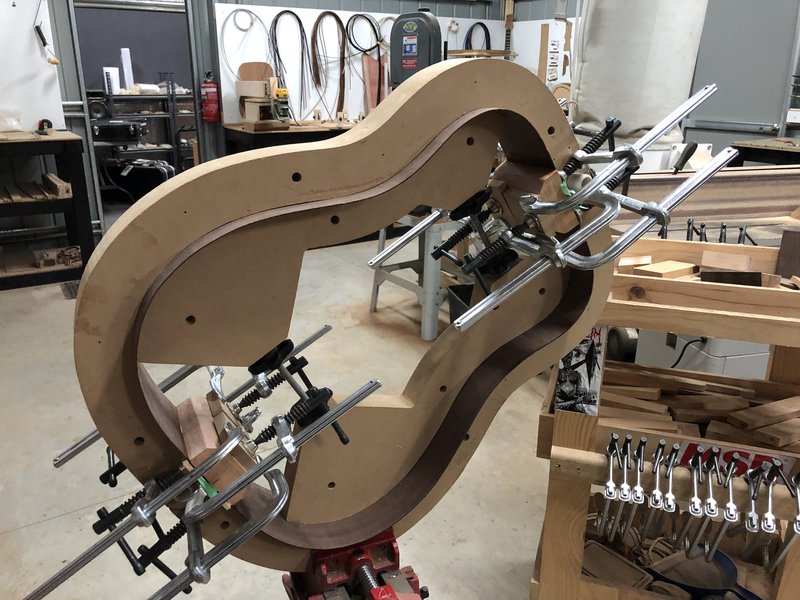

Post by demonx » Mon Nov 19, 2018 1:04 pm

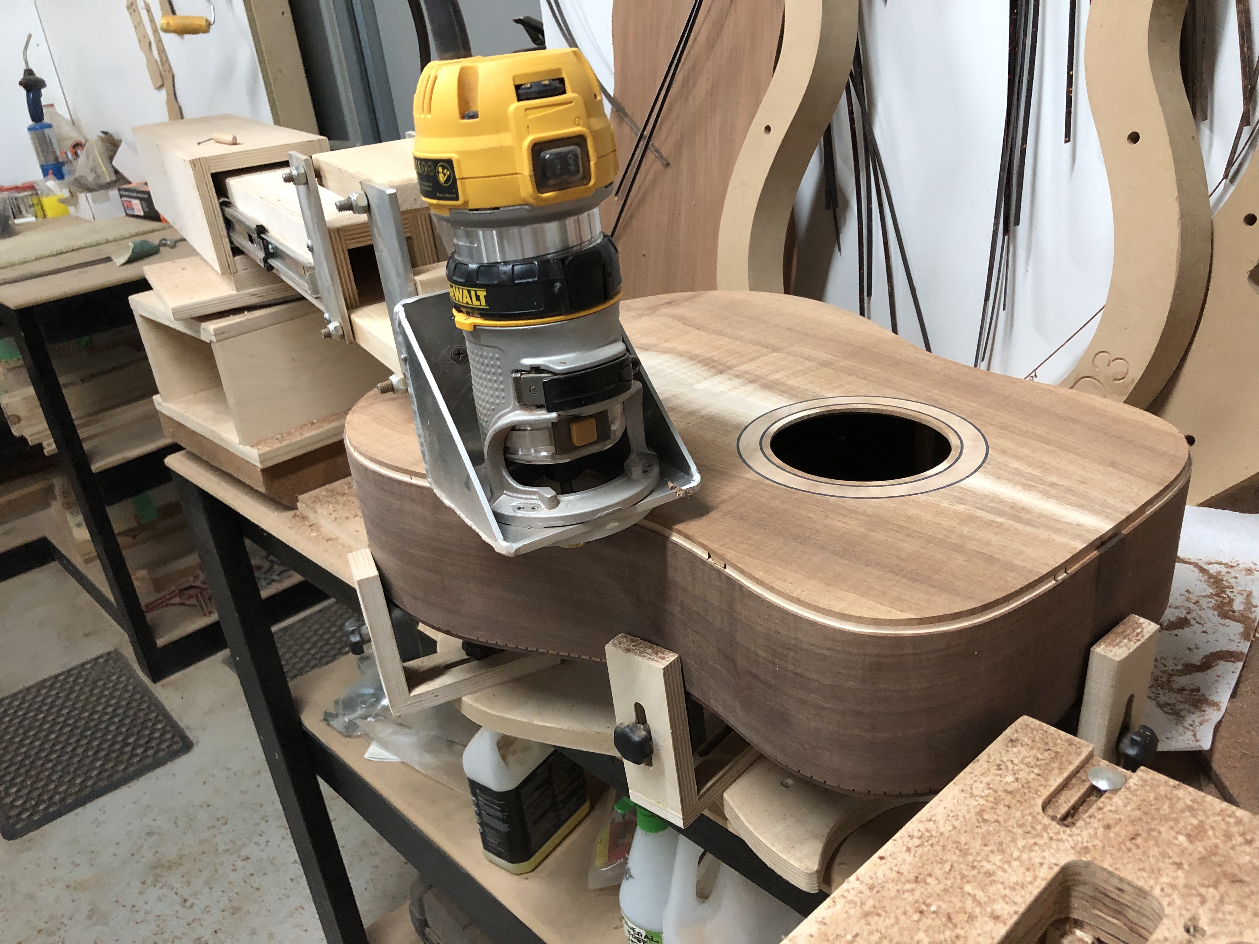

Pretty sure everyone can work out what’s going on here. It’s the blues creek setup and a dewalt trimmer.
Won’t be gluing it in as my acrylic glue has ran out. Job for another day.

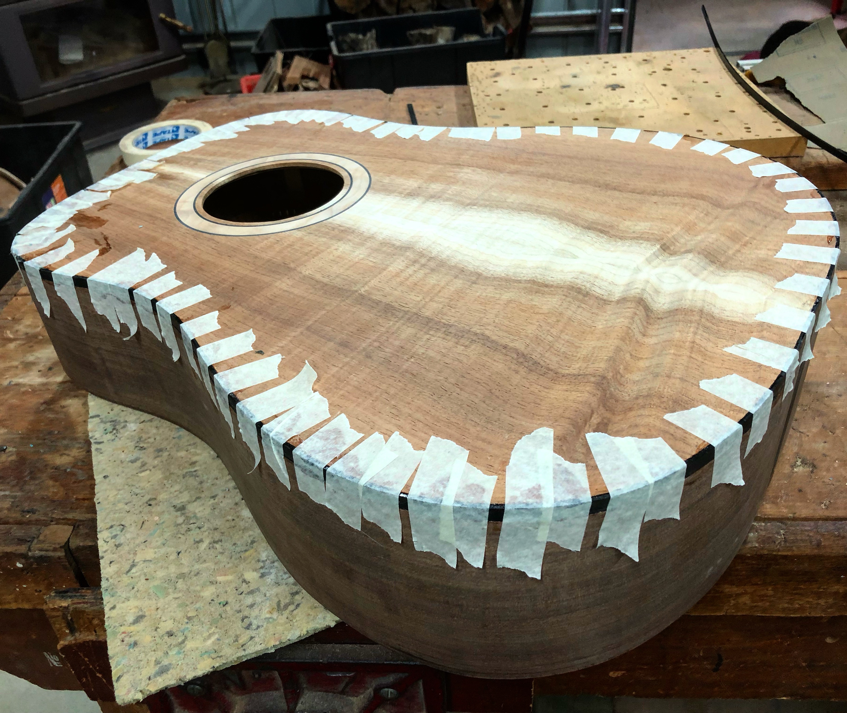

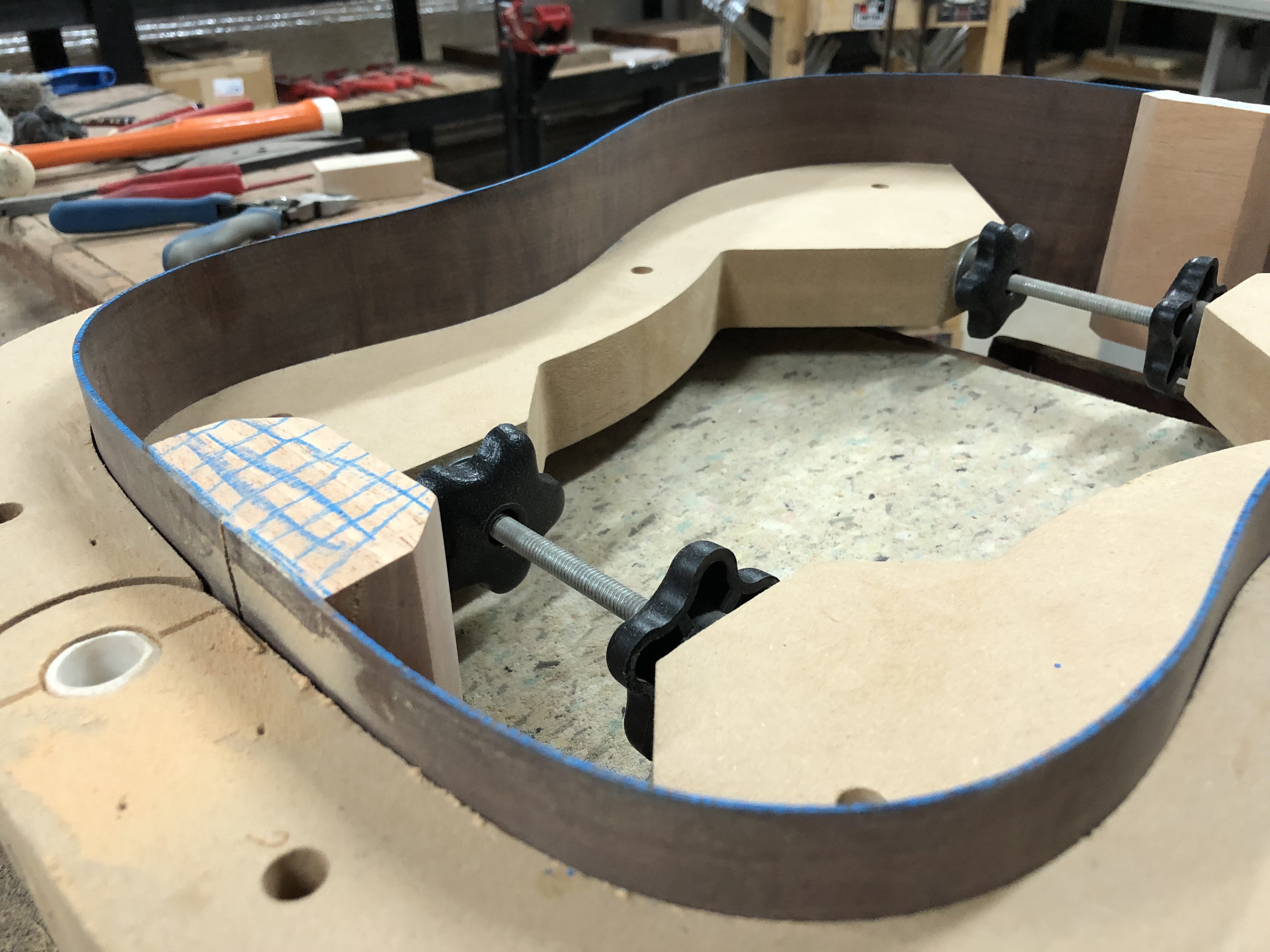

Haven’t touched this one for a few days, so today I got a start on the binding.
I prefer the stewmac ABS stuff. I’ve tried ABS from other venders and the stewmac stuff is the best I’ve used. I use weld on glue for this.
To work with I prefer to use timber. It’s quick and easy to bend and it glues up a breeze, ABS is more of a pain, it’s messier and fussier with glues, but if I’m doing a plain black I’ll use ABS as I believe it has better lastsbility. It has a bit of resilience to it, where timber binding chips just by looking at it, so my thinking is the ABS is better for the longevity of the guitar. Under a clear coat it looks the same as ebony anyway.

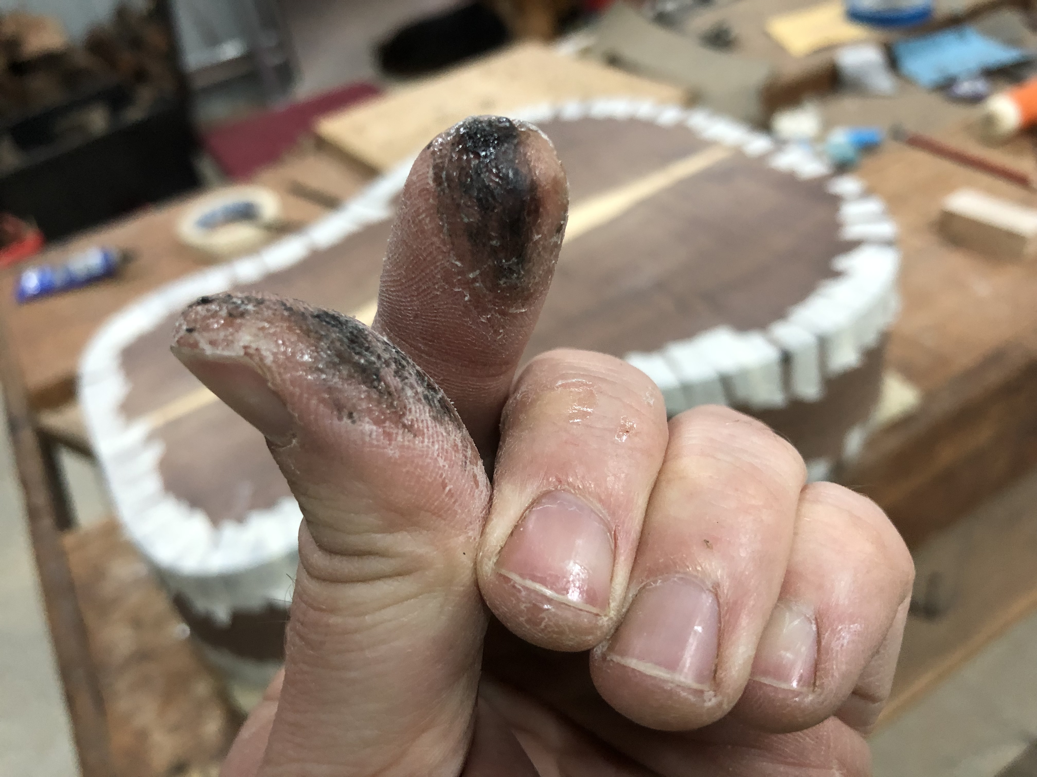

Post by demonx » Fri Nov 23, 2018 4:56 pm
“Binding Fingers” !!! Good thing it’s not highly toxic like epoxy!

More fun with superglue :shock:

Superglue is terrible for doing bindings, it’s adds so much extra work afterwards compared to the weld on. I won’t make that mistake again!

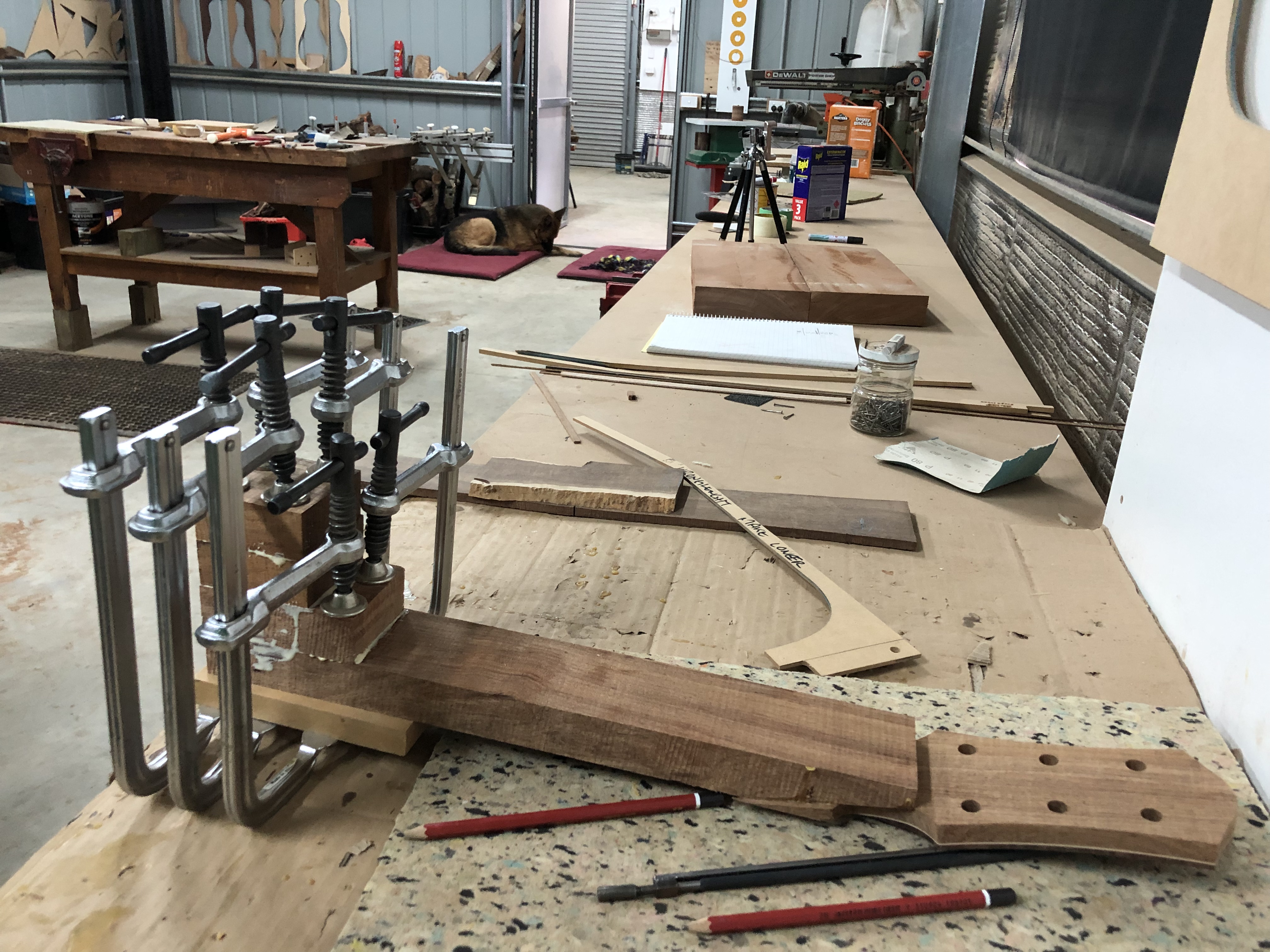

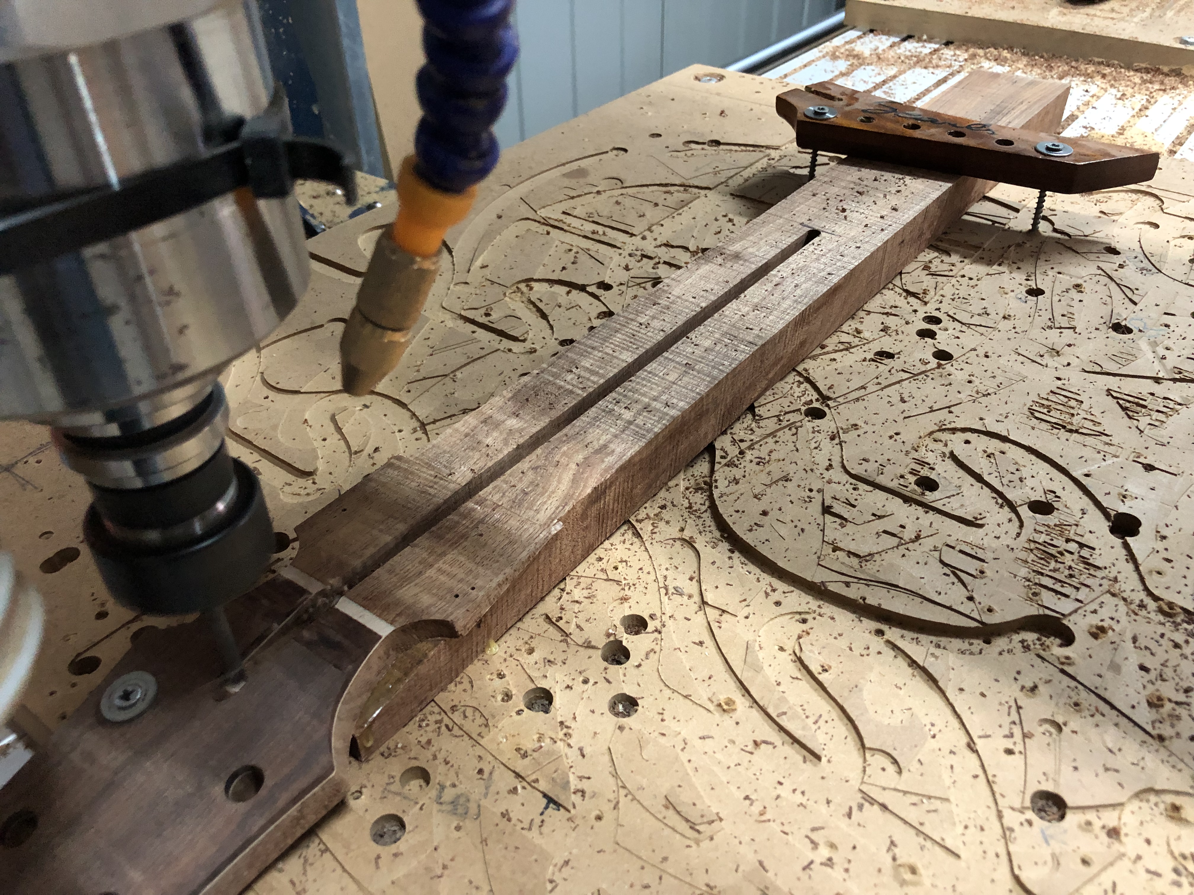

I had a few spare minutes at the end of the work day so I routed the truss rod slot and stacked the heel.
For anyone interested in CNC. It takes me longer to do it this way then when I used to use a table router. It takes longer to set up and I do it in four passes, when I did it on the table router years ago I only did two passes.
Re: Acacia dread build thread
Post by kiwigeo » Sat Nov 24, 2018 3:54 pm
Was wondering why you left the heel stack up until after doing the headstock and truss rod slot.....and the realized it was so you can do the slot using the CNC.
Sure is. Makes mounting much easier.
Going back to the binding for a moment, I did something different to usual on this one and I’ve had a much better result.
Usually I route the binding so it’s perturding just a smidge, then I scrape the binding back to the wood. This time I did it the opposite way and took the wood back to the binding. It seems to be more work, but a better result.

I guess you can do it that way but risks would be 1). tear out on the top 2) thinning the periphery of the lower bout will affect frequency of the main top monopole 3) if there are purflings then you dont want to take too much off the top of same.
One advantage for dark coloured wood bindings would be lower risk of discoloring the top wood with dust and scraping being worked off the top of the binding.
