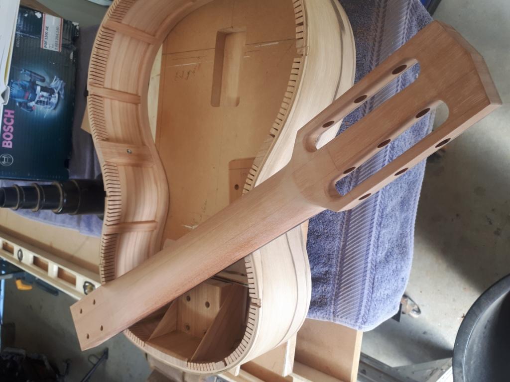

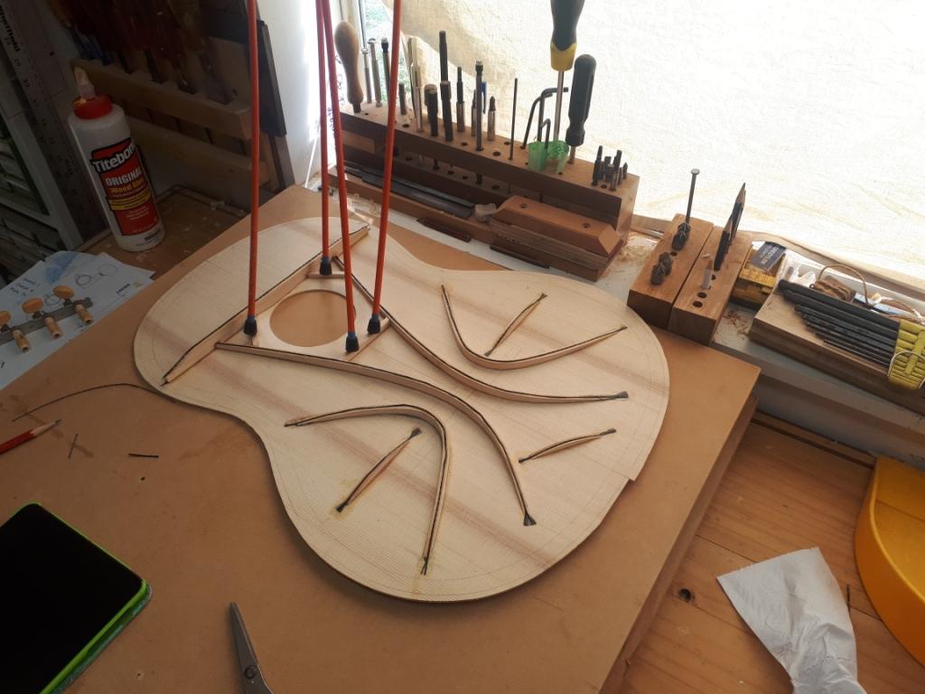

Ah well, a bit to late to test pre bracing. I did notice my 2.3mm top sounded very dull when I cut it out, from a knuckle on no particular node type tap and now it rings, so the bracing must be doing something. Sounds kinda ok.
Will report back in a few days....

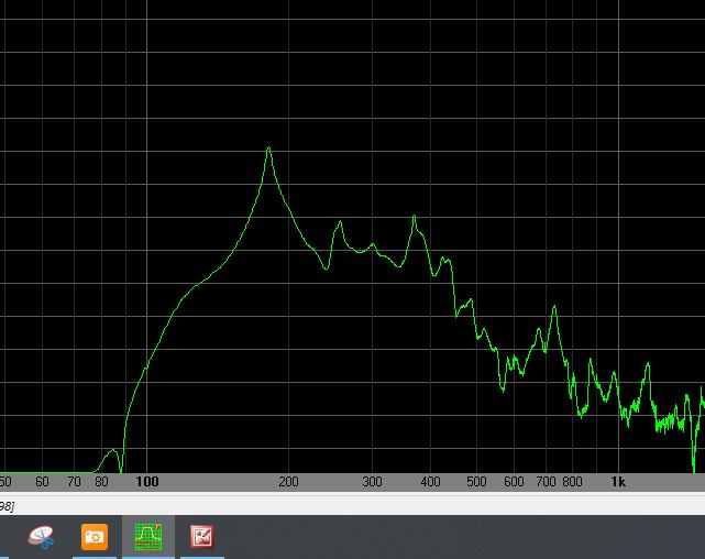

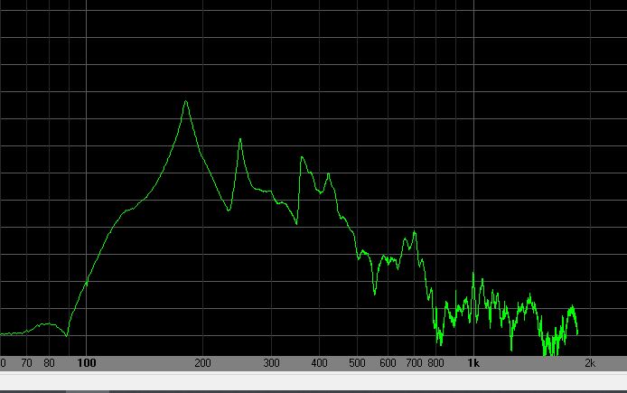

Box is now closed and have done the initial tap tests.
I have a pretty clear and consistent T(1,1)2 at 180 Hz however there is no bridge on yet so no stiffness from that. I did try to model the bridge with 20g worth of coins stuck on the top but measured no clear difference.
The back at 250Hz, which is miles away from the top and much too stiff but I left the central brace unscalloped so there's room to move that.
I'm happy enough with this to move on.

This is the stage at which I should do any thinning of the top, If I am going to.
As I see it, with the top at 180hz now, prior to the bridge going on, the (T1,1)2 will only drop with the added mass of around 20g at the moment, unless I can get the bridge down a bit. Its rosewood so I doubt it though.
Going by the approx 1 hz per gram guide at Fig 4.6-3, that's a big drop and puts my top down around 160, well below target. Will the stiffening effect of the bridge increase teh frequency?? Don't know but the books seem to discount that. Plus there are no bindings on and they stiffen things up a bit as I understand.
Anyhoo it seems to me that I would be unwise to do any thinning.

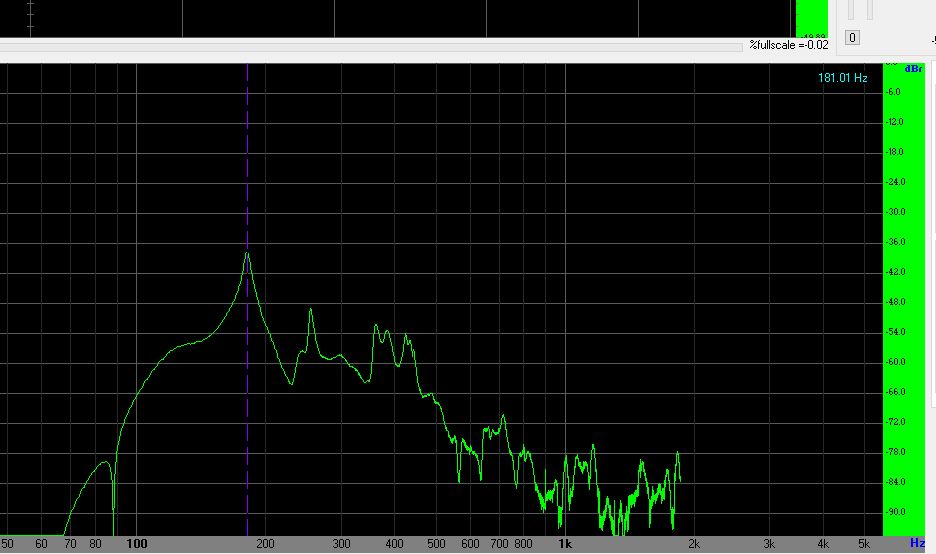

Richard are you tap testing with the sound hole blocked? I cant see any T(1,1)1 peak on that first plot.
I'd re-tap with sound hole open and if no change in T(1,1)2 then I would consider not doing any thinning of top perimeter.

I noticed that too. There's a very small peak around 80 that I think is T1,1. But it's very weak compared to the top and back. My bolt on neck arrangement leaves an air gap which might be affecting it so I tried with the neck bolted on. Didn't seem to make a huge difference. Neither did modelling with a "bridge" of 2 X 2nzd coins.....perhaps I need to use Aussie currency for it to work :D
I need to look at that tutorial Dave M was talking about and redo the tests. They did seem a lot clearer this time though. I think in the past I haven't been waiting long enough for the buffers to fill. All the main peaks appear on the first tap.
Thanks for the help. It's much appreciated.

I can see a tiny peak at 100Hz on both top and back plot.....I suspect this might be your T(1,1)1. Where are you tapping and where are you holding the mike?
seeaxe
Posts: 764
Re: Classical Build (s) - Hopefully falcate!

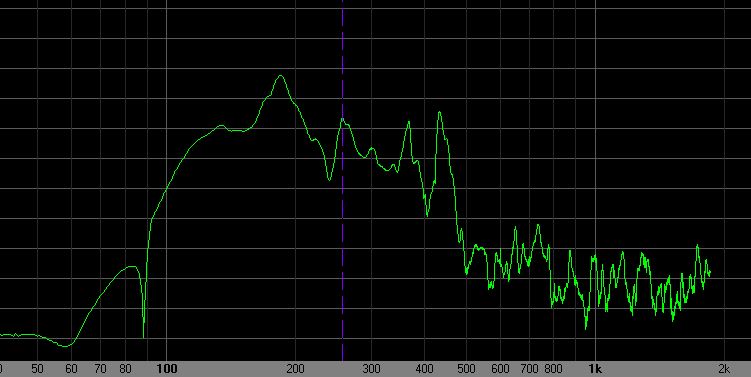

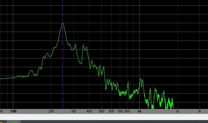

Post by seeaxe » Tue May 05, 2020 12:41 pm
Hi Martin
Im tapping at the bridge position and the mike is about 250mm above that. If I move the guitar so the mike is over the soundhole it increases the T1,1, which although fairly small graphwise appears consistently at 85Hz.
All the other frequencies plotted exactly the same today with the neck firmly bolted on (was a bit loose yesterday)
I have the
T(1,1)2 at 181
The back at 258
and something else, not entirely sure what at 300 and 368.
5 May Top neck on.JPG (51.53 KiB) Viewed 45027 times
mike over soundhole
5 May mike over soundhole.JPG (48.39 KiB) Viewed 45027 times

I usually have the mike over the sound hole (about 2-300mm away from same) and tap on the bridge area. I think if you do same you'll get a nice sharper T(1,1)1 peak.

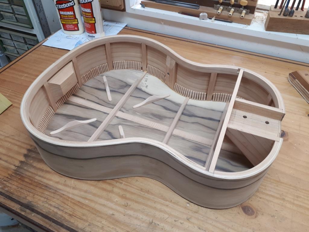

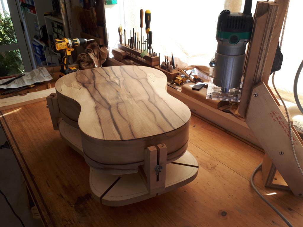

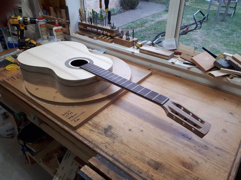

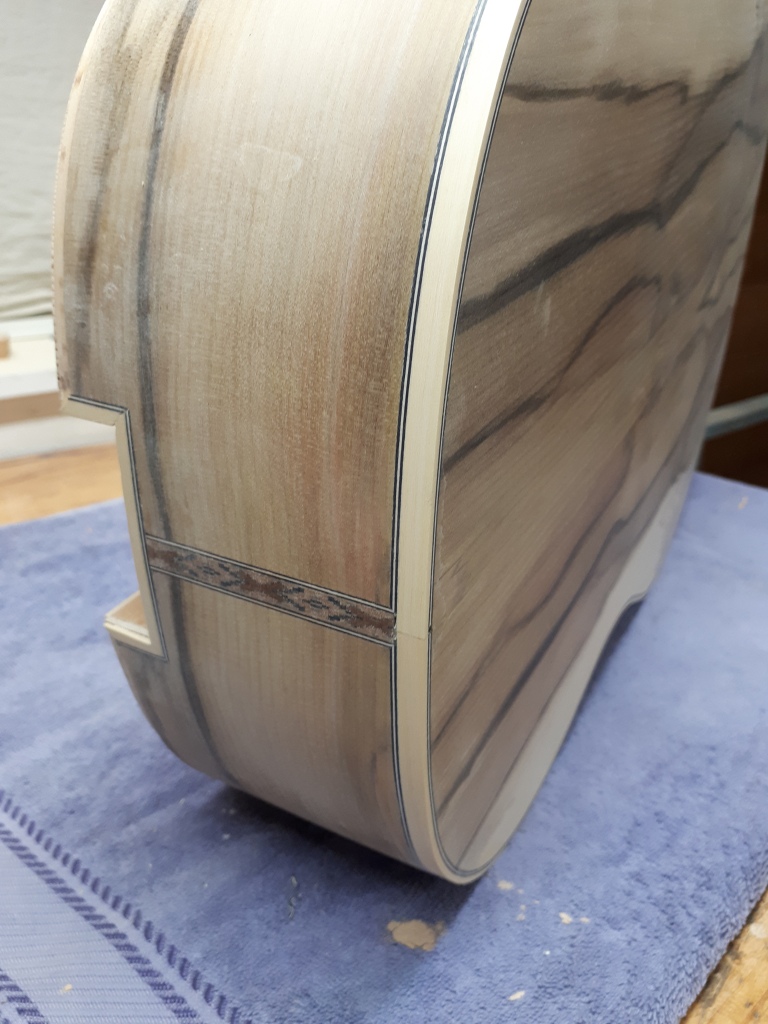

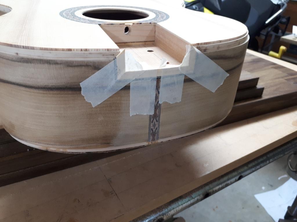

A bit of an update. Now have all the bindings on and am in the process of final sanding and prepping for lacquer. As usual I had a few stuff ups on the binding but nothing fatal, to err is human and all that. Overall, Im happy with the ways it went, one my better binding jobs and the clean up was way less work than usual cos I spent a lot more time than I usually do cleaning up the box before I cut the ledges. Tim S's excellent satin box binding and the perfect rebate bearing meant relatively little scraping and sanding. I'm nearly there with the 220 grit, so a couple of grits to go and I'm done with the body, except for a bit of faffing with the back brace, once I have rechecked frequencies.
Anyway here are some pictures.
A bit more work on the neck to do, not entirely happy with the profile yet. I have checked the set up though and sorted that. Fingers crossed of course.

Looking good there Richard. That blackheart sassy is a really nice looking wood.

Nice work on that rosette!! The guitar looks great too!

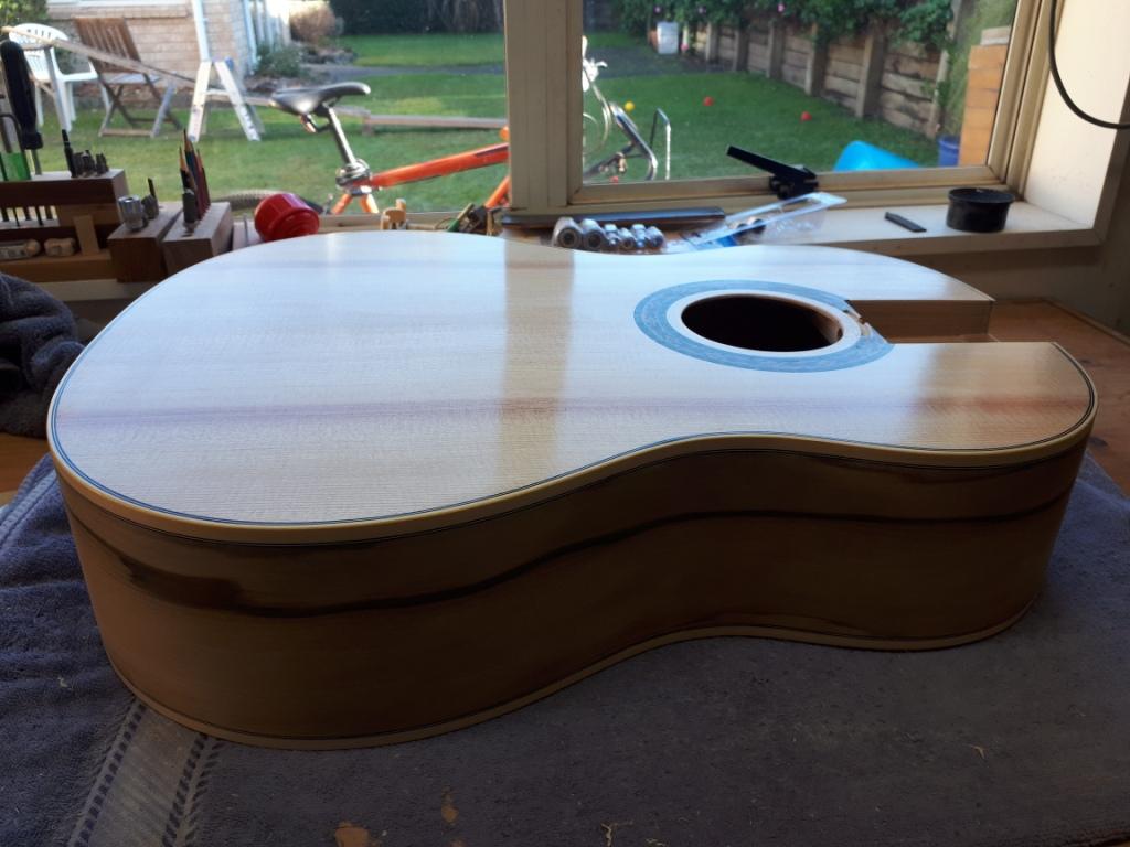

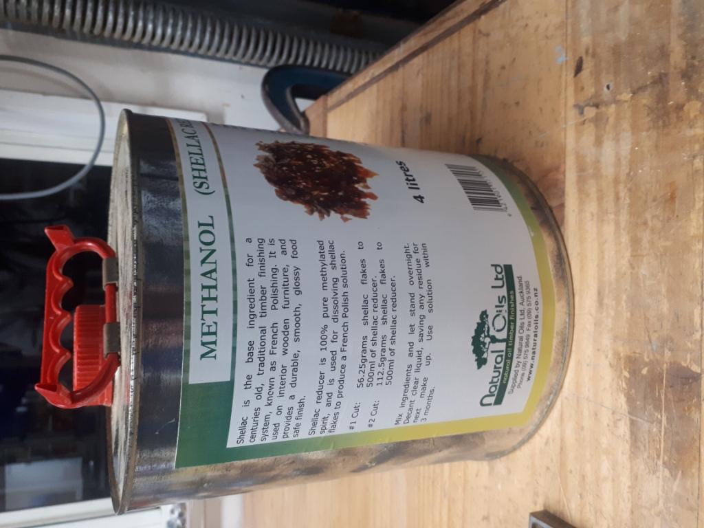

I'm now French polishing the top. Going Ok
For anyone doubting how good an FP finish is relative to other options....
I mixed up a fresh batch, whats called a "2lb cut" which in fact was 112grams of shellac (powdered in my case) with 500mls of alchohol. I made a bit of a mess of this as I tried to do it in too small a container. There's a lot of shellac to dissolve and it takes a while. Afterwards I strained it through cotton t-shirt material and decided I would use a kitchen measuring jug to do that. Even then it kinda went everywhere. Not too worry I thought, it will come off pretty easily. I wiped the jug out with a cloth and took it inside to wash.
By the time I got to the kitchen there was a thick white film over most of the jug and after 2 washes with neat alcohol and 2 washes with literally boiling water and detergent and there's plenty of FP still on the jug!! Scrubbing with a scotchbrite pad doesn't do much to it.
I'm impressed.
Get a pack of those paper funnel with the built in strainer they sell at paint shops. If the measuring jug was plastic then it'll discolour..use glass wherever possible. I use flakes and it usually takes a couple of days for the flakes to fully dissolve.
What sort of shellac are you using. Make sure it's fresh...the stuff has a shelf life.
French Polishing is all about patience :)

Glass container? What's the meths you're using?

I mixed and store the cut in a glass jar. When using it i put some in a small plastic (PE??) bottle with a tip so i can apply it accurately to the fad. I'm using "shellac reducer" which is methanol I believe.
Its all going well at present, so I'm happy.

Do you have specs for that "shellac reducer"?
seeaxe wrote:
Wed May 20, 2020 8:57 pm

FP is going OK
This is what I'm using.

Careful with the methanol it is very toxic, even the fumes. In the US cheap denatured alcohol is about half methanol. I avoid it for pure ethanol as I do not want to wear a mask through all the time it takes to French Polish.
Methanol is highly flammable and toxic. Direct ingestion of more than 10mL can cause permanent blindness by destruction of the optic nerve, poisoning of the central nervous system, coma and possibly death. These hazards are also true if methanol vapors are inhaled.
