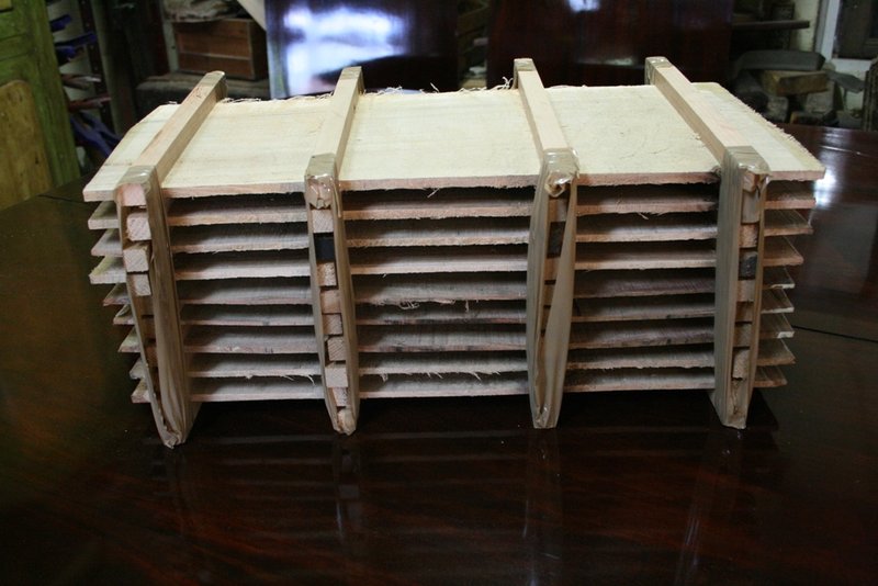

I decided to Rip some backs out and stack them like this, I did it this way with some wet Indian Rosewood that was wet and it dried OK ,
Any one had any bad out comes doing Blackwood this thin ? some are 4 mm some 7 mm
We dipped the ends in beeswax first, I might add a bit of linseed oil to the Mix , the straight hot beeswax is peeling in a few spots.
