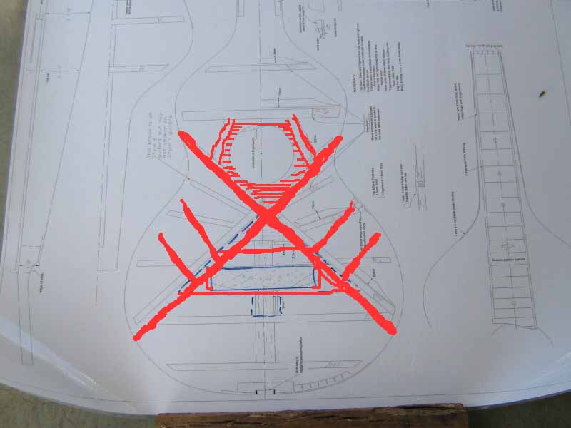

G'day everyone,
Two years back I built two weissenborn guitars from the MIMF (musical instrument makers forum) weiss plan. At that time it was my first go at guitar building so I followed the plan. After building the guitars there is one issue that I would like to resolve before I embark on making another.
The issue is the bridge rolls forward under string tension and distorts the top. Below is the plan. The bridge size is 150mm x 30mm. Located according to the plan the wings do not pass over the X-Brace. When I built mine this issue was made aware to me so I made the bridges longer at 170mm but that did not fix the problem. For the bridge wings to pass over the X-Brace with the X-Brace positioned where it is the bridge would need to be over 200mm long and would not look so good on the guitar plus it may impare the tone. There is a triangle piece set in the X-Brace extending toward the bridge patch. which is 4mm thick and the bridge plate is recommened 2.5 mm thick. The problem as I see it is the area between the bridge patch and the triangle piece.
Below is a picture of an early teardrop Herman Weissenborn teardrop guitar. It has what is now been called a X-mas bridge patch. I reckon this design change may fix the bridge rolling problem and give the top much more structional integrity.
Any thoughts, recomendations greatly received.
Thanks in advance for your interest and advice.
Post by Kim » Tue Aug 18, 2009 12:12 pm
Alan,
A bridge can only roll if that area of the top directly behind the bridge is allowed to belly up and that area can only belly up if the area in front of the bridge is allowed to sink into the sound hole which is a notorious weak point of any "X" braced instrument.
I would look at closing the "X" brace a little so that it crosses the tips of the bridge. You could also lengthen the bridge a 'little' more then the plan indicates so that you do not need to reduce the free area behind the bridge too much when you close up the legs of the "X". I would also look at enlarging the bridge plate a bit, but not so much as in your example because I think it's over kill and will reduce the instruments potential to amplify.
I would also consider realigning the finger braces to be more perpendicular to the "X" so they come into play to resist the rotational force of the bridge plate and also glue in a cross grain soundhole patch to sure up the entire area between the front of the upper "X" legs and the UTB.
This is pretty rough and exaggerated, but sort of like this.

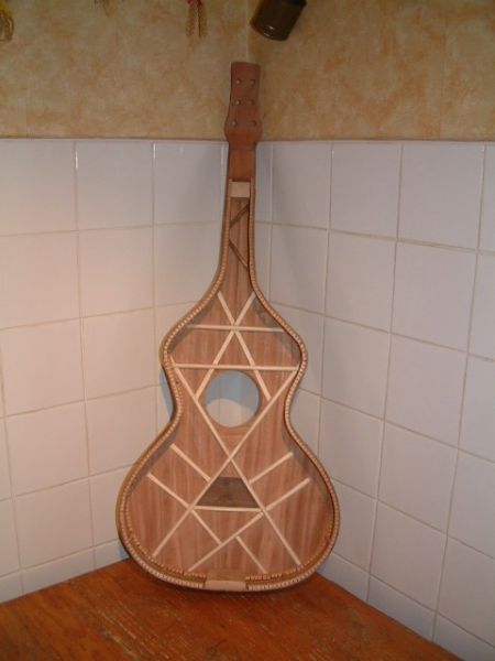

As you know I did my own thing on the bracing on mine and three years down the track it's a solid as a rock in terms of the top geometry. My X brace angle is the usual 78 degrees. I spent most attention on the soundhole up to start of the hollow neck area using my usual soundhole patch and A frame braces but modified as there is no neck block:
Dave White

Post by ozziebluesman » Wed Aug 19, 2009 9:43 am
Kim: I thought of moving the X-brace toward the tail by about 15mm and then move the scale forward toward the soundhole by 15mm then use a little larger bridge footprint and that would place the wings of the bridge over the X-brace. My thoughs with the X-mas bridge patch was to make it 2.5 mm all the way. Just an extension of the bridge patch. The triangle piece in the plan is 4mm thick so by making that area 2.5mm it should not change the stiffness of the top much? I did use only two finger braces each side on my guitar but aligning them by your suggestion makes good sense. Thanks mate for your input.
