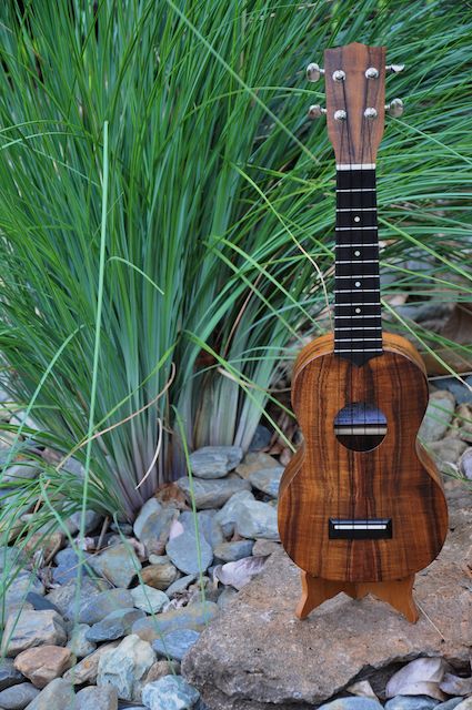

Been a very long time since I've managed to have time to build a simple "entry level" instrument. This one managed to get completed in between all the other action in the workshop over the last few months. Completing all the parts separately when I had a little spare time and then just set aside while more pressing matters needed my attention. The beauty of this is that when it does come time for assembly the whole thing comes together in what seems like a few hours.
Anyway, the body is make from some nicely coloured and figured Koa that was an orphan guitar back set. Neck is Qld. Maple and fret board and bridge are Indian Ebony. Finish is 30% gloss lacquer that gives a really nice silky finish that looks very much like a hand rubbed oil, but provides much more protection. Finish is right off the gun. All done in one day. :D

Not yet. Just got strings on it today. Always good to find new homes for them, but wouldn't mind to have this one hang around at least until the Cairns Uke Festival. It's the only soprano that I've got, and wouldn't mind the exposer that the venue presents.

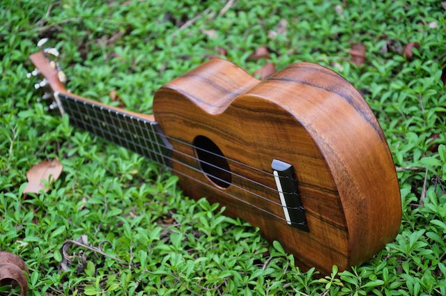

A la metallic tiny green (fruit?) fly 8) Thought it'd pop in for the shot - dared by a nearby mate no doubt :D Probably drunk on fermented nectar of the umbrella tree flowers... again... :wink:

You're the first to spot the fly Jeremy. Was making a point of getting it in the shot. We had a big blue butterfly hovering about but got camera shy at the last minute.
