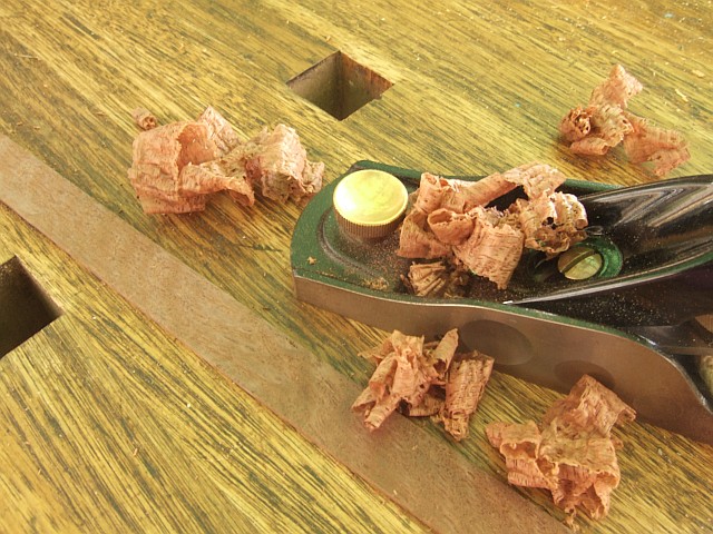

You will all have seen pictures something like this - continuous fine shavings from a piece of curly wood, in this case Jarrah.
Veritas Hi Angle.jpg (128.96 KiB) Viewed 8790 times
So what's different?
Well, it's what this blade went through before I got to this.

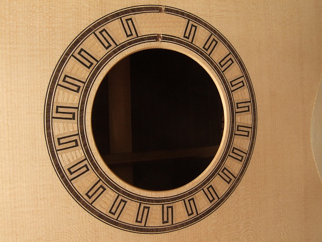

First, I sharpened it and used it to level a rosette; a combination of face and end grain:
Then, a few days later, I used it to straighten out the edges of some bandsawn Perspex, then to do a similar job on some bandsawn polycarbonate (jigs) and THEN I needed to take a few thou off a 500mm length of aluminium, so I used it for that, too. It planed it rather well and left a smooth, shiny finish. And then I did the curly Jarrah, a few days after that. No resharpening over any of those jobs.
How cool is that?
The plane is a standard angle Veritas bock plane with the standard blade sharpened at a 40 degree bevel to give a 60 degree cutting angle.
(Now maybe they'll send me one of their flash new ones for free! :lol: )

I'm impressed that you would set to a piece of aluminium with a Veritas plane! But it's testiment to the blade that it came through that and went on to produce those Jarrah shavings. Think the least they could do for you now (after that endorsement) is supply you with a Veritas tool of your choice! :wink:
