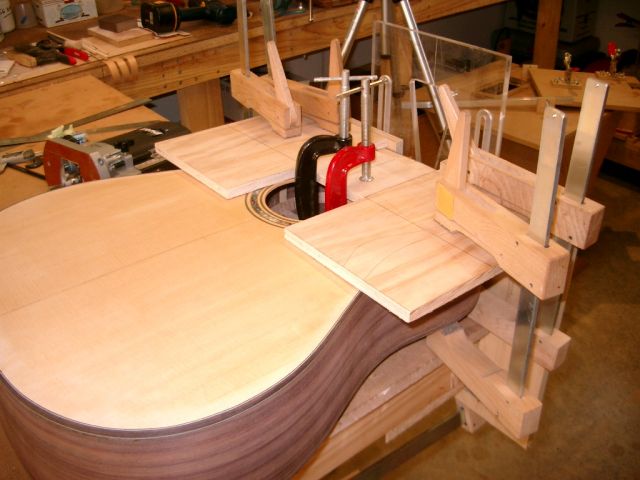

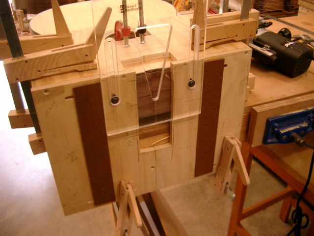

The first lot of pics shows the body of the guitar set up in the jig I use for cutting the body mortise. The jig is the end product of consulting numerous texts and journal articles on the subject. Before jigging up the body I make sure the front of the body where the heel will be in contact with same is perfectly flat. if its not flat then youre wasting your time. The cutter in the router is a Stewmac dovetail cutter. The templates in the jig are also from Stewmac.

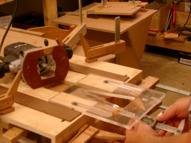

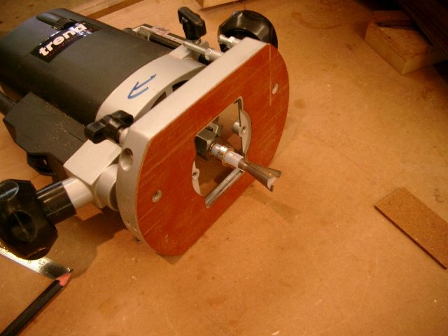

Pic 1: hogging out with a straight cutter..think it was an 8mm double fluter.

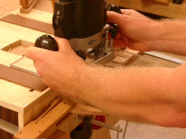

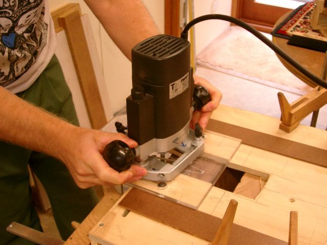

Pic 2: Cutting with the dovetail cutter. Router depth stop slipped halfway through this operation leaving depth of mortise a bit larger in one spot. Not fatal but I should have checked the depth stop..the things can work lose during a cutting session.
Pic 3: Checking height of the mortise withy the caliper. I want about 75mm at the back of the mortise to match the height at widest part of the tenon.

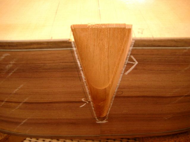

Pic 4: The finished cut. You can see where I cut a bit deeper than I wanted to when the depth stop slipped on the router.

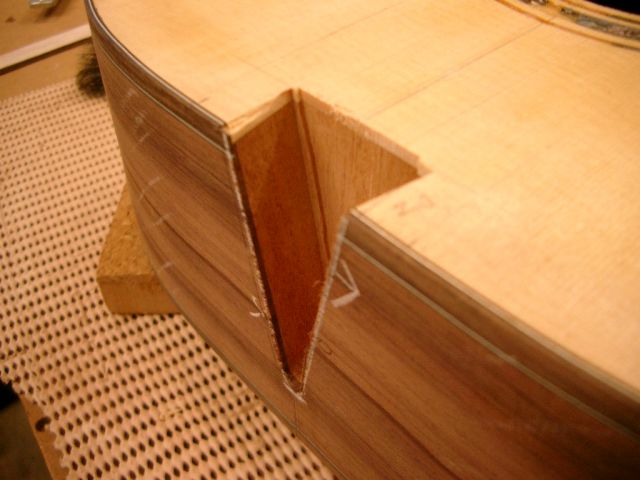

Pic 5: and from the top. A bit of chip out on the top but fretboard will hide same.
