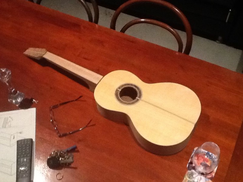

Looking for a bit of advice. I'm making a "copy" of a Regal Tenor as drawn by Antes. I've already reduced the bracing, to a pitch that fits my ear, as all I've read is that the antes plans are over-braced, and I'm happy so far.
Question 1. Does a guitar like this need a truss rod? or could I use a piece of "L" shaped aluminium inset into the neck. I have a mandola truss rod, but I think it'll be a pretty heavy bit and make the neck too heavy....
Question 2. the soundhole is too small to reach thru, so can I use a dowel neck joint on this? or should I re-jig the dovetail jig to fit this little guitar.....Was thinking about a flush cut dowelled joint, as it ought to have much less stress than a bigger guitar.....
As always, I appreciate any input. I guess that one isn't too far offa uke in terms of string tension, and I've seen full-sized guitars with dowelled butt joints.....
Probably should have planned this one better.....

All moot at the moment, tho. I weighed all the accumulated body parts at 620gm and all the neck parts at 400gm...including the truss rod and the neck un-shaped, so I think it won't be neck heavy after all......
Thanks, but....Should be done soon, as long as I can spray when it's ready. Weather looks to be heading in the right direction for that, too....
