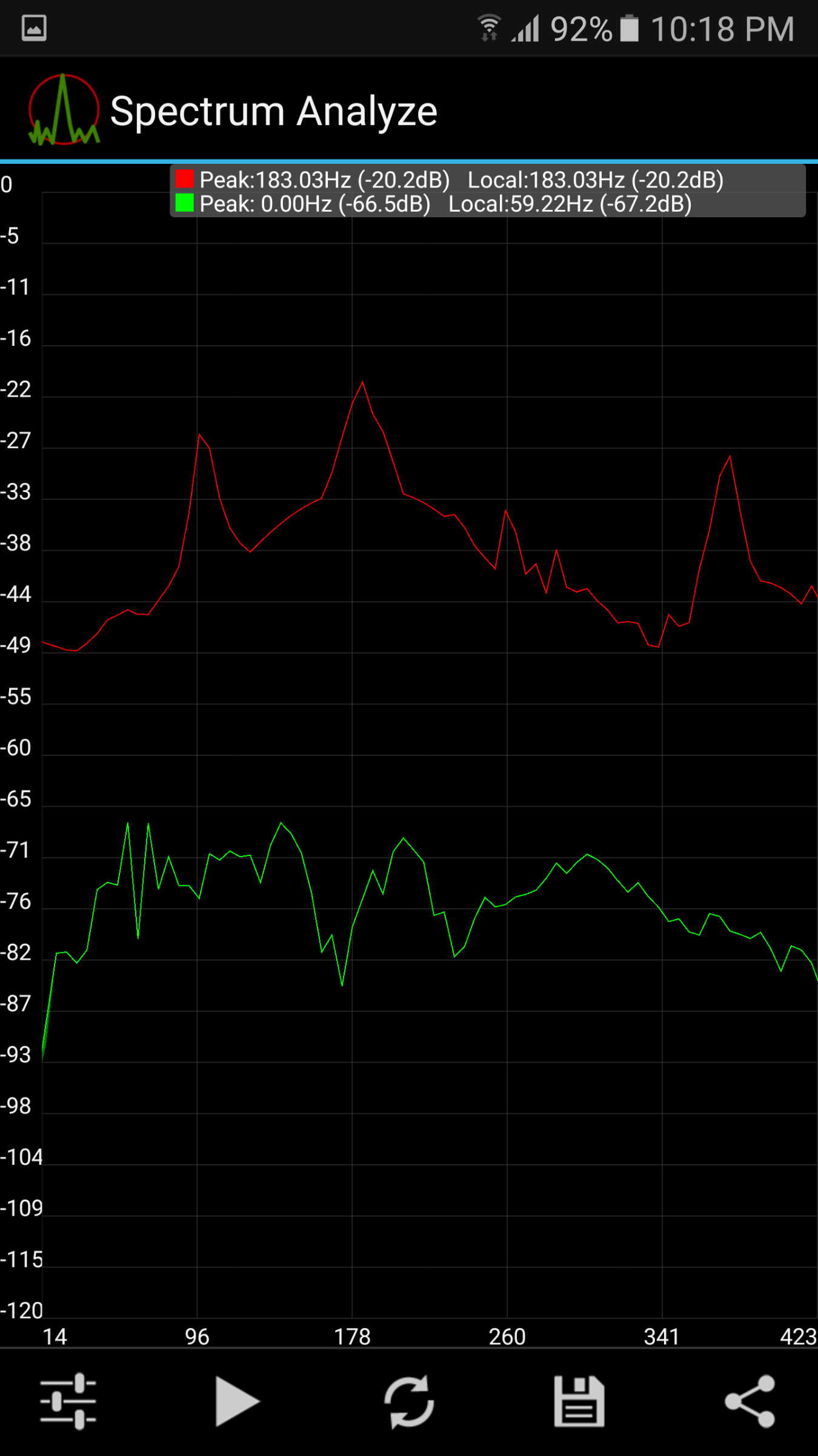

Thought i'd let you all know:
Not sure if anyone else has found this neat little app yet.
Matt from AGMS showed me an app he's been useing for tap tests.
It's available in the Google Play store for Android. Called "Spectrum Analyer" by Raspberrywood.
I was skeptical on how good this would be, but tonight i done some tap tests side by side and compared to my visual analyzer setup (with a shure SM57), and to my surprise on all the tests it was giving the exact same results as per the laptop and decent microphone.
No settings were changed in the app, everything as per the default. :)
Much more convenient for the workshop - I run an old android tablet in my workshop to play tunes through my sound system. Instead of having to take the laptop out there and deal with the fan noise interfering, mic setup etc i'm thinking i'll switch over to this app on the tab.

I've been using this app since i made that post.
Tap tested around 30 instruments in the last 18months, no complaints. I've since also compared to other peoples VA results side by side and continually get matching results.
Love not having to setup a laptop & mic everytime. I even got my phone out and tap tested a guitar in the local music shop - which attracted some strange looks from the staff.
I did end up getting the paid version for a huge $1.99 or thereabouts :) . Can't remember why i upgraded now, think there was a feature i wanted that wasn't in the free one.
I've hacked it abit so that the data is saved from the tablet directly to dropbox as a CSV. This means I do a series of tap tests, then can go to my office open up the computer and all the data is there in a format i can work with.
The app doesnt natively export or save the data in any usable format - i've asked the developer if he had plans to do this but didn't get a reply.
Without this hack you would be limited to taking a screenshot of the results on the phone/tablet which leaves you with a JPG file like what i posted above, so not as nice to work with as the VA data.
