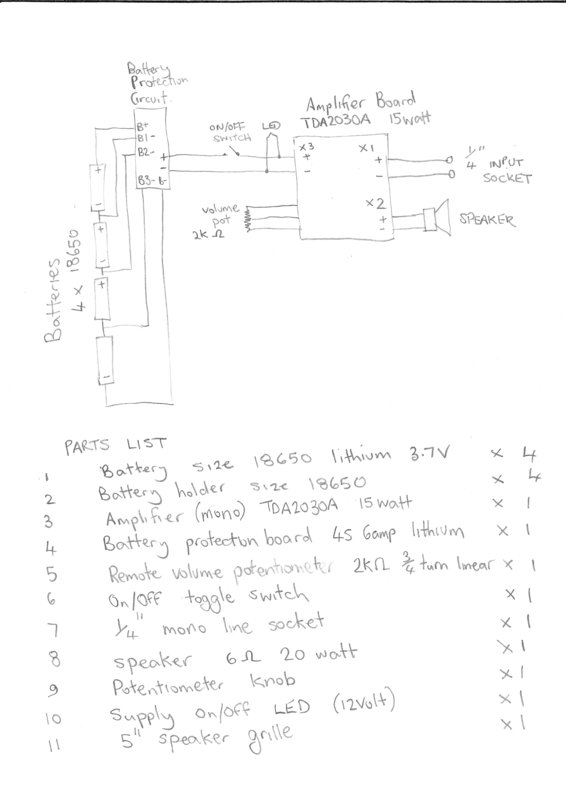

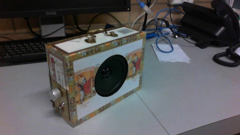

Howdee,
I just finished putting together a little cigar box amplifier and thought I’d add to this post about what goes into it. I understand if the moderators think this is a bit beyond the pale for a luthier’s forum but the original poster asked for some details. It’s a fun little project to go with a new quilted maple with MISI pickup soprano uke that I’m making for my daughter. The batteries, battery holders, battery protection board, speaker grille, amplifier board and cigar box all came from ebay . The switch, LED, socket came from Jaycar. All up the project cost about $40 but half of that was for the batteries and charger. I don’t have any ukes here with pickups but I plugged in my mobile phone to test it and it sounds surprisingly good and loud. Heaps loud enough for busking which was the reason I made it.
A few things about the build that might not be apparent from the pictures. Lithium batteries are damaged if over discharged so there is a little circuit board tucked up behind the side mounted battery which interrupts the supply to the amplifier before damage is done. I could have charged the batteries in situ but with all of the stories around about them catching fire I decided to remove them from a wooden box for charging. I only finished it today so can’t offer any information about how long the batteries will last but it should go for a least 4 hours at full volume based on amp efficiency, max power output and battery capacity ( at least I hope so). The 15 watt mono amplifier (which comes preassembled) has the volume pot hard soldered onto the board. The pot didn’t have a threaded front bush so I couldn’t desolder it and remote mount it through the side plate and had to buy a replacement. It was a fun and easy little project and a nice diversion from uke making. The wiring diagram and parts list at the end of the pictures should get you started if you want to knock one up.
Paul
