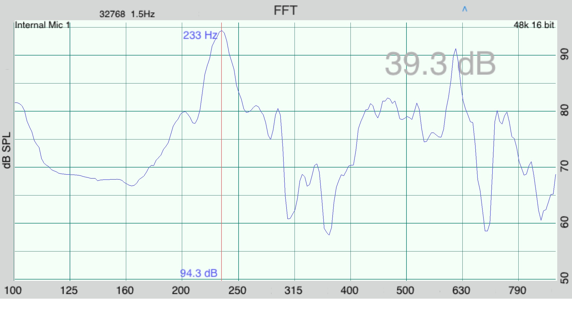

For what it is worth, here is a shot of the resonance curve on my most recent petite bouche. I see now there is a bit of a bump around 200hz which I suspect is the octave of the air resonance at 100hz. It may well be a contributing boom factor. T(1,1)2 is 233hz and t(1,1)3 is 296hz. Not sure what the bump between 233 and 296 is though I see it fairly often.
