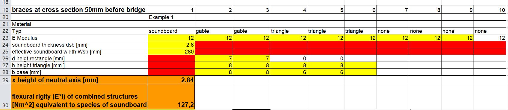

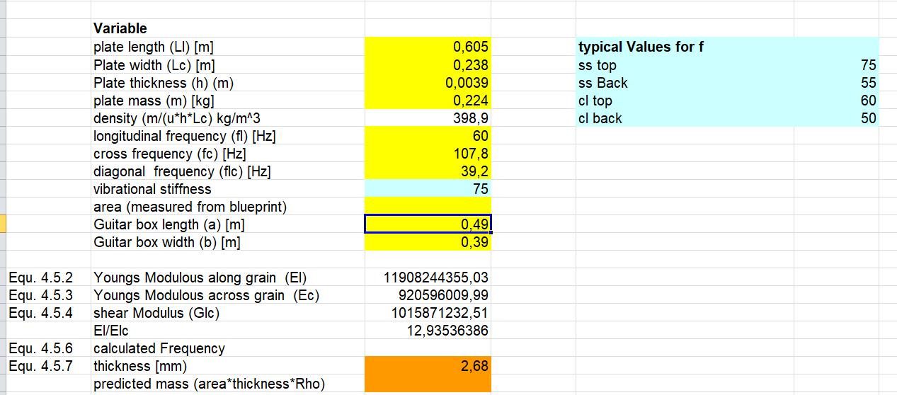

After a quite long break due to my job I continued work through the Book to start with the excel sheets for target thickness of the soundboard and the flexural rigidity of the soundboard including braces. First the calculation of the predicted final thickness:
Example 2 from Table 4.5-3 reproduced
So far so good, now to the brace section:
Example 1 from Table 4.4-2 (brace stress…) to test my excel sheet with known values:
Works as well.

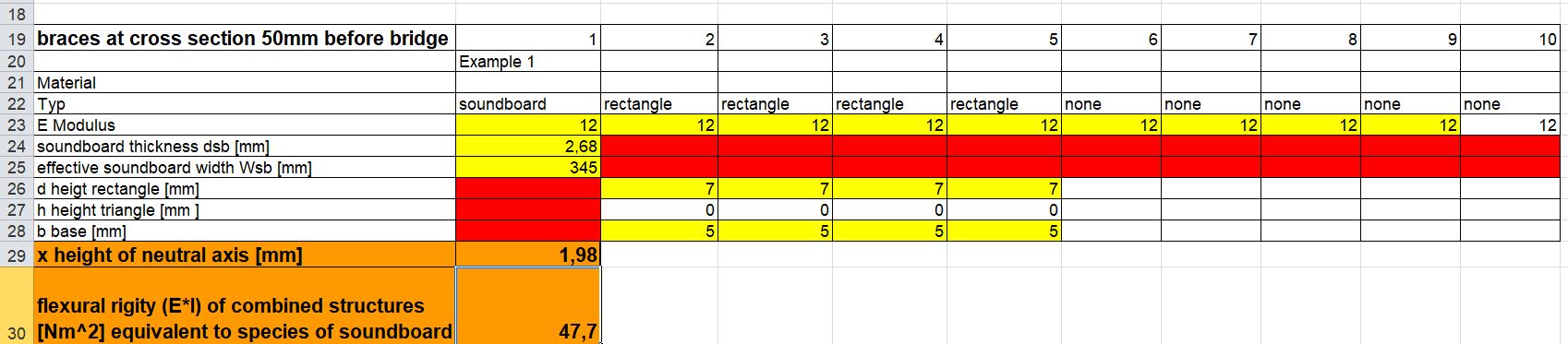

1. When entering the values for a falcate steel string taken from the plans I have an effective soundboard width of 345mm in 50mm distance to the bridge (btw. I assume I start measuring in front of the bridge and not at the position of the saddle), the cross section in this case shows 4 braces with 7mm height and a base of 5mm. This gives me an EI of 47.8Nm^2 if I take for the soundboard and the braces the Engelmann spruce from the example above. Which means I would be exactly where I should be for a falcate steel string but without carbon fibres. Somewhere in the forum Trevor wrote one should never go below 7mm for the falcate braces of a steel string. But if I add the carbon fibre EI will increase again. So how should I reach the goal of around 50Nm^2? Or where did I go wrong?

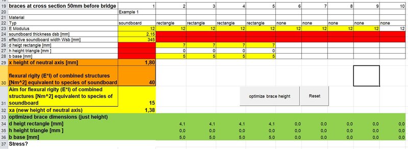

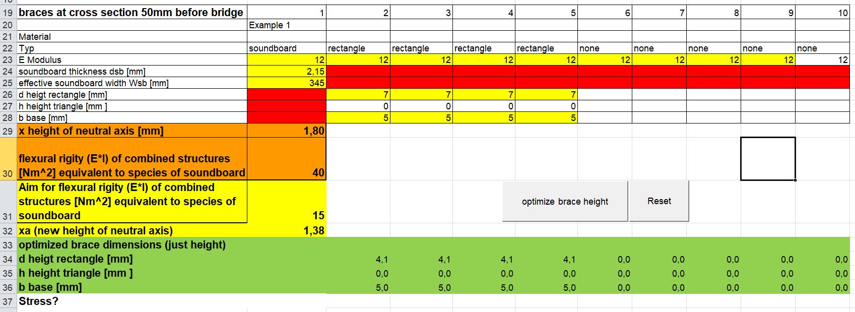

2. To build a classical with falcate bracing I change the vibrational stiffness parameter in Equ. 4.5-7 to 60 which gives me a target thickness of 2.15mm. Let´s say I keep the dimensions of the steel string and put the numbers into my spreadsheet for EI. The result is 40Nm^2 for unchanged braces. To get to 15 I need to change the braces somehow. I decided to change the height and used the built in optimizer of excel . This give me a height of 4.1mm (again without carbon fibre). Is it possible to calculate this way?

I don't recall saying don't go below 7mm (I may have, but there are few absolutes in guitar building!). If you check out Table 4.4-1 you'll see that adding CF to a 7 x 5mm brace gives you about 25% increase in flexural rigidity (EI) of that brace. If you punch the numbers into a spreadsheet for the whole braced top assembly (using the full parallel axis theorem), that's not going to give you a 25% increase in flexural rigidity for the whole assembly; it will be quite a bit less than that. I haven't done the calc, but if your answer comes out 5-10% stiffer overall, you'll be in the ball park. To make a 25% reduction in just the brace stiffness with CF, you will only need about a 0.5mm reduction in brace height. The primary purpose of the CF is to guard against cold creep rather than add stiffness for less mass.JurgenV wrote: ↑Tue Jun 25, 2019 5:34 am1. When entering the values for a falcate steel string taken from the plans I have an effective soundboard width of 345mm in 50mm distance to the bridge (btw. I assume I start measuring in front of the bridge and not at the position of the saddle), the cross section in this case shows 4 braces with 7mm height and a base of 5mm. This gives me an EI of 47.8Nm^2 if I take for the soundboard and the braces the Engelmann spruce from the example above. Which means I would be exactly where I should be for a falcate steel string but without carbon fibres. Somewhere in the forum Trevor wrote one should never go below 7mm for the falcate braces of a steel string. But if I add the carbon fibre EI will increase again. So how should I reach the goal of around 50Nm^2? Or where did I go wrong?
Yes, it is. However, you're usually looking for a higher T(1,1)2 on a classical than on a steel string, so you have mass effects to consider. The "50mm in front of the bridge" rule is a simplification to help you get in the ball park. It clearly excludes the effects of bridge mass and stiffness which is a significant variable on classical guitars. You can see from Fig 4.4-9 that there is a very wide spread (a factor of 5) in EI over a range of historical guitars.JurgenV wrote: ↑Tue Jun 25, 2019 5:34 am2. To build a classical with falcate bracing I change the vibrational stiffness parameter in Equ. 4.5-7 to 60 which gives me a target thickness of 2.15mm. Let´s say I keep the dimensions of the steel string and put the numbers into my spreadsheet for EI. The result is 40Nm^2 for unchanged braces. To get to 15 I need to change the braces somehow. I decided to change the height and used the built in optimizer of excel . This give me a height of 4.1mm (again without carbon fibre). Is it possible to calculate this way?

Concerning the braces with and without carbon fibre... yeah, I should have checked that first instead of just guesssing. According to my spreadsheet it´s around 0.6mm I would have to remove.
