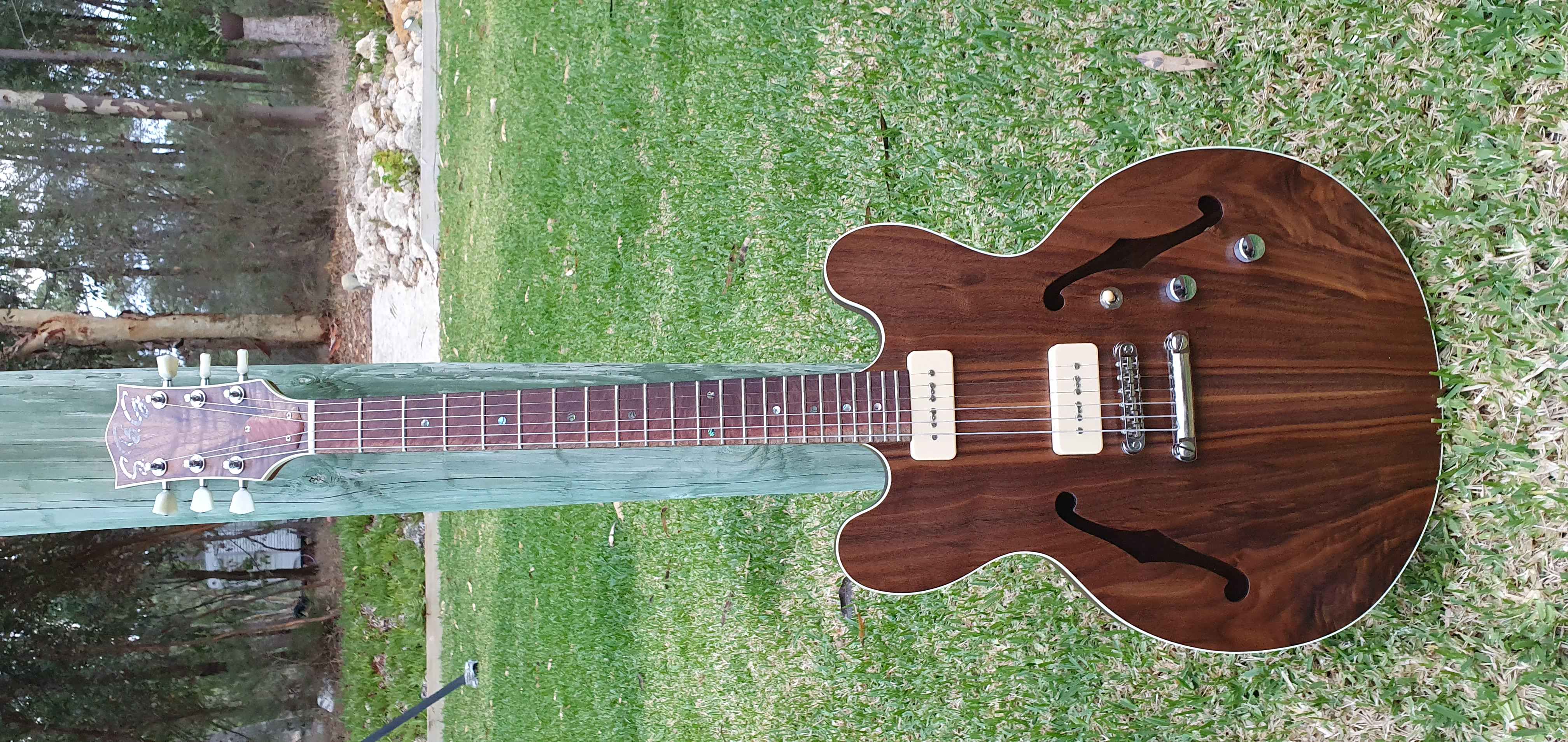

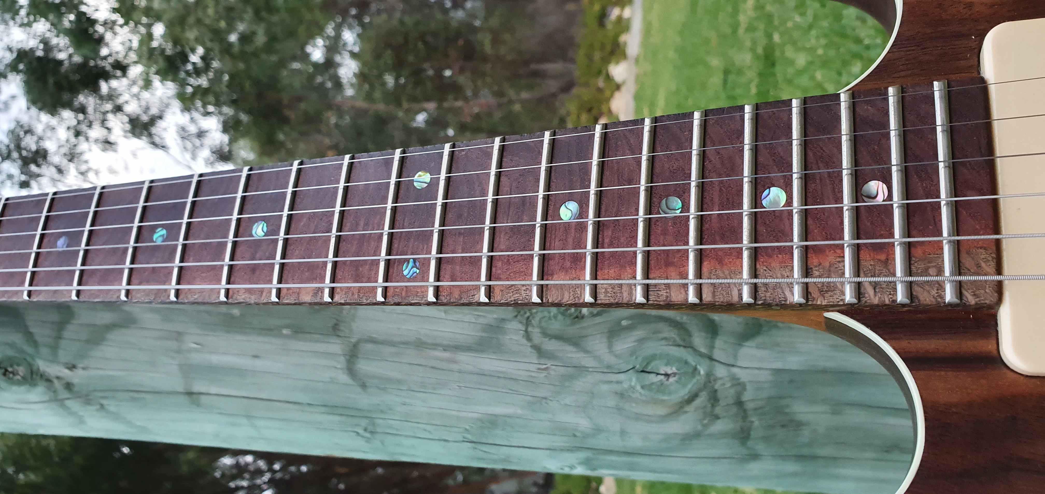

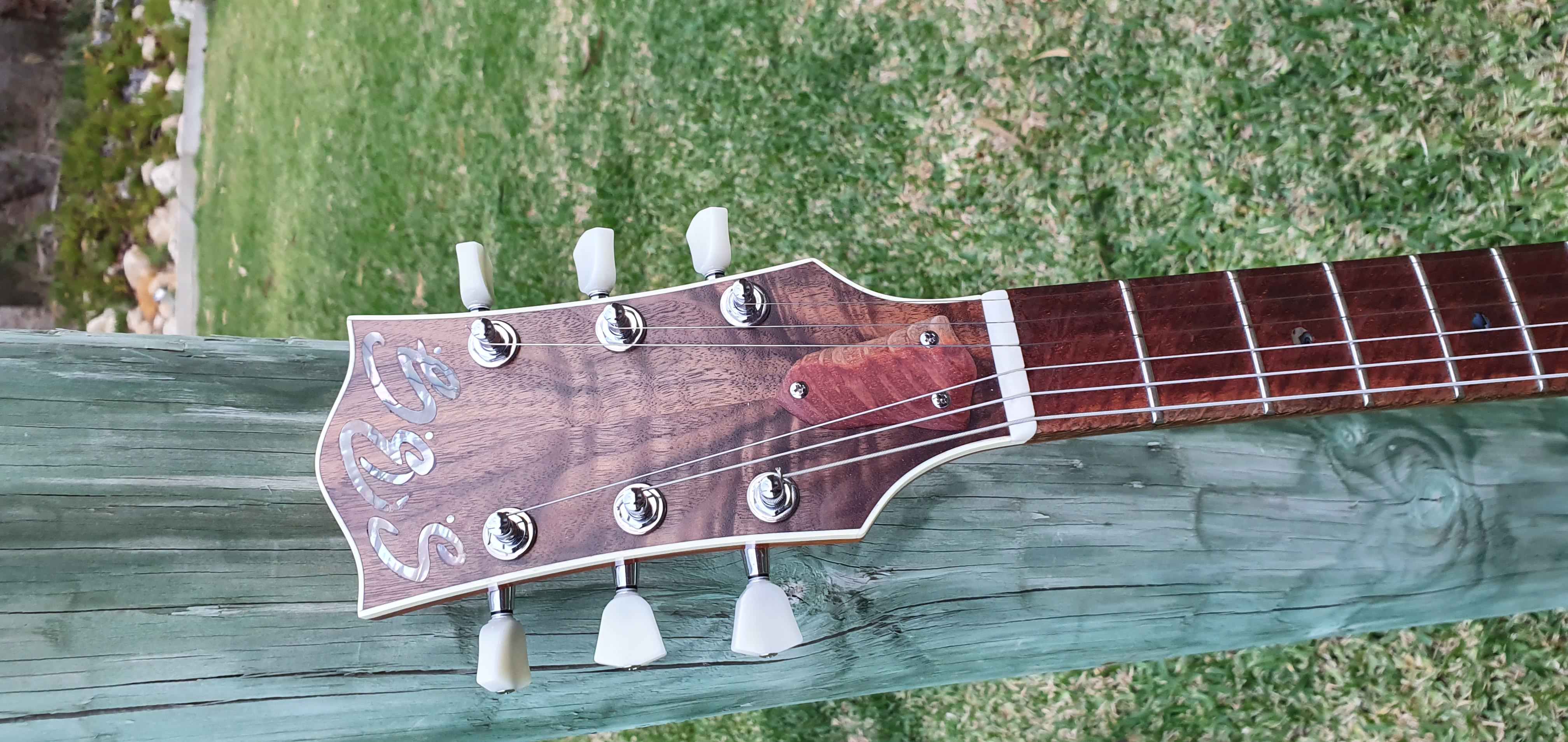

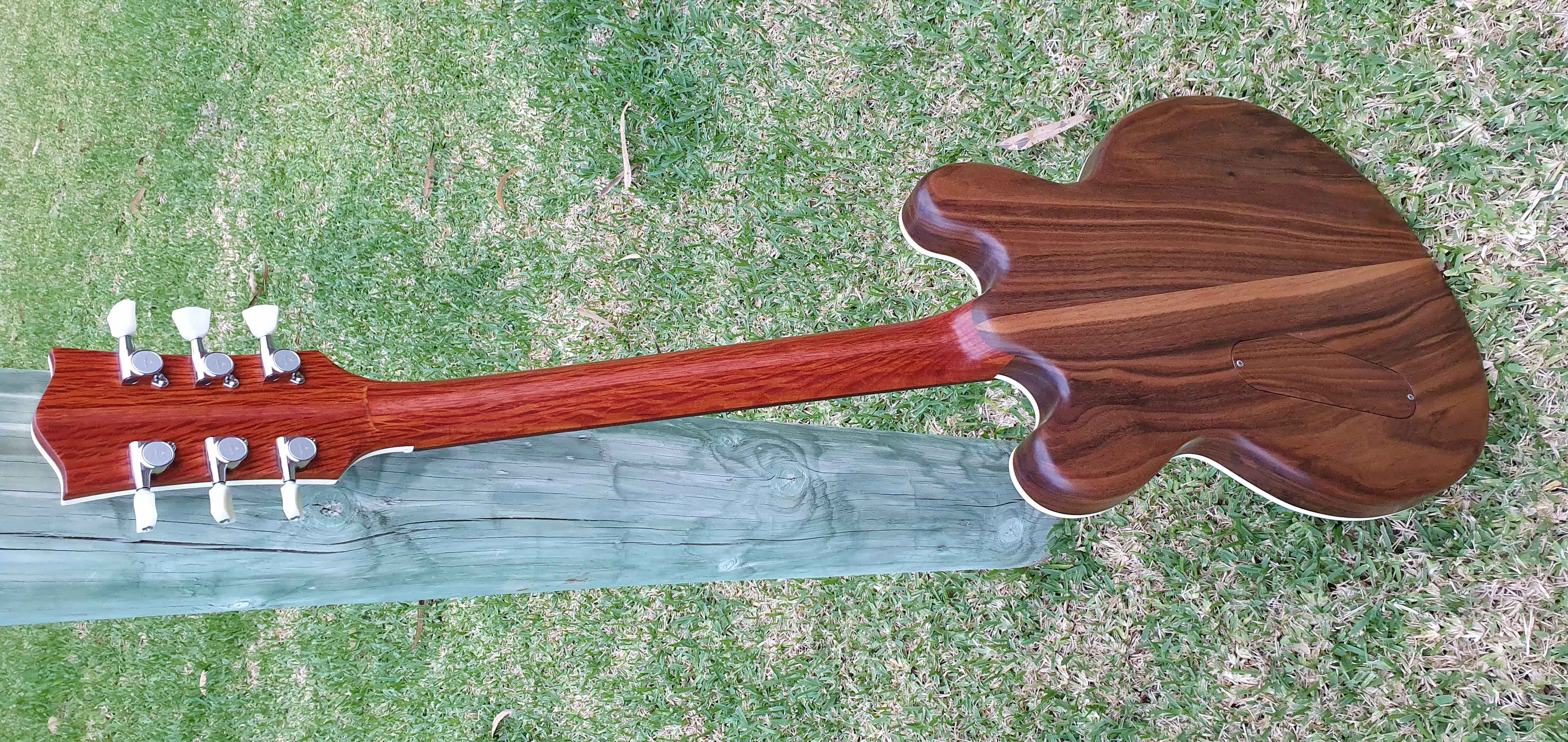

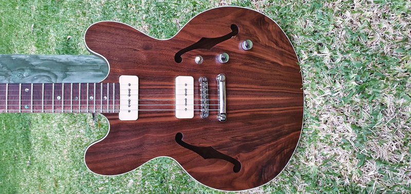

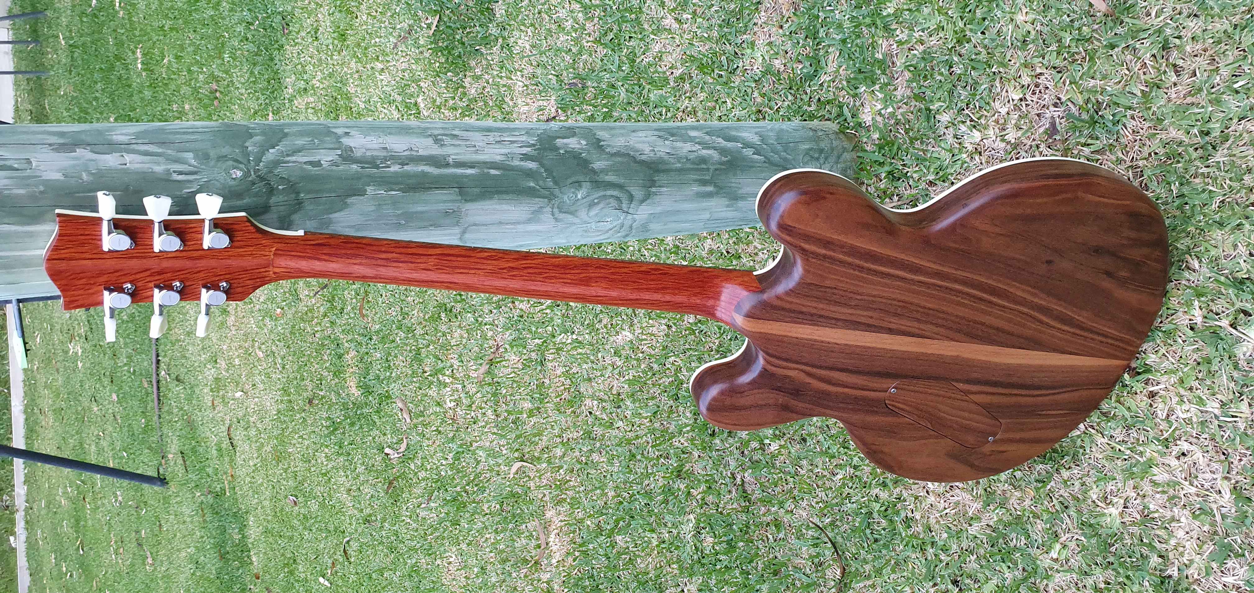

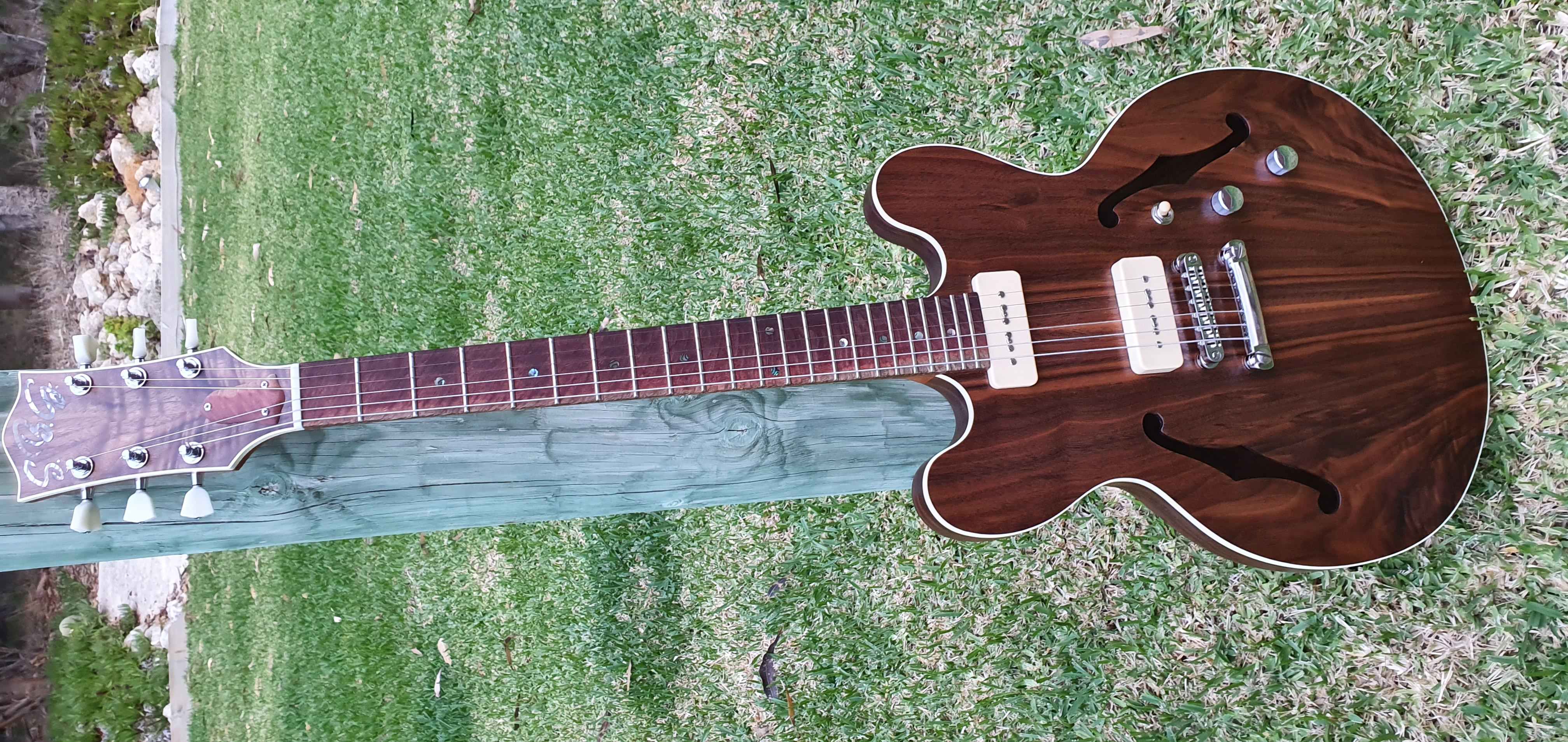

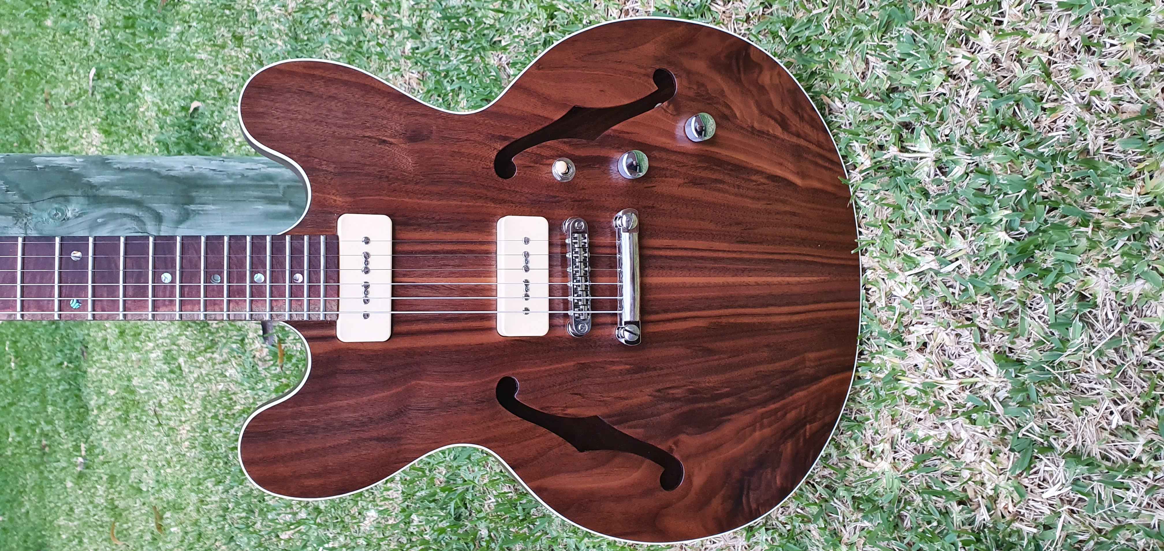

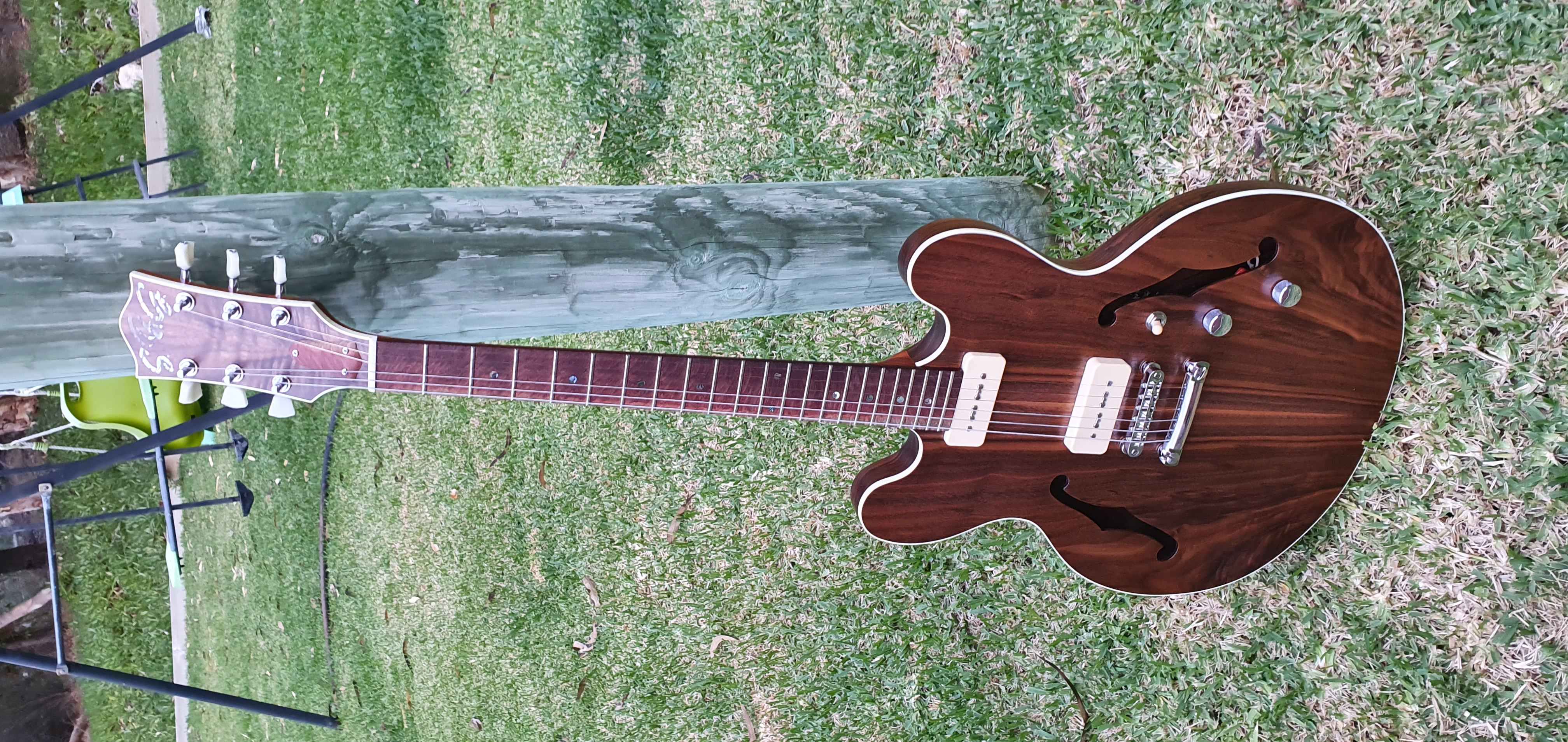

Finally getting around to posting a couple of my latest builds over the last 6 months. Finished the hollowbody about a month ago, es335 shape and scale length but rest is a bit different. Body is black walnut i got from austim and the neck is sheoak with a jarrah center strip because the sheoak blank was twisting a tiny bit, fretboard is woody pear, probably a touch soft so i put plenty of glue in with the frets to make sure they hold. The hardware is gotoh and tonerider p90s which sound great, i mostly use toneriders. Was my first crack at a semi hollowbody and scarf joint style set neck. Very happy with it, plays and sounds amazing.

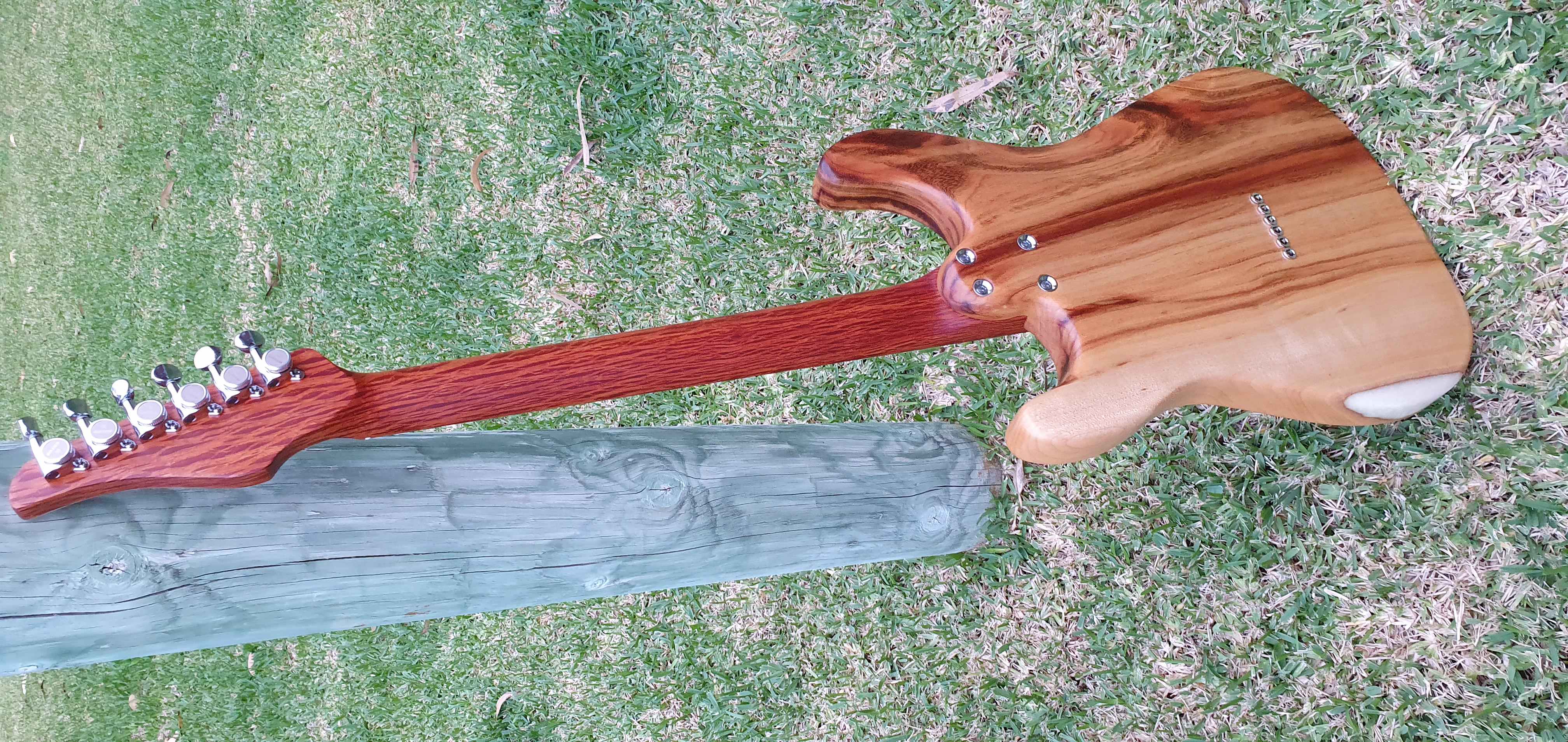

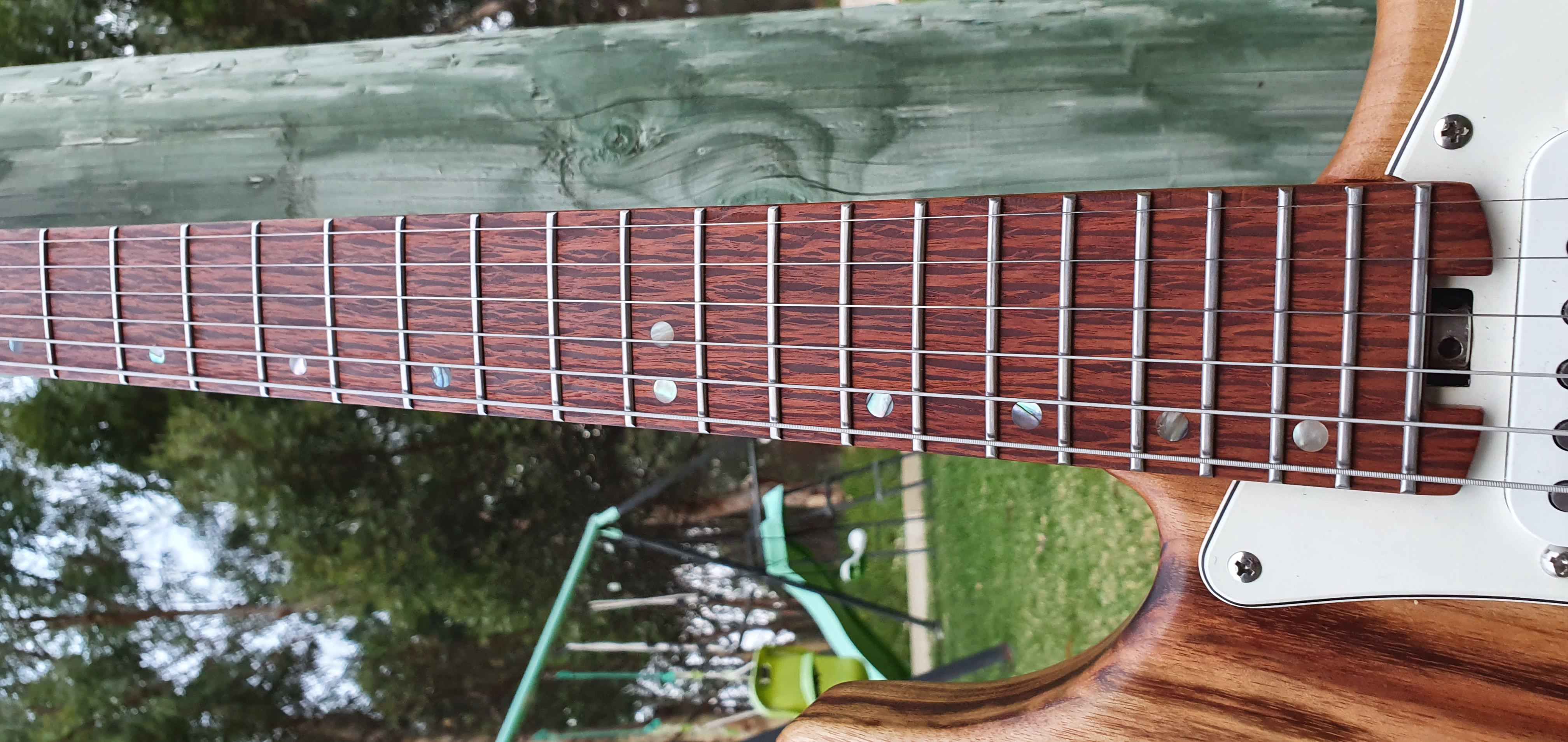

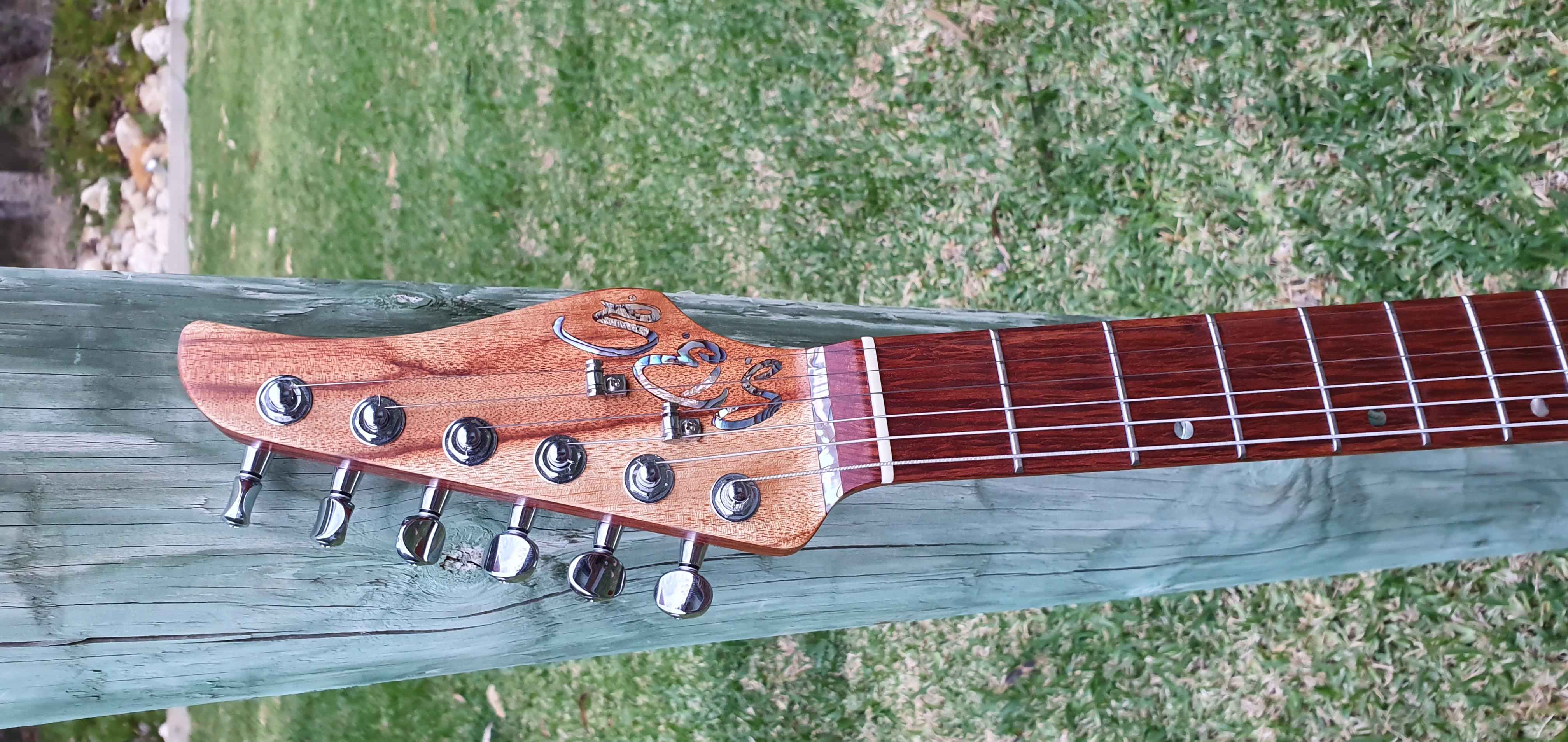

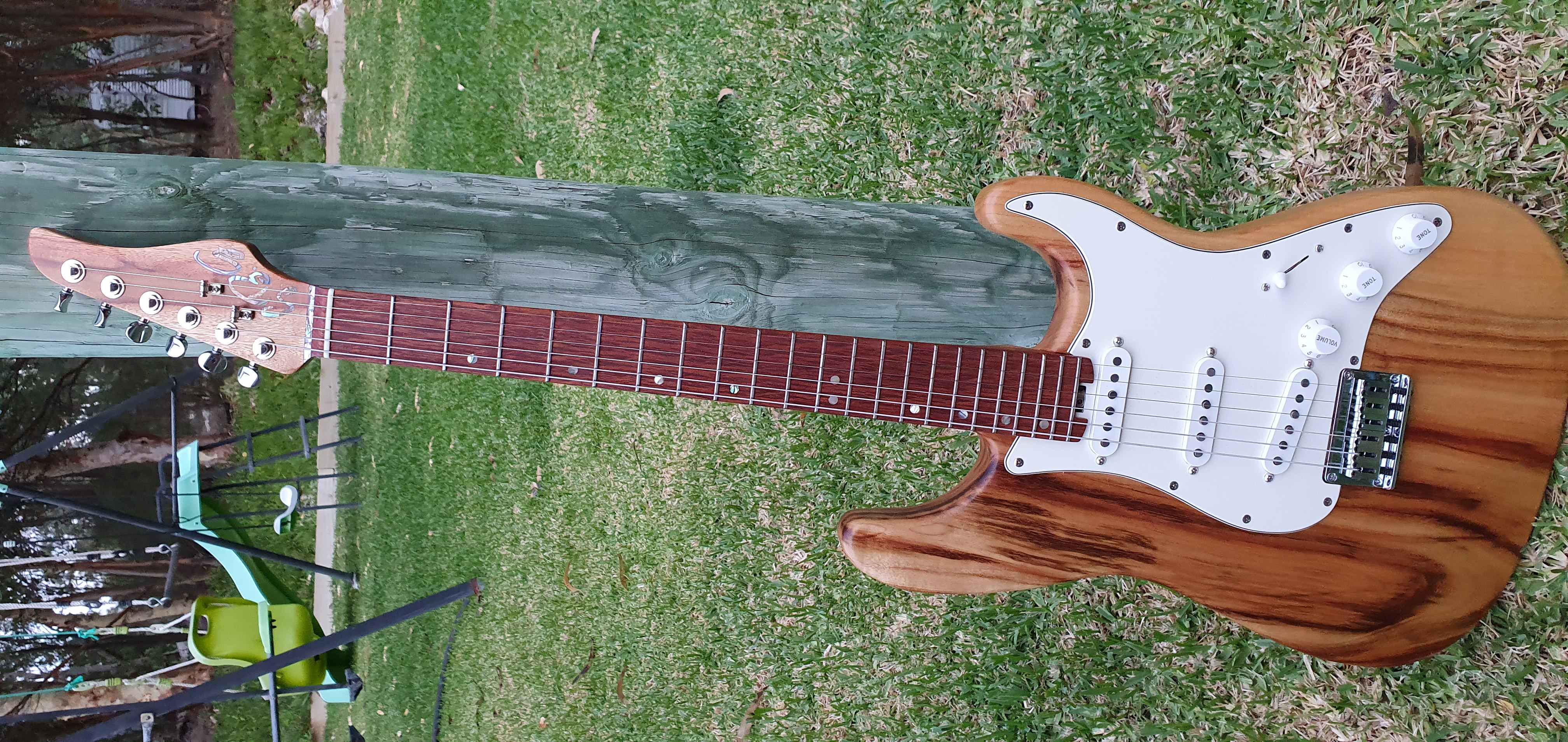

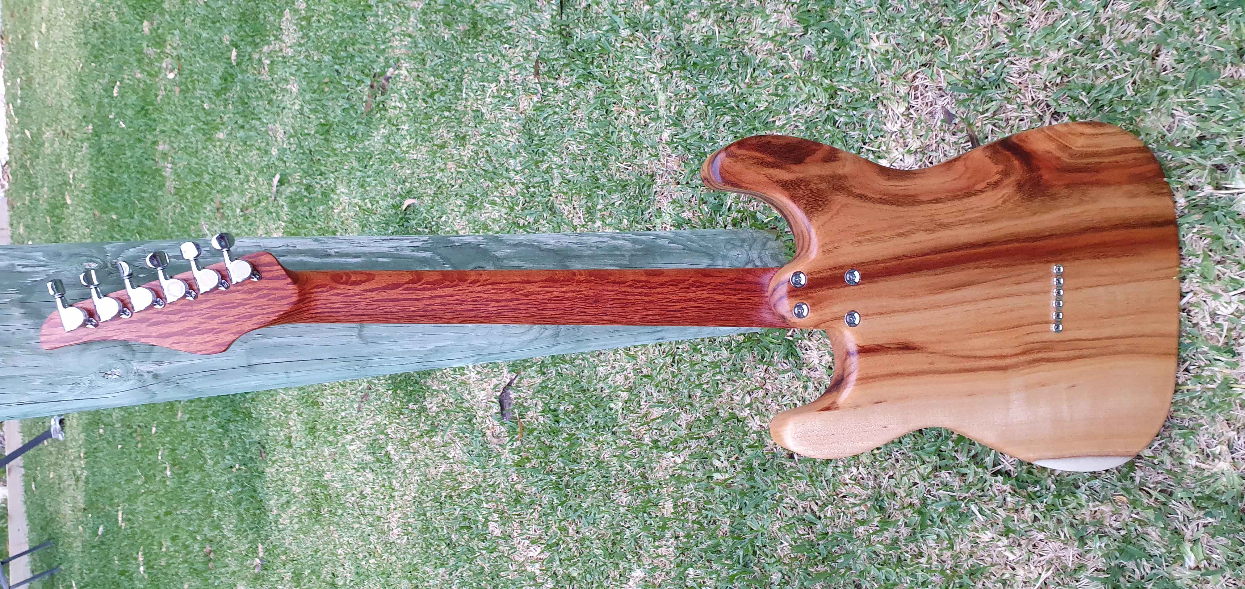

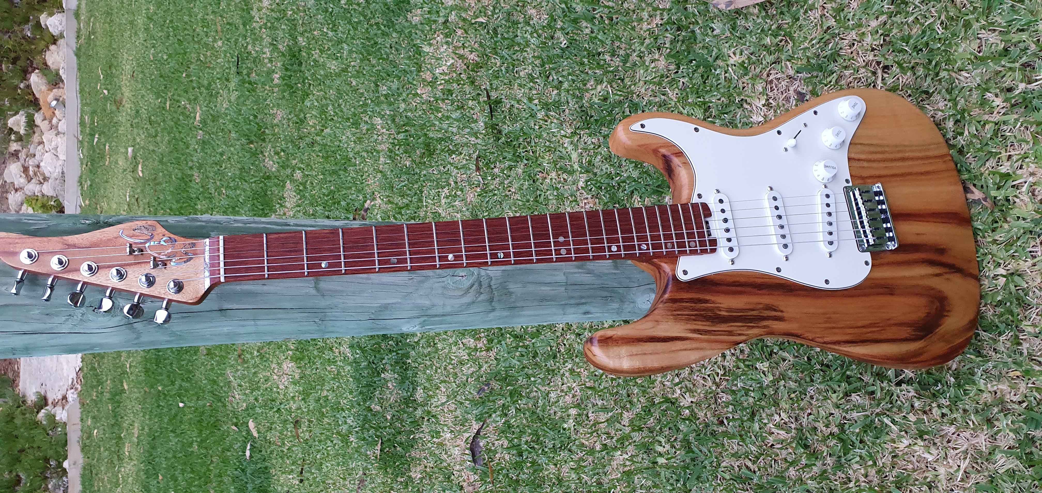

The other guitar is a hardtail stratocaster style solid body. Body is camphor laurel and sheoak neck. All hardware is gotoh and i used fender tex mex pickups. Sounds and plays great but i would like a good guitarist to have a play of one of my builds, maybe get a bit of constructive criticism😆 I started doing the inlay design on this guitar and ill keep it up in case i ever get a chance to sell one. Just a hobby at the moment and still lots to learn.

They look great. I've been wanting to try the Tonerider P90's for ages. I'm a bit of a Tonerider fan myself and I've mostly used their A2 humbuckers. Don't recommend the Rock Song pickups, they sound congested to me and I can't get them sounding good at all.
Where did you get the wood?

Thanks mate. Ive got a vintage p90 in the neck, hot in the bridge and a hot p90 neck in another guitar and all sound good. There paf humbuckers sound good too and good price. The walnut is from austim in wangara, i got the camphor laurel from Donnybrook and the sheoak is local stuff i milled with a chainsaw. Used it for all my necks and really nice for fretboards too.

Electrics are not my thing but those two look really smart. The neck woods in particular look great.

Great electric guitar build! Like all your timber choices and finish.
