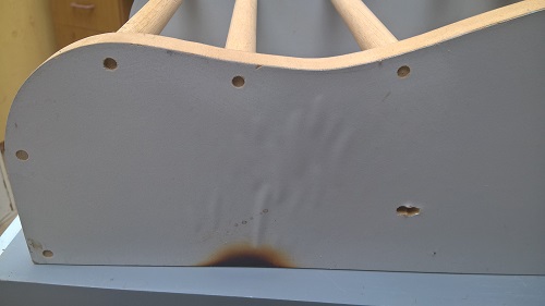

I've been using 3 x Tastic lamps and just to confirm the advice from others here's a shot of one side.
I've been using the plastic bases and they don't tighten up too well. The lamps tend to flop about a bit at times. They're also a bit cramped in there.
I think it's time to consider a heat blanket😊

Wow Pat,
That looks like you may have just avoided a major disaster.
It’s why I’d like to be able to monitor the temperature.
