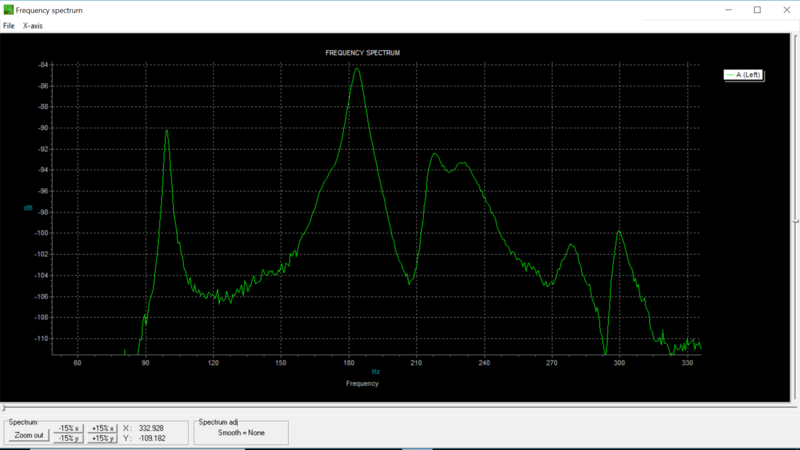

I would have thought after two successful builds using falcate bracing and spectral analysis, I'd have a better understanding of it all. This plot has me confused though. The T(1,1,)3 has a double peak at ~218hz and ~230hz. This is consistent after many plots, and the amplitude of both peaks is often similar. Do I use the low frequency, the high frequency, or average the two?
I also had, (from my limited experience) a larger frequency drop of T(1,1,)3 from one construction point to another. After the box was finished with binding it was at 230hz. After lacquer it dropped to 226hz. And with bridge, pins and saddle (25g) it went to the plot you see here, ~218. This is a larger drop then I saw in my two other guitars. All are the same OM size.
The T(1,1,)1 & T(1,1,)2 ended up place pretty well at 99hz and 183hz, but the desired four semi-tone separation between T(1,1,)2 & T(1,1,)3 is not there if I use the 218hz. I'm considering gluing on a scab to the backs main transverse brace and reshaping it to stiffen up the back a bit. I've done Monopole testing, but I think I need to rework my spreadsheet because the results didn't seem within reason. The deflection of the back was .22 with 1000g and a freq. of 207hz with the sound hole plugged.
Does anyone have a suggestion as to the cause of the double peak, which one might be most accurate, and what the sonic ramifications will be? Of course, I will string it up soon and find out, but I'd rather not have them on if I have to get into the box to work on the back brace.

One of the double poles may be another top mode like the cross dipole. The first of the double is probably your back.

If you look ten topics down I posted the same problem. I had a mode with two peaks. I use chladni patterns and I only get a mode that is somewhere in between the split peak. Maybe we need to use more conditioner on our guitars to repair split ends? Or maybe there’s some better advice. I’m sure Trevor has seen something like this before.

I wouldn't worry about it until you string the guitar up and hear how it sounds. I always tap test as I go as a guide to what's going on but only at the end after strings are on and I have listened to the guitar do I think about fine tuning frequencies only if there is a problem.

Sorry I missed your post on "spit peaks", I guess I forgot about reading it. I searched "double peaks" before posting this and didn't find what I was looking for. I'm still lacking a chladni set-up, next on the long list of things to do.
Anyway, after stringing it up and running through the analyzer I was amazed to see the double peak disappear completely. One solid peak at 218hz. Most importantly, the guitar sounds good, one of my best yet. My spread between the Top's Freq. and the Coupled freq. ended up at 39hz. a bit shy of recommended, but pretty close.
One lesson learned: I overly shaped the back's main transverse brace too early in the process. I did it just after the back went onto the rim (no top yet) because the back seemed stiff and had a low monopole. I'll wait until the end to get more aggressive (as needed) with that brace in the future.
