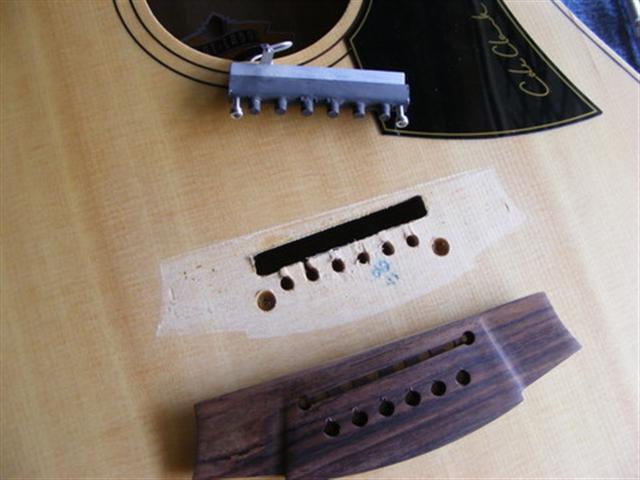

Just a thought Jeff ,could it be possible that the string has cut into the soundboard and is being cut by the metal on the under saddle Transducer, er , I mean under saddle house brick.

Re: String breakage
Um, wow. that's some serious gear. Is that waht they all look like inside?
Yikes
Yikes

Jeff, if you've smoothed the saddle and he's still breaking the same strings then its probably him being heavy handed as you suggest. Maybe he's just not hearing himself in the duo situation and needs a better monitor. To prove that point you could try flossing the saddle in situ right in front of the guy so he can see for himself that the strings have an evenly supported run over the bridge.

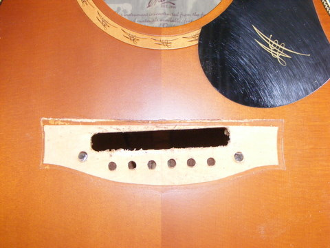

Here's The Maton Nick
- DSCF5503.JPG (48.26 KiB) Viewed 12873 times
Re: String breakage
Just as ugly, the Maton.....Can't imagine it'll add to the stability of the top in the long term....
Re: String breakage
Looks like a maton miniTod Gilding wrote:Here's The Maton Nick
Re: String breakage
There actually pretty stable, especially when you consider your bonding a 5mm lump of rosewood to the top surface, the electronics on the other hand can be very fiddly, individual little magnets with individual caps screwed up under a platennickusa wrote:Just as ugly, the Maton.....Can't imagine it'll add to the stability of the top in the long term....
