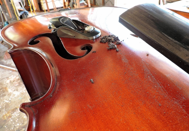

It's a common enough problem. Also, the sound post is usually more to the centre of the bass than even close to the G foot of the bridge. The fb in the photo was replaced. This one has almost 5mm of relief, if I removed the hump around the 4th fret it would be worse.
In the bass photo only the end of the G and D string path needed work. Just showing off my new DX60.
