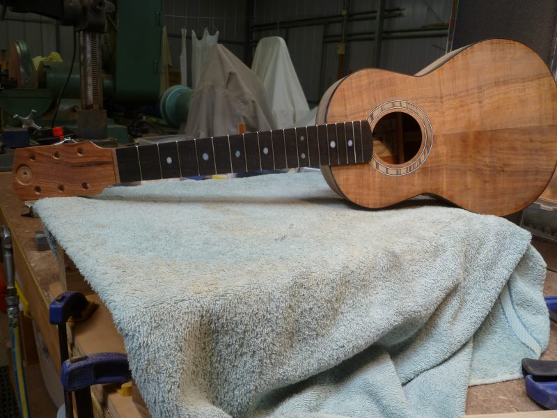

This is the offending unit!
Re: SIX STRING UKULELE HELP
Post by Allen » Thu Mar 05, 2015 5:05 pm
Yes, you have to be careful with those tuner positions. Very easy to get it wrong and have a string riding against the post of the one closer to the nut.
Post by hooked » Fri Mar 06, 2015 6:10 am
Yeah good call Nick. I didnt even give it a thought until a musician friend who had played my previous uke builds advised me to watch my machine head placement for the six string. As I had already shaped the headstock and drilled the holes, I had to remove the laminate, plug the holes, add material to the bottom of the headtock, reshape, redrill relaminate......whew!
I will use your suggested method next time THANKS.

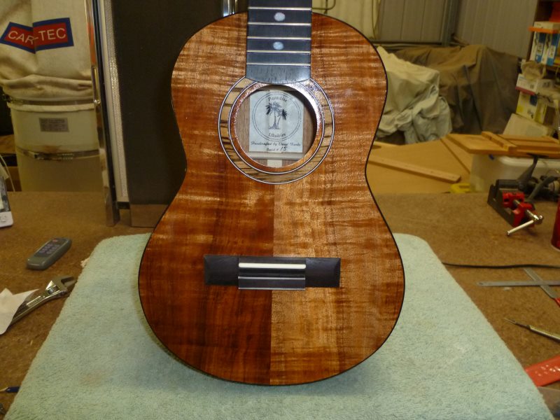

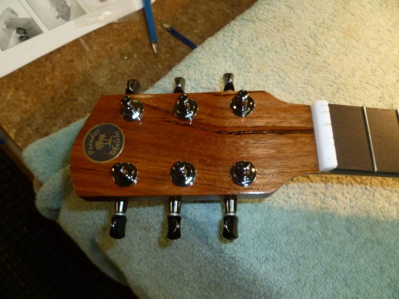

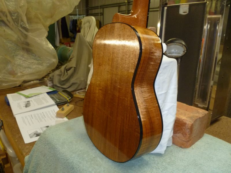

Post by hooked » Wed Apr 08, 2015 12:49 pm
THE FINISHED PRODUCT (Less Strings)
