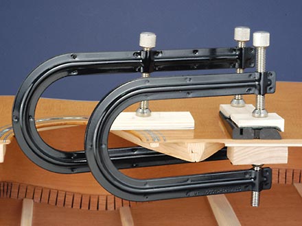

Clamps for bridge glue up......I generally use long reach clamps specifically designed for bridge work. A caul for clamping up a classical bridge is usually custom made for each instrument as brace, bridge dimensions are variable. Its normal to make up a caul when the top is off the guitar but for a repair job one trick is to put a bright LED light inside the guitar and then trace brace and bridge patch (if present)layout onto a piece of paper laid over the top. From this drawing a caul can be made up. What sort of glue do you plan to use for the bridge glue up?

Titebond should do the job, Titebond I the preferred of the three variants of this glue.

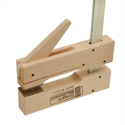

The clamps I use came from Stewmac but if you're on a tight budget you may have to go for a more conventional clamp.....throat size is the critical factor. Long reach Cam clamps would be the preferred alternative but again theyre usually not a common item in a hardware store.

If things are tight you can make your own cam clamps.....viewtopic.php?t=6812
