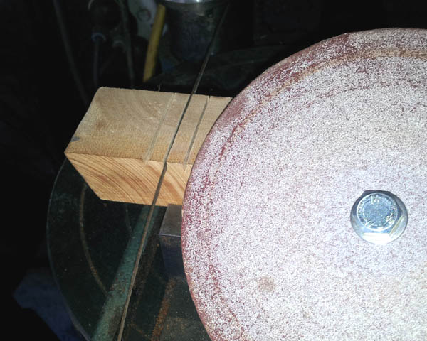

I used a better one of these I cant find at the moment so this is a band sawed piece of wood to depth you desire and a disc made of any hard stuff with sand paper stuck to it and a bolt using the pedestal drill with the wood clamped to it and wound it up till the disc was just in contact and gently thread the binding through .I have also used the drum type in the drill with a fence next to it and slowly pulled it through . :D John.

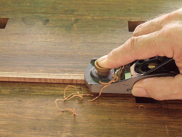

Stack 'em on edge, hold between finger and thumb of one hand, high angle block plane in the other. It's all I've ever done. No drama at all.

Well, sharp is certainly important, but what really helps doing this sort of thing is a bit of candle wax on the sole of the plane. It really cuts down the friction and makes holding the stack a lot easier, because you don't need a vise-like grip to keep it steady.
