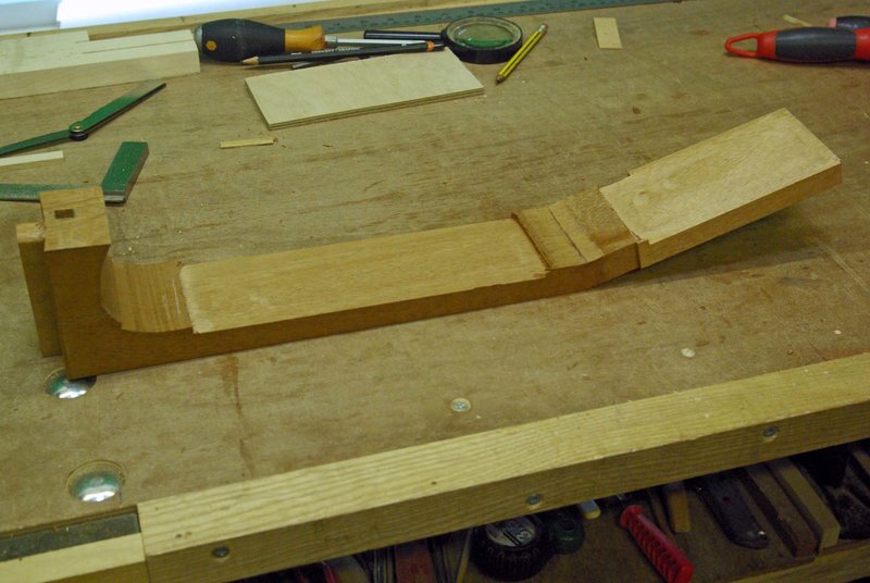

neck thickness/headstock thickeness
MattW
Posts: 70
Joined: Wed Apr 27, 2011 9:42 pm
Post by MattW » Sun Apr 02, 2017 6:42 pm
The head stock on most guitars is around 14-18mm thick, where the neck at the body join is around the 22mm or so, plus the fret board. So when making the neck, the stock would be ~22mm. How does everyone cut the scarf joint out of the one neck blank, then thickness the head stock back from the 22mm to around the 15mm for the head stock?
Matt

I cut the scarf joint and then plane down the shorter surface of the headstock to thickness. Once the scarf is glued up i plane the headstock area flat.

I do the scarf joint and then plane top of headstock to end thickness. I leave laying out heel block end of the neck until the headstock is dressed to final thickness. My necks get tapered once heel block is glued up using a Safe-T-Planer.

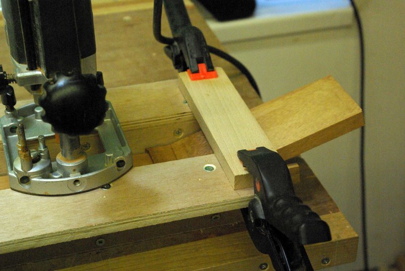

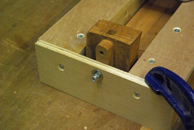

Not having a safety planer I set up a jig to do it with a router. As with G&G I thickness the underside of the neck and the head.
It is essentially a trough with the neck supported at the shallow angle required, with the router running on the top of the trough. The bolt bar in the heel is useful here as in many other operations for fixing the neck. I use wedges to keep the neck fixed against the walls of the box. I do the same thing for the headstock but I haven't shown any pics because the clamping system with wedges and so on is not so satisfactory and I wouldn't recommend the way I currently do it.
Hope the pics show the setup.

I like it Dave, necessity is the mother of invention, well done.
Cheers.
Rod

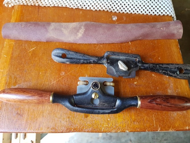

While we're showing off jigs. Here's my neck shaping 'jigs'.....
Repeatable, and precise neck shaping & tapering in ~10mins everytime. :gui :toi

Steve.T wrote:While we're showing off jigs. Here's my neck shaping 'jigs'.....
I often go "manual" but when you've got a truss rod channel (I use rods in my classicals) you sometimes want to go as close as possible to the bottom of the channel but without breaking through into same. The jig and Safe-T-Planer for is a safer way of thicknessing a truss rodded neck.
Re: neck thickness/headstock thickeness
Post by simso » Mon Apr 03, 2017 6:51 pm
Looks like a veritas spoke shave
Many ways to ..... :)
How deep is your truss rod channel? The rods i use are 8mm (i think by memory) to go scary close to that id have to have a ~15mm thick neck inc fretboard eg incredibly thin.
My classicals are 21.5mm at their thinnest - 1st fret (leaving some ~7 - 8mm of meat left before my truss rod channel), and 24mm at the 9th fret.
I can comfortably go to 22 and 24.5 with the spoke shave just by look and feel nowadays. The rest comes off with a quick blade reset on the shave and abrasives.
simso wrote:Looks like a veritas spoke shave
Correct. Funnily enough i bought that guy on a whim. Cost me $160.
The smaller stanley one pictured cost me $18 on ebay 2nd hand.
And guess which one i reach for first and use 95% of the time. Hint: its not the expensive one. :oops:
However, the veritas does have a very nice blade.
