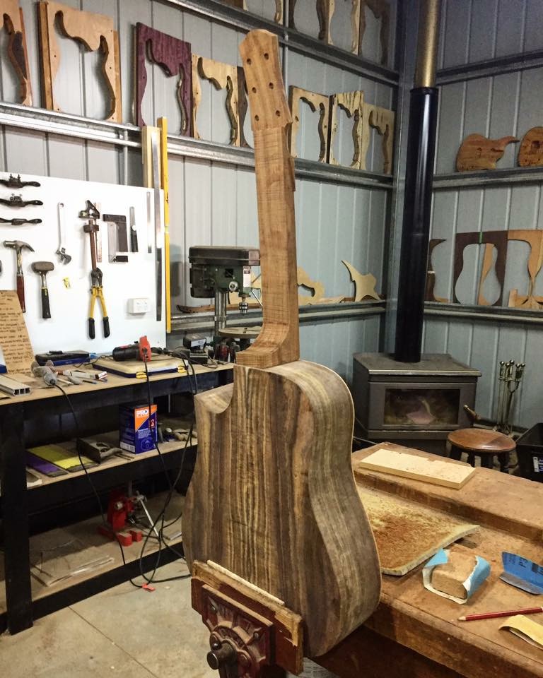

I've used it on a uke (posting.php?mode=reply&f=1&t=8173 ) with a cutaway, I never really had any issues with it, I also have a guitar set here which i'll be using on a SS when I get a chance.

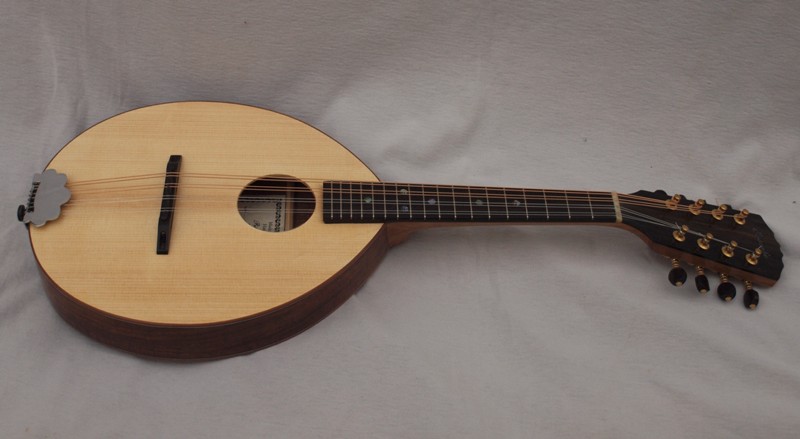

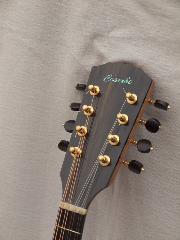

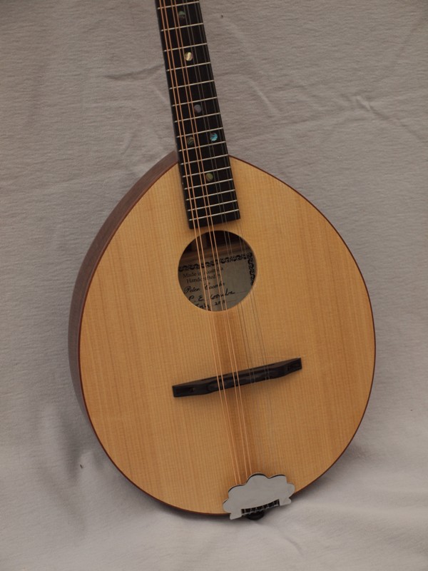

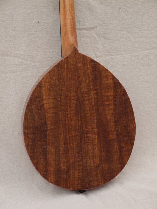

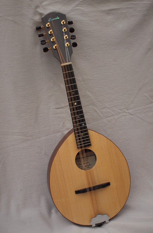

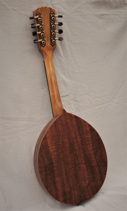

Post by peter.coombe » Fri Aug 03, 2018 8:30 pm
Finally some pictures of the mandolin.
Posts: 120
Re: Gidgee
Post by Jim » Fri Aug 03, 2018 10:18 pm
King Billy Pine top Peter?
peter.coombe
Posts: 745
Location: Bega, NSW
Re: Gidgee
Post by peter.coombe » Sat Aug 04, 2018 8:27 am
No it is a Red Spruce top.

Post by Mark McLean » Sat Aug 04, 2018 8:46 am
It does look great! And you are really pleased with how it sounds - so an all round winner. We will look with interest at whether you jump into doing another one, given the difficulties.

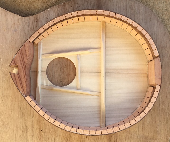

Better late than never to ask, What did you use for kerfing material on this lil beauty please Peter?
Gaz
peter.coombe
Posts: 745
Location: Bega, NSW
Re: Gidgee
Post by peter.coombe » Sun Aug 26, 2018 4:43 pm
King Billy Pine.
