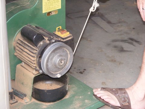

This motor on my dust extractor stopped starting on its own a year or so back, start windings I suspect [the switch inside appears ok] so I fitted this pully, start it like my lawn mower, and then push the start button. Cheeper that a new motor or rewind.

Taffy that's a cool solution, but how did you figure out that it was the start windings and not the motor itself?

Hi Lillian, when I pushed the red start button the motor just sat there humming, or turned so slow that it eventualy cut out on the protective overload switch. The mechanical switch in the motor that makes contact with the 'run' windings when the 'start' windings get the motor up the required speed was working ok, so I suspected the start windings. A layman account.

Sounds like the capacitor went bad. Yours is a cool solution, no doubt. And its pretty much kid proof too.

Taff,, Do you wear the same Chinese work boots when you start your lawn mower?

Post by Taffy Evans » Tue Feb 08, 2011 4:38 pm
Rocket, safety gaurds removed the for clarity.
Re: Repairing Workshop Tools/ Machines?
Post by rocket » Tue Feb 08, 2011 4:50 pm
Yep!
